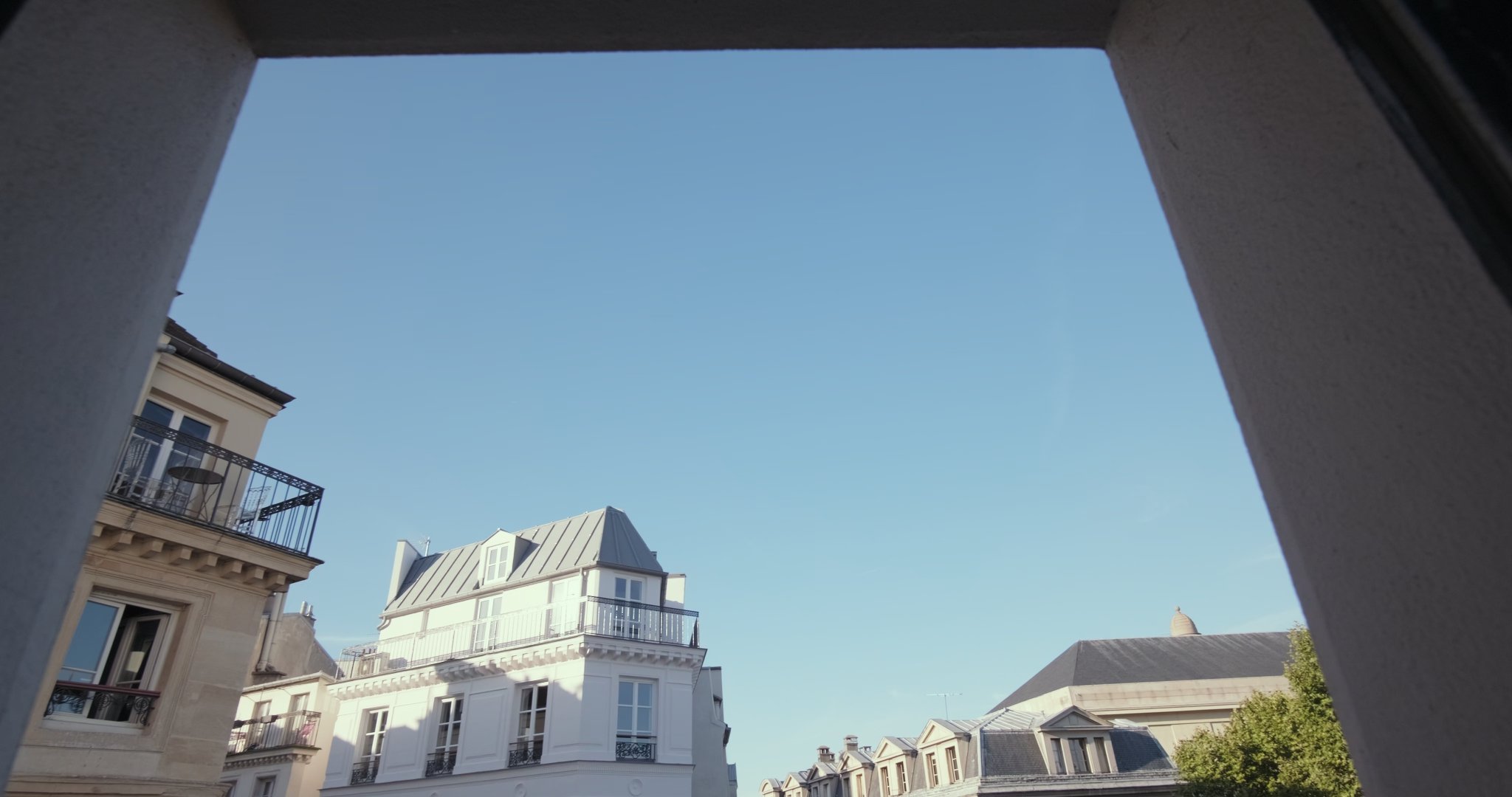

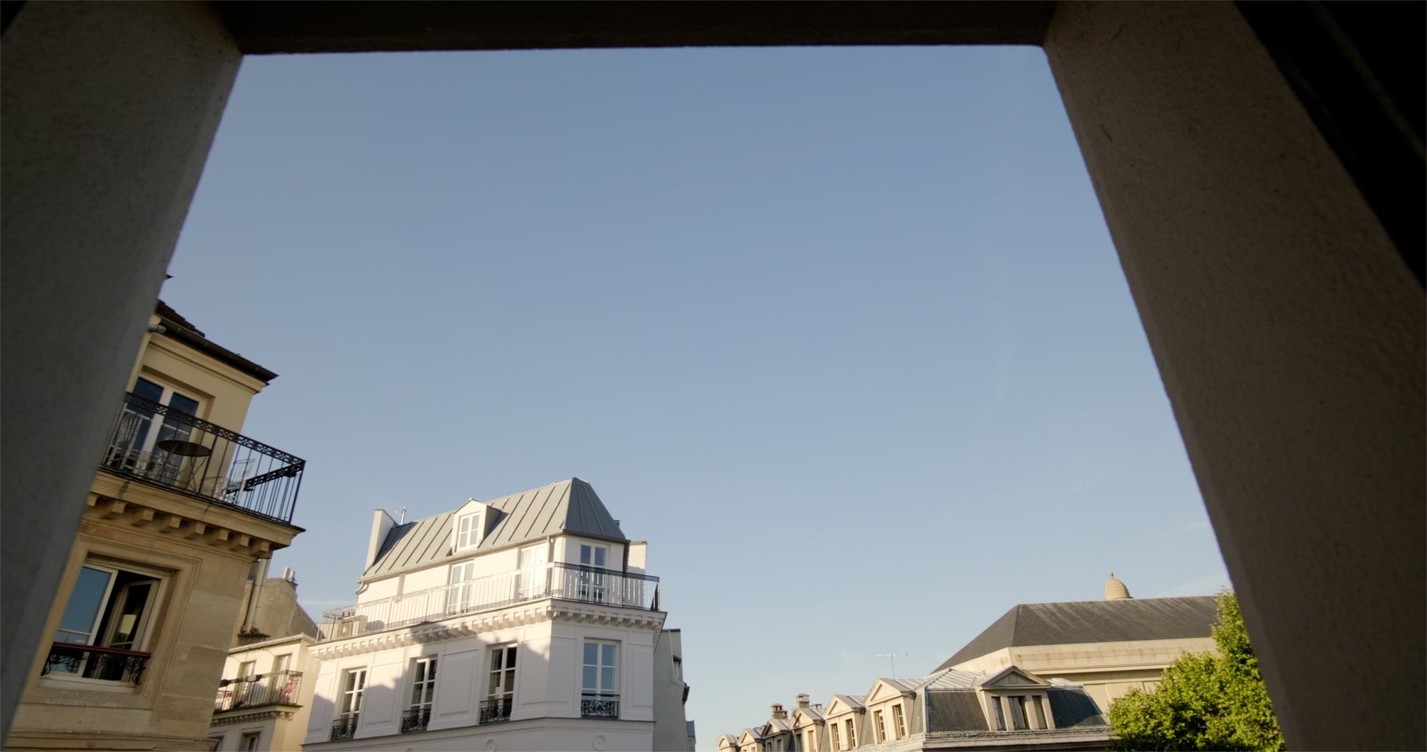

BrunoCH Posted September 3, 2019 Share Posted September 3, 2019 Just a little test. The same file; F-log. The same basic treatment : Delog + Auto WB. Resolve RCM vs Resolve LUT vs FCPX LUT jpg RCM : input color F-log + OFX tone mapping simple + curve to match LUT waveform. jpg LUT : LUT Fuji WDR 709 jpg RCM WB : same thing + auto WB with picker on the white wall. jpg LUT WB : same thing + auto WB with picker on the same wall. jpg LUT FCPX : LUT Fuji WDR 709 jpg LUT FCPX WB : same thing + auto WB with picker on the same white wall. What do you think? https://drive.google.com/file/d/1dwqr-sQ49vYlUVckkwZdQbpxizCSXk3R/view?usp=sharing https://drive.google.com/drive/folders/1qJfwDUP64cxELYPyz44FoXW10GXsiM0y?usp=sharing Link to comment Share on other sites More sharing options...
thephoenix Posted September 3, 2019 Share Posted September 3, 2019 i prefer the 1st one Link to comment Share on other sites More sharing options...

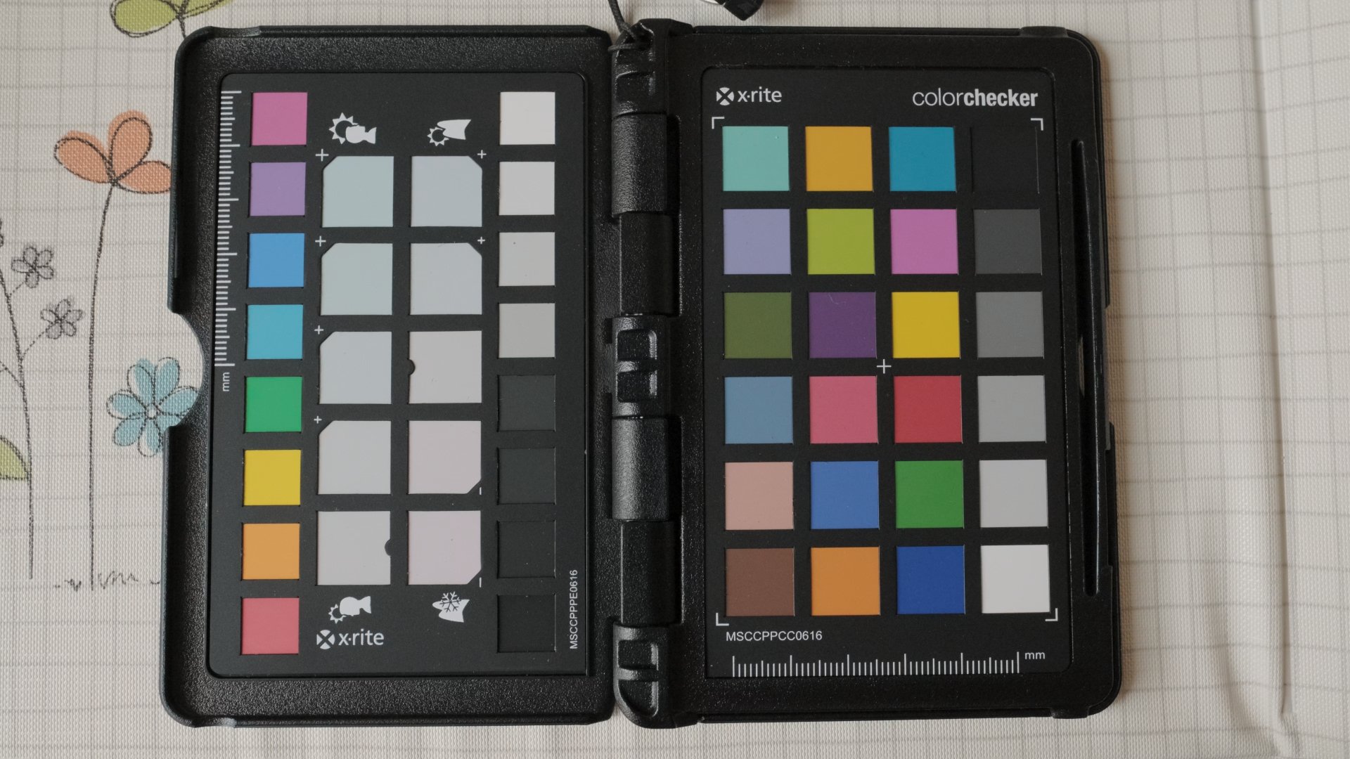

Attila Bakos Posted September 3, 2019 Share Posted September 3, 2019 I'm not sure about this yet, but RCM seems to have some kind of color toning. When I try Davinci YRGB + WDR LUT I get colors pretty close to what I get with my F-Log ACES profile. They both convert gamma and colorspace only, there is no special color treatment. But when I check the same clips in RCM they seem to be overall warmer, the greens are more yellowish, the blues are more cyanish, like a filmic LUT already applied In some situations it will be more pleasant to the eye but I wonder why it's happening. Part of this must be caused by the bad interpretation of the files, especially the yellowish greens, but this alone can't be the cause of such a big difference. Will continue testing. Link to comment Share on other sites More sharing options...

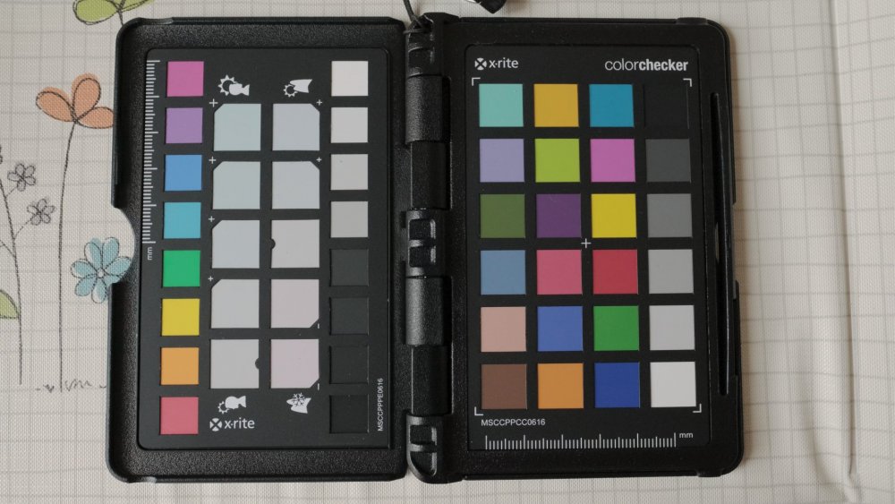

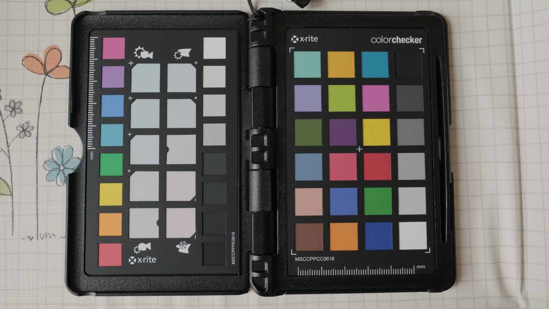

Attila Bakos Posted September 3, 2019 Share Posted September 3, 2019 I tried to match the gamma & overall saturation here to see the color differences. Everything is done in the latest beta of Resolve. 1. WDR LUT 2. My ACES F-Log IDT 3. RCM 4. RCM with fixed YCbCr->RGB conversion. WDR and ACES are pretty similar, the WDR has more saturated reds. RCM is different in many patches, however if the input file is interpreted correctly it looks pretty close to the other two. So in terms of color the differences are minor, once RCM is fixed. I believe the most difference will be caused by WB adjustments. Link to comment Share on other sites More sharing options...

BrunoCH Posted September 3, 2019 Share Posted September 3, 2019 @thephoenix Yes the first one is nice. That’s Fuji LUT WDR + Auto WB in FCPX. For HLG, I can’t help you. I don’t use it. Perhaps it’s time to go back to F-log @Attila Bakos I like your contributions. They’re very instructive. But honestly, I don’t see any difference between your pictures ( or not significant). My thoughts are if I need to work quickly, I can use Fuji LUT in Fcpx because it’s my NLE. It’s possible to make a very nice color grade. But if I have time, I prefer to use the Resolve RCM. Skin tone, blue sky, green vegetation, and others colors are like I want. And very easy to work with. Link to comment Share on other sites More sharing options...

Attila Bakos Posted September 4, 2019 Share Posted September 4, 2019 8 hours ago, BrunoCH said: @Attila Bakos I like your contributions. They’re very instructive. But honestly, I don’t see any difference between your pictures ( or not significant). That's kinda the point here, that once the interpretation issue is fixed in RCM there will be almost no difference. Right now RCM is different from the others but yeah, you have to open the files in separate tabs and click back and forth to see the difference. A real world scenario might be more telling. BrunoCH 1 Link to comment Share on other sites More sharing options...
