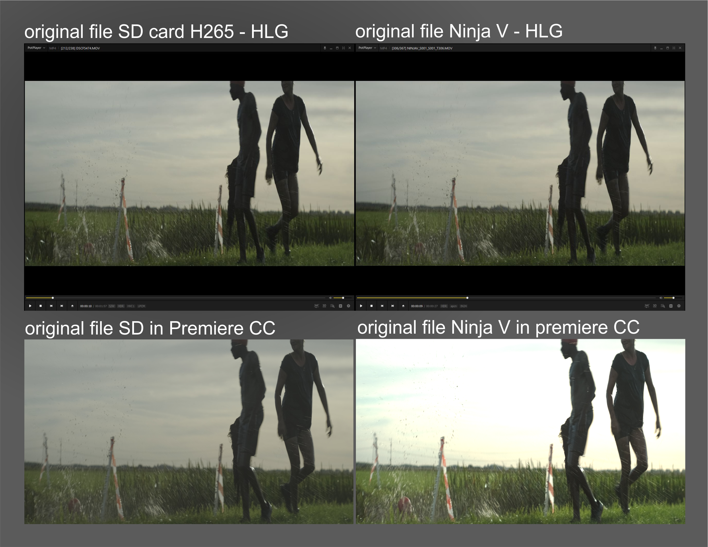

keessie65 Posted September 19, 2019 Share Posted September 19, 2019 First time I see this. hopefully here others are also using X-T3 and Ninja V and can tell me what I am doing wrong! Filmed with my Fuji X-T3 a ditch and prutrace last weekend, files in HLG on both SD card and Ninja V SSD. Viewing with potplayer, same quality. But... puttig it on timeline in Adobe without any grading, the Ninja file gets overexposed. Is this normal? Or is this an Atomos issue? Settings? I also don't understand there is no firmware upgrade for Ninja V. Any advise? Link to comment Share on other sites More sharing options...
thephoenix Posted September 19, 2019 Share Posted September 19, 2019 checked hdr ? Link to comment Share on other sites More sharing options...
androidlad Posted September 19, 2019 Share Posted September 19, 2019 It's been discussed a few times before. The HLG flag in ProRes file automatically triggers Premiere Pro CC to apply an HDR to SDR conversion. Link to comment Share on other sites More sharing options...
keessie65 Posted September 19, 2019 Share Posted September 19, 2019 9 hours ago, androidlad said: It's been discussed a few times before. The HLG flag in ProRes file automatically triggers Premiere Pro CC to apply an HDR to SDR conversion. If I google, than I find more about this. also here at this forum. Never had problems before ... I think. Solution is not there at this moment as far as I 'google'. Unfortunatelly. Link to comment Share on other sites More sharing options...
androidlad Posted September 19, 2019 Share Posted September 19, 2019 2 minutes ago, keessie65 said: If I google, than I find more about this. also here at this forum. Never had problems before ... I think. Solution is not there at this moment as far as I 'google'. Unfortunatelly. Solution is to dump Premiere CC. Link to comment Share on other sites More sharing options...
Attila Bakos Posted September 19, 2019 Share Posted September 19, 2019 33 minutes ago, androidlad said: Solution is to dump Premiere CC. This one really works! Link to comment Share on other sites More sharing options...
keessie65 Posted September 19, 2019 Share Posted September 19, 2019 25 minutes ago, Attila Bakos said: This one really works! the alternative, Davinci Resolve? Is there a trial version to download? Link to comment Share on other sites More sharing options...
Attila Bakos Posted September 19, 2019 Share Posted September 19, 2019 8 minutes ago, keessie65 said: the alternative, Davinci Resolve? Is there a trial version to download? Resolve is free unless you need the features of the Studio version. Link to comment Share on other sites More sharing options...
