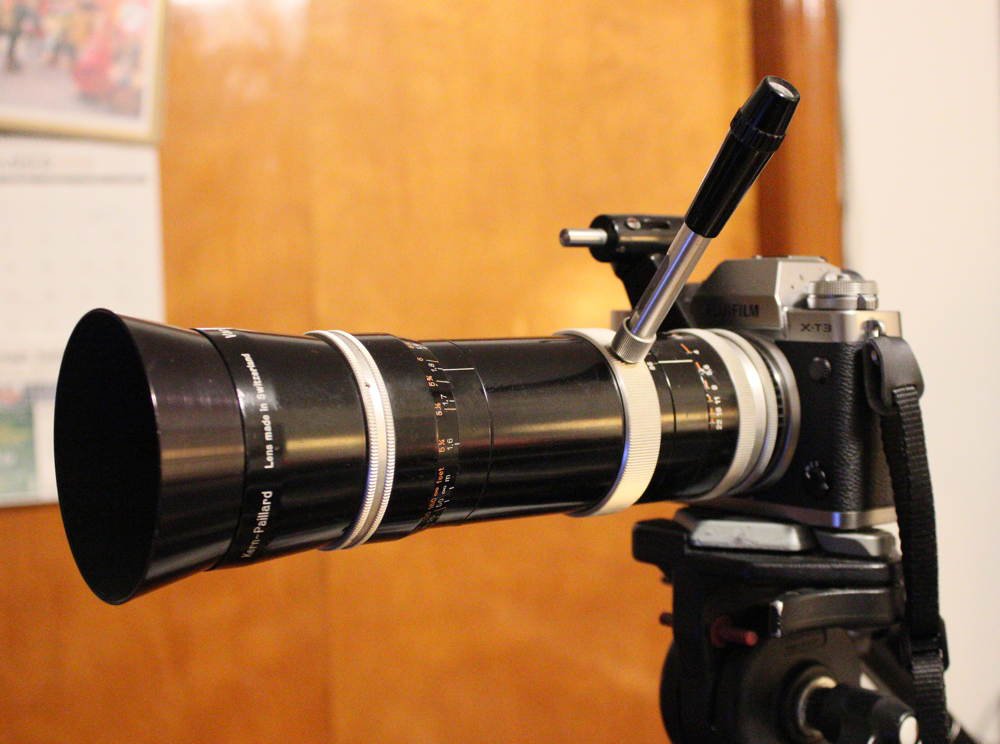

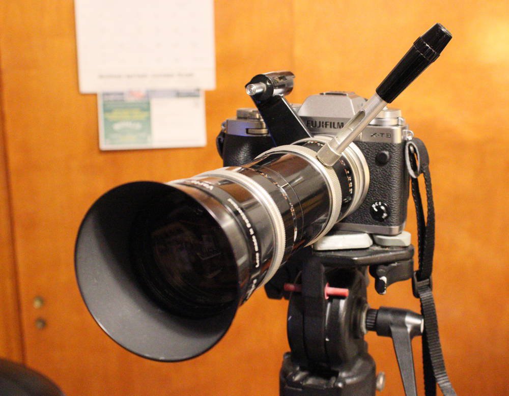

Jay60p Posted February 4, 2020 Share Posted February 4, 2020 I have used the 1.18 crop to advantage with a C mount adapter, for 2K. Using a Vario-Switar zoom 18-86 f2.5 from a Bolex 16mm camera, you can shoot 4K60p and edit in a 1080 60p timeline in Final Cut Pro well within the image circle (set "Spacial Conform" to NONE). I usually reduce the scale to about 0.84 before is see vignetting, to get the widest view. This is a H16 RX lens, but I find no focus problems from the RX adjustment for the Bolex viewfinder prism. Its very sharp at mid apertures throughout the nearly 5:1 zoom range. The version of this lens I have is one of the early ones without the electric eye & automatic aperture so it has a smaller projection coming off the side with the Bolex trigger, so it is not a problem mounting this on the X-T3. Juank, BrunoCH and heart0less 3 Link to comment Share on other sites More sharing options...
Jay60p Posted February 5, 2020 Share Posted February 5, 2020 Vario Switar continued: And now for the limitations to this setup... 1) The 18mm wide view is about equivalent to a 30mm APS-C lens, or about 55mm FF 35mm equivalent, since this 18mm is not covering the entire sensor. So it's more like a "normal to telephoto" zoom. 2) Closest focus is about 5 feet. 3) The live view in the finder shows the image circle surrounded by black and is hard to judge the true edges of the (to be) cropped 1080 frame. You'd probably want to mask off the cropped image on the LCD with tape. 5) I don't actually use it mounted as in the pictures above. I put the camera on an aluminum plate that sets the camera farther back, and has an adjustable lens supporting screw that comes up under & just before the zoom ring that makes the setup much more stable and balanced. I mainly made that plate for supporting long Canon FD zoom lenses. The advantages of this setup (for 2K) over still camera zoom lenses is the constant aperture throughout the zoom, the lack of exposure stepping and focus shifting because the lens is not electronically focused & zoomed "by wire", and the nearly 5:1 zoom ratio (X-T3 kit lens is 3:1) . And for me it was a free left-over from my Bolex days. It's so cool to be able to use that lens again. heart0less 1 Link to comment Share on other sites More sharing options...
