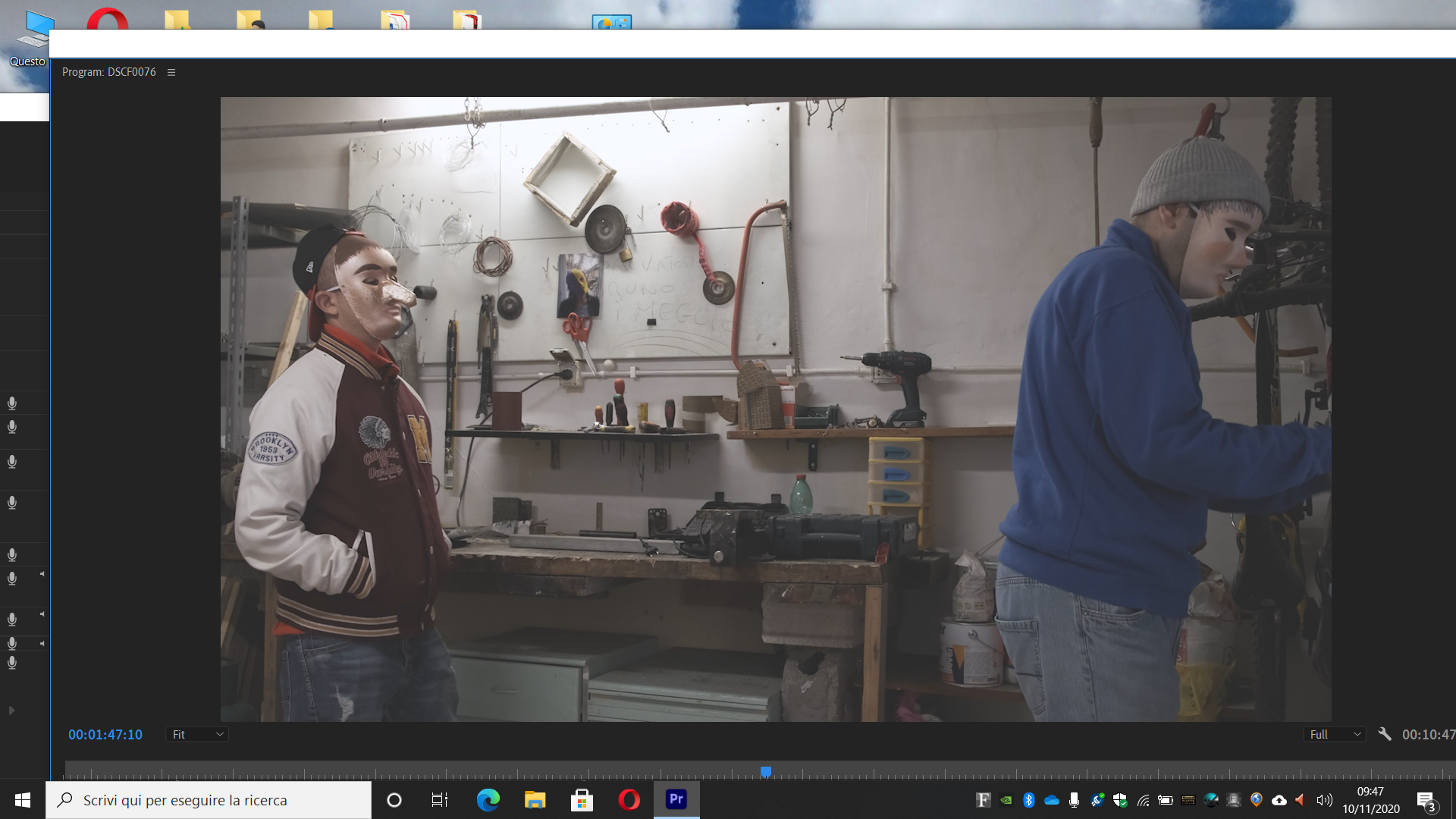

stefanocps Posted November 10, 2020 Share Posted November 10, 2020 hello need some suggestion with grading. My xt3 does beautiful images, but at times grading is needed absolutely to make the footage looking like "films". It is a pity to have such a beautiful camera and have sometimes result that is so far from any kind of cinema look; it looks too real. If i see it on my pc is still not so bad, but on my tv no .... I attach a frame and i ask you what would you do. I have done some work on contrast and saturation Please give me some hint..i will study cc soon because i find it so important... thank you Quote Link to comment Share on other sites More sharing options...
TomTheDP Posted November 10, 2020 Share Posted November 10, 2020 10 hours ago, stefanocps said: hello need some suggestion with grading. My xt3 does beautiful images, but at times grading is needed absolutely to make the footage looking like "films". It is a pity to have such a beautiful camera and have sometimes result that is so far from any kind of cinema look; it looks too real. If i see it on my pc is still not so bad, but on my tv no .... I attach a frame and i ask you what would you do. I have done some work on contrast and saturation Please give me some hint..i will study cc soon because i find it so important... Lens choice, lighting, and location are the key for getting a "movie" look. In terms of color I'd highly recommend the GHA lut. Can't beat the Alexa for color. May not be your final look of course but its a good starting point. But again if you have a crappy location with crappy lighting your movie probably won't look much like a "movie" Quote Link to comment Share on other sites More sharing options...
stefanocps Posted November 11, 2020 Share Posted November 11, 2020 13 hours ago, TomTheDP said: Lens choice, lighting, and location are the key for getting a "movie" look. In terms of color I'd highly recommend the GHA lut. Can't beat the Alexa for color. May not be your final look of course but its a good starting point. But again if you have a crappy location with crappy lighting your movie probably won't look much like a "movie" yes that is for sure, about lighting and location. But, for instance, what about outdoor? with natural light i can still see a big difference. Not as big as indoor of course. I don t' really look for a "movie look" but at least not to look "too real", you know what i mean. Lens yes, that can make difference, may be using some vintage ones, not having cine lens can help? Where do i find the GHA lut?do i need to shoot in flog for better using it? Quote Link to comment Share on other sites More sharing options...

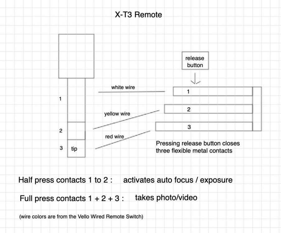

manschgerl Posted December 9, 2020 Share Posted December 9, 2020 On 10/21/2018 at 7:12 AM, Topcat said: Hi all - Just made my first video ever. Used the newly acquired X-T3. Also used the new Feiyu AK2000 and my first time using any gimbal. I was later able to use a 2.5mm to 3.5mm cable to start/stop recording from the gimbal and also acquire focus though I wasn't able to use it for this video. Got the X-T3 because I wanted to have our wedding video be in 4K HDR and this seemed to be the only economical way to do it. I also have some graded HDR test clips shot from the X-T3 but I cannot find it right now. Unfortunately Resolve doesn't seem to do HEVC export or 10 bit H.264 so this is exported and uploaded as 8 bit. Hi Topcat, do you still have the 2.5mm to 3.5mm cable? Is it a self-made cable 2,5 mm stereo to 3,5 mm stereo? Do you remember the pin assignment? Or can you measure it? Thank you for your help. Quote Link to comment Share on other sites More sharing options...
Jay60p Posted December 10, 2020 Share Posted December 10, 2020 On 12/9/2020 at 8:41 AM, manschgerl said: Hi Topcat, do you still have the 2.5mm to 3.5mm cable? Is it a self-made cable 2,5 mm stereo to 3,5 mm stereo? Do you remember the pin assignment? Or can you measure it? Thank you for your help. Here is a diagram I worked out for the X-T3: This is what I found inside my Vello remote for X-T3. I attached external wiring to 2 & 3 for remotely firing off frames when digitizing my Arri II 35mm timelapse footage, a frame at a time run by a geared down motor. The X-T3 results are excellent. My major project at the moment. BrunoCH 1 Quote Link to comment Share on other sites More sharing options...
