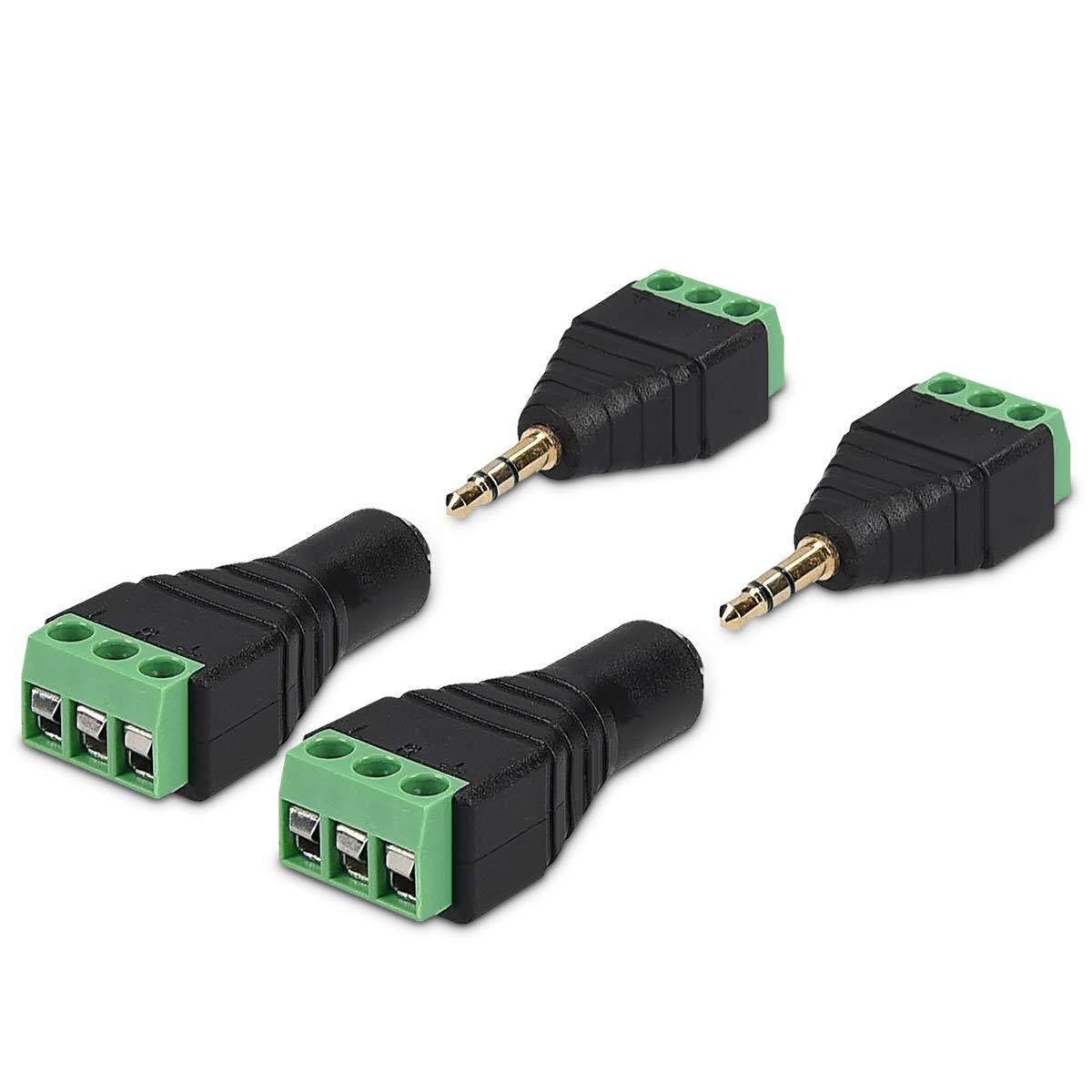

thephoenix Posted February 18, 2019 Share Posted February 18, 2019 1 minute ago, BrunoCH said: Good luck !!! I think a better solution would be to ask Fuji and Tilta what are connexions in their remote cable and to make a custom. By the time i will get answer i think i will have a new camera Weird i can only find 4 poles 3.5 to 2.5 adapters that are small. No 3 poles I could do one yes but i am afraid the welding will not last in time Wiring i can find on the web Link to comment Share on other sites More sharing options...
Super Members BTM_Pix Posted February 18, 2019 Super Members Share Posted February 18, 2019 9 minutes ago, thephoenix said: By the time i will get answer i think i will have a new camera Weird i can only find 4 poles 3.5 to 2.5 adapters that are small. No 3 poles I could do one yes but i am afraid the welding will not last in time Wiring i can find on the web If you have to do something custom and are concerned about doing the soldering (especially when trying to work out the connections) then these solderless terminal connectors are useful You would then buy a 4 pole to 4 pole 2.5mm cable, cut the cable in half, strip the wires and put them into the terminals to make the connections. https://www.amazon.co.uk/kwmobile-2-5mm-Balun-Converter-Adapter-Black/dp/B07NDGYSGB/ref=sr_1_3?ie=UTF8&qid=1550527647&sr=8-3&keywords=2.5mm+balun+converter As you get two terminal adapters in the pack and you've cut your 4 pole cable in half you will then be able to make up 2 of the correct cables. Once you've established what the connections are then you can have someone make up something more permanent. Or just gaffa tape the hell out of the lashed up ones BrunoCH and thephoenix 1 1 Link to comment Share on other sites More sharing options...

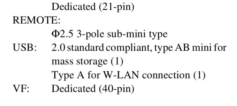

BrunoCH Posted February 18, 2019 Share Posted February 18, 2019 23 minutes ago, thephoenix said: By the time i will get answer i think i will have a new camera Weird i can only find 4 poles 3.5 to 2.5 adapters that are small. No 3 poles I could do one yes but i am afraid the welding will not last in time Wiring i can find on the web The cable LANC1 on the tilta site should work (for sony FS5 and FS7) https://tilta.com/shop/nucleus-nano-run-stop-cables/ See the screen capture on the documentation on FS7 : 3poles same as XT3 thephoenix 1 Link to comment Share on other sites More sharing options...
androidlad Posted February 18, 2019 Share Posted February 18, 2019 Fuji 2.5mm remote release pin out- Link to comment Share on other sites More sharing options...

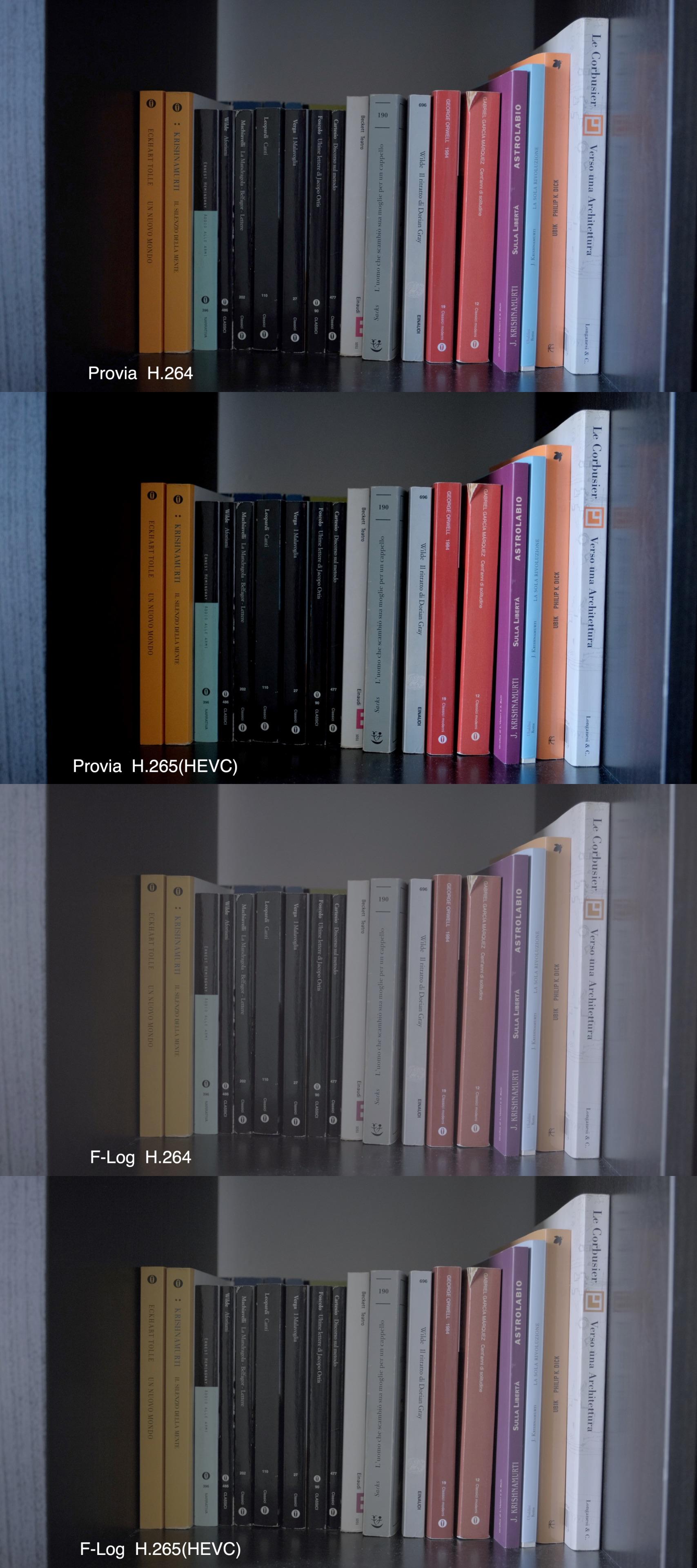

ErisC Posted February 20, 2019 Share Posted February 20, 2019 Hi all, do you know why the h.265(HEVC) is darker than h.264 on the X-T3? In the Display / Viewfinder of the camera are the same, but on the monitor of my Mac I see the h.265 darker, more contrasted than h.264 Link to comment Share on other sites More sharing options...
