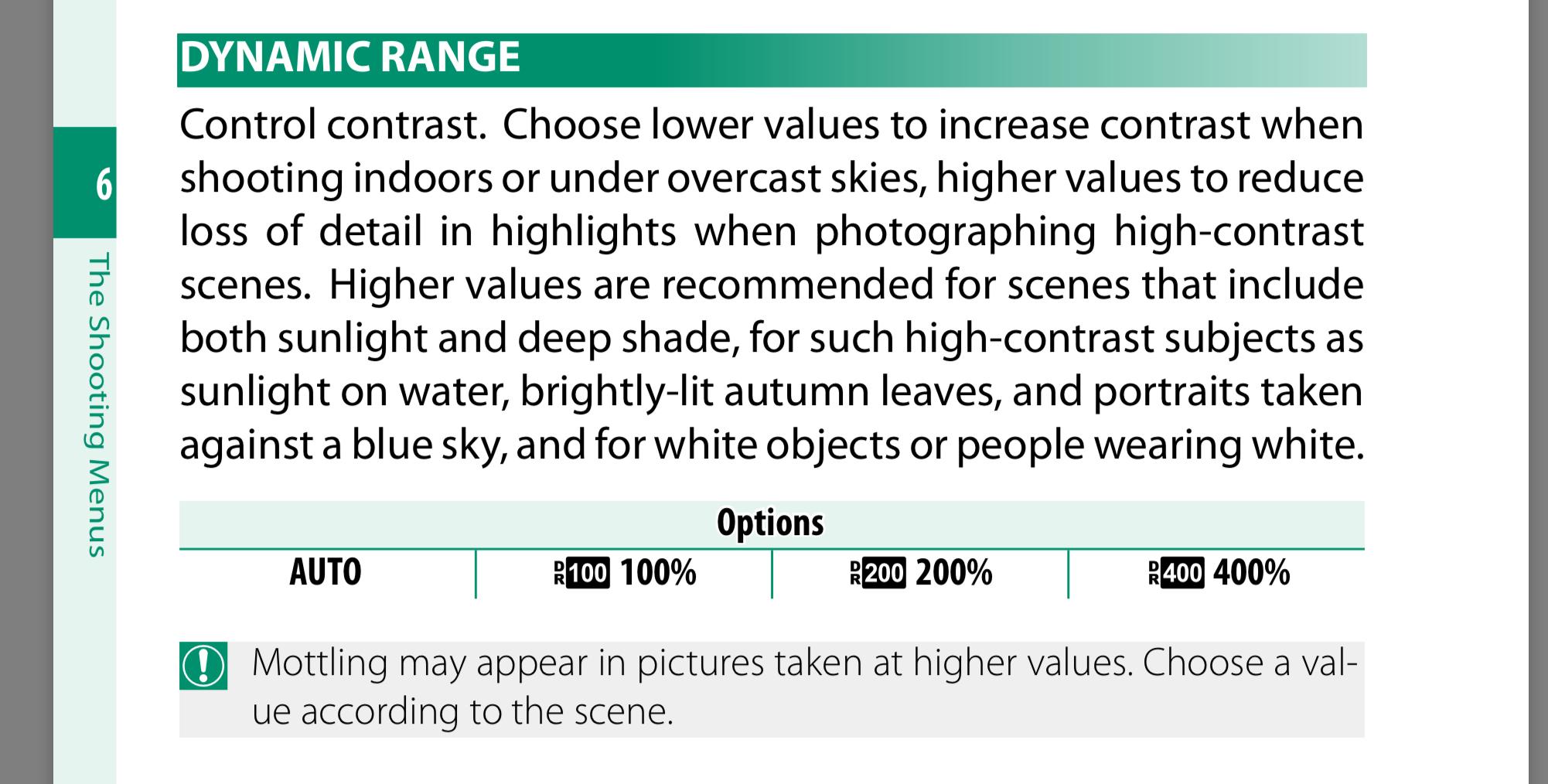

BrunoCH Posted April 27, 2019 Share Posted April 27, 2019 26 minutes ago, androidlad said: It's not like that. DR100 film simulations let you use base ISO160, this is the native ISO with a video gamma that limits dynamic range, but ProNeg Std is the flattest of all film simulations. DR400 film simulations start at ISO640 and behave similarly to F-log, which actually expose at ISO160 and push shadow 2 stops. DR400 film simulations have similar DR with F-log (minor difference in roll-off), especially with highlights/shadow set to -2. We do not have the same interpretation of fuji parameters. I still need to do some tests. But the parameters DR100, 200, 400 would be three simplified values of the knee correction fonction (you can not choose the knee point and the knee slope) on video camera and only concerns highlights. Eterna is the flattest simulation film. 640 is the native ISO. That's just what I believe. Anyway Fuji does not give info. Link to comment Share on other sites More sharing options...
webrunner5 Posted April 27, 2019 Share Posted April 27, 2019 Good definition of Knee, Point, and Slope by Tom Roper.. "Raise your hand above your head. The height of your shoulder above the floor is the Knee Sat Level. The height of your elbow above the floor is the Point. The amount of bend at your elbow is the Slope". Knee adjustment really only helps much in very bright situations. When I was doing my ENG thing that was one of the few adjustments we were allowed to adjust in the field. And it was only used if you were forced to shoot into the sun, or really bright lights. And even then nothing too drastic on the curve part. You are not going to gain much DR at the top no matter what you do, but it does tend to look ugly blown out, even to an untrained eye more so than say crushed Blacks. Video is more about compromises than anything else. Hardy any perfect scene to shoot unless you are on a Hollywood studio set where they have all of it covered. That to me is why I am not too big of fan of Run n Gun though a lot of the short, or a lot of quick cuts. Unless the story is just so amazing you can't look away, you can't maintain smooth transitions very easy exposure wise. And you can't recover something in Post that was never there. buggz and BrunoCH 1 1 Link to comment Share on other sites More sharing options...
BrunoCH Posted April 27, 2019 Share Posted April 27, 2019 @webrunner5 thanks for these explanations. It seems like DR400 is a soft knee DR100 a hard knee and DR200, between both. I don’t know if it's true, but seems like with the quick tests I did. I have to do other tests. Link to comment Share on other sites More sharing options...
androidlad Posted April 27, 2019 Share Posted April 27, 2019 1 minute ago, BrunoCH said: @webrunner5 thanks for these explanations. It seems like DR400 is a soft knee DR100 a hard knee and DR200, between both. I don’t know if it's true, but seems like with the quick tests I did. I have to do other tests. DR400 is a 2 stop push from ISO160, that's why it starts with ISO640. DR200 1 stop push from ISO160. Link to comment Share on other sites More sharing options...
BrunoCH Posted April 27, 2019 Share Posted April 27, 2019 1 hour ago, androidlad said: DR400 is a 2 stop push from ISO160, that's why it starts with ISO640. DR200 1 stop push from ISO160. So it’s just a exposure compensation ? If it's a knee adjustment, I understand fuji's explanations better. ( and the ! About mottling) Link to comment Share on other sites More sharing options...

frontfocus Posted April 28, 2019 Share Posted April 28, 2019 androidlad already explained it: it's exposed at ISO160 (or higher ISO) for the highlights and shadows and midtones are pushed. And this is reflected with a higher ISO value. It's actually one of the easier, very reproducible dynamic range extension functions. Link to comment Share on other sites More sharing options...
