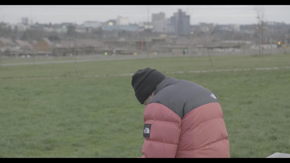

thephoenix Posted May 23, 2019 Share Posted May 23, 2019 3 hours ago, Attila Bakos said: Right click the clips in the media pool, choose clip attributes, then select full at data levels. well... since i have the free version h265 will not open in resolve can convert to dnxhr using shutter encoder but will it change something ? edit: converted to dnxhr. on the image, left is ninja, right is fuji h265 converted to dnxhr Link to comment Share on other sites More sharing options...
Attila Bakos Posted May 23, 2019 Share Posted May 23, 2019 Just now, thephoenix said: well... since i have the free version h265 will not open in resolve can convert to dnxhr using shutter encoder but will it change something ? Don't bother with converting, we need to see how Resolve handles the original files. Maybe someone else can help us out. Link to comment Share on other sites More sharing options...
thephoenix Posted May 23, 2019 Share Posted May 23, 2019 ok. can you tell me more about full data level and why is it not set to full by default ? just discovered that it was set to auto and when setting to full then image changes and seems to be flatter than without (flog) Link to comment Share on other sites More sharing options...

Attila Bakos Posted May 23, 2019 Share Posted May 23, 2019 20 minutes ago, thephoenix said: ok. can you tell me more about full data level and why is it not set to full by default ? just discovered that it was set to auto and when setting to full then image changes and seems to be flatter than without (flog) ProRes is always interpreted as video range, even if it's a full range recording. I'm not even sure ProRes has flags for setting the data levels at all. When you set it manually to full range it becomes flatter, that's normal. thephoenix 1 Link to comment Share on other sites More sharing options...
thephoenix Posted May 23, 2019 Share Posted May 23, 2019 5 minutes ago, Attila Bakos said: ProRes is always interpreted as video range, even if it's a full range recording. I'm not even sure ProRes has flags for setting the data levels at all. When you set it manually to full range it becomes flatter, that's normal. but i am using dnxhr ? seems to be the same here Link to comment Share on other sites More sharing options...
BrunoCH Posted May 23, 2019 Share Posted May 23, 2019 1 hour ago, thephoenix said: ok. can you tell me more about full data level and why is it not set to full by default ? just discovered that it was set to auto and when setting to full then image changes and seems to be flatter than without (flog) Full data is about still photo, like jpg dpx etc (image sequence); RGB file. Video level is about video file like prores dnx etc; YCbCr file. With auto, resolve make choice between both. thephoenix 1 Link to comment Share on other sites More sharing options...
Attila Bakos Posted May 23, 2019 Share Posted May 23, 2019 39 minutes ago, BrunoCH said: Full data is about still photo, like jpg dpx etc (image sequence); RGB file. This is a bit oversimplified, a lot of cameras use the full range in their video files. Fuji is one of them. thephoenix 1 Link to comment Share on other sites More sharing options...
BrunoCH Posted May 23, 2019 Share Posted May 23, 2019 7 minutes ago, Attila Bakos said: This is a bit oversimplified, a lot of cameras use the full range in their video files. Fuji is one of them. I think fuji log use full range into the limit of video range (Panasonic log don't use full range into video range) Link to comment Share on other sites More sharing options...
Attila Bakos Posted May 23, 2019 Share Posted May 23, 2019 2 minutes ago, BrunoCH said: I think fuji log use full range into the limit of video range (Panasonic log don't use full range into video range) Fuji log uses 95-1023, because of the gamma curve. That's still a wider range than video range (64-940). Link to comment Share on other sites More sharing options...
androidlad Posted May 23, 2019 Share Posted May 23, 2019 7 minutes ago, Attila Bakos said: Fuji log uses 95-1023, because of the gamma curve. That's still a wider range than video range (64-940). Strictly speaking it's full range 0-1023. But Fuji encodes nothing between 0-95. Link to comment Share on other sites More sharing options...

thephoenix Posted May 23, 2019 Share Posted May 23, 2019 4 hours ago, Attila Bakos said: Don't bother with converting, we need to see how Resolve handles the original files. Maybe someone else can help us out. you clearly see a difference on my pic anyway. so looks like problem it not solved. one question. problem is with fuji flog internal files. it means ninja files are not affected right ? to correct it do we have to apply the fuji lut flog to rec709 ? or do we have to always apply this lut to files coming from the fuji and also the ninja ? because when you mix sources it is a bit a tricky to apply the lut only to some rushes. or maybe you can convert fuji internal files to prores or dnxhd applying the lut ? (shutter encoder can do that) Link to comment Share on other sites More sharing options...

Attila Bakos Posted May 23, 2019 Share Posted May 23, 2019 28 minutes ago, thephoenix said: you clearly see a difference on my pic anyway. so looks like problem it not solved. one question. problem is with fuji flog internal files. it means ninja files are not affected right ? to correct it do we have to apply the fuji lut flog to rec709 ? or do we have to always apply this lut to files coming from the fuji and also the ninja ? because when you mix sources it is a bit a tricky to apply the lut only to some rushes. or maybe you can convert fuji internal files to prores or dnxhd applying the lut ? (shutter encoder can do that) Unfortunately I don't have time to go into the details right now, but I recommend you watch the video in the thread I linked earlier (previous page), it has the answers to most of your questions. 34 minutes ago, keessie65 said: Thanks Attila, I used F-Log for this one and graded with Venice Cine lut; https://www.sierracreativeco.com. The oval at 2:10 is from the lens, colours from the lut. I like the oval, but the color transitions are a bit harsh around the sun. Nothing serious though, nice colors overall. thephoenix 1 Link to comment Share on other sites More sharing options...
Anaconda_ Posted May 23, 2019 Share Posted May 23, 2019 Here's a screen grab of the images in Resolve, the left screen is the XT3 file and the right is from the Ninja. I set them both to 300 and lined them up to form basically one image with a line in the middle. I thought that would be the easiest way to see if there's any difference in the colour. - both are set to Full in Clip Attributes. To my eyes, they're exactly the same, but if there is a difference, I wouldn't even think about it while shooting. One thing I did notice though, is the capture from the Atomos is 2 or 3 frames behind the file straight from the camera, nothing major, and I'm sure it's not camera / recorder specific, but worth noting. Edit: If people want, I could also post screen grabs from the colour page, showing the histogram, vector scope, curves etc. But they don't change at all between the clips. Safe to say they're exactly the same image from that perspective too... Attila Bakos, frontfocus and Stathman 1 2 Link to comment Share on other sites More sharing options...
