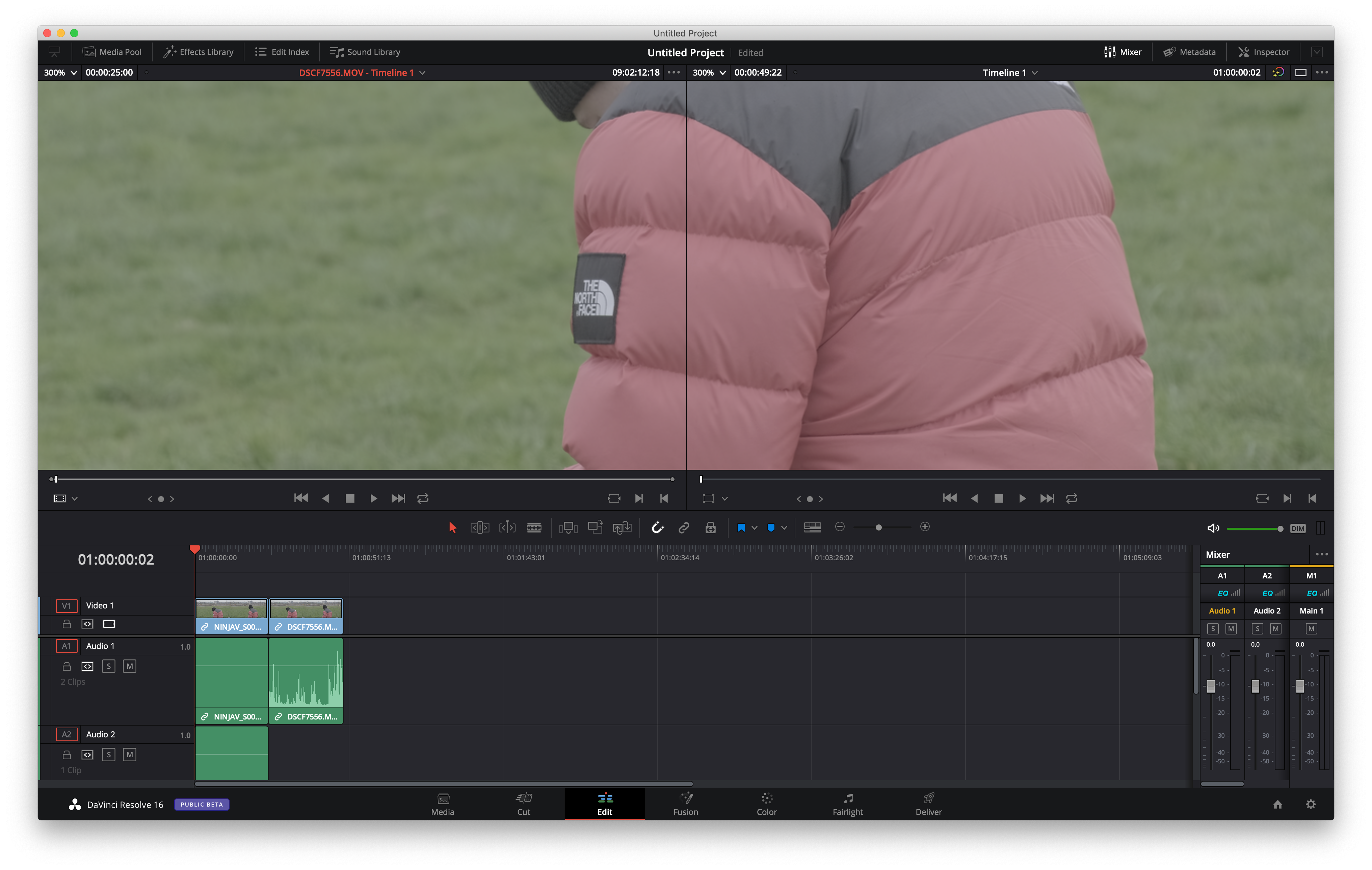

thephoenix Posted May 23, 2019 Share Posted May 23, 2019 39 minutes ago, Anaconda_ said: Here's a screen grab of the images in Resolve, the left screen is the XT3 file and the right is from the Ninja. I set them both to 300 and lined them up to form basically one image with a line in the middle. I thought that would be the easiest way to see if there's any difference in the colour. - both are set to Full in Clip Attributes. To my eyes, they're exactly the same, but if there is a difference, I wouldn't even think about it while shooting. One thing I did notice though, is the capture from the Atomos is 2 or 3 frames behind the file straight from the camera, nothing major, and I'm sure it's not camera / recorder specific, but worth noting. Edit: If people want, I could also post screen grabs from the colour page, showing the histogram, vector scope, curves etc. But they don't change at all between the clips. Safe to say they're exactly the same image from that perspective too... Weird i have a difference when transcoding the file. Link to comment Share on other sites More sharing options...
Anaconda_ Posted May 23, 2019 Share Posted May 23, 2019 12 minutes ago, thephoenix said: Weird i have a difference when transcoding the file. I didn't transcode anything, this is the OG files directly into Resolve. Link to comment Share on other sites More sharing options...

Llaasseerr Posted May 24, 2019 Share Posted May 24, 2019 7 hours ago, Anaconda_ said: Here's a screen grab of the images in Resolve, the left screen is the XT3 file and the right is from the Ninja. I set them both to 300 and lined them up to form basically one image with a line in the middle. I thought that would be the easiest way to see if there's any difference in the colour. - both are set to Full in Clip Attributes. To my eyes, they're exactly the same, but if there is a difference, I wouldn't even think about it while shooting. One thing I did notice though, is the capture from the Atomos is 2 or 3 frames behind the file straight from the camera, nothing major, and I'm sure it's not camera / recorder specific, but worth noting. Edit: If people want, I could also post screen grabs from the colour page, showing the histogram, vector scope, curves etc. But they don't change at all between the clips. Safe to say they're exactly the same image from that perspective too... I've tried this out in Resolve 16b3 with the same files and unlike Resolve 15, I need to set the ProRes clip to Video levels, not Full levels. Besides that, the colours now apparently match with the latest bug fixes. However I'm getting a separate luma clipping issue. Details over here in the original thread. Link to comment Share on other sites More sharing options...

Anaconda_ Posted May 24, 2019 Share Posted May 24, 2019 8 hours ago, Llaasseerr said: I've tried this out in Resolve 16b3 with the same files and unlike Resolve 15, I need to set the ProRes clip to Video levels, not Full levels. Besides that, the colours now apparently match with the latest bug fixes. However I'm getting a separate luma clipping issue. Details over here in the original thread. Just to clarify, my test was also in Resolve 16b3 with both files set to Full levels, and they matched according to the charts in the colour tab. Link to comment Share on other sites More sharing options...
andrew_dotdot Posted May 24, 2019 Share Posted May 24, 2019 2 hours ago, Lars Steenhoff said: yes something did change in the latest resolve b3, check the release notes and it mentions fuji files Yes, I know. I'm the overwhelmed OP for the question -- I innocently asked if anyone knew what the change referred to in the release notes for 16b3 specifically meant for the X-T3. ? 1 hour ago, Anaconda_ said: Just to clarify, my test was also in Resolve 16b3 with both files set to Full levels, and they matched according to the charts in the colour tab. Does this mean... 1. The erroneous color shift for the internally-recorded h.265 files in Resolve is now solved? I.e, it matches what you'd get from an external recorder? (caveat: h.265 set to "Full Levels" and ProRes set to "Video Levels) 2. The new 16b3 has introduced a situation where you must manually set ProRes F-Log clips to "Video Levels" (not Auto) in the Clip Attributes 3. A bug has been introduced in 16b3 causing a problem with highlight clipping for h.265 internal clips. (no inside-Resolve workaround found as yet, according to the thread with @Llaasseerr) Link to comment Share on other sites More sharing options...
Anaconda_ Posted May 24, 2019 Share Posted May 24, 2019 16 minutes ago, andrew_dotdot said: 1. The erroneous color shift for the internally-recorded h.265 files in Resolve is now solved? I.e, it matches what you'd get from an external recorder? (caveat: h.265 set to "Full Levels" and ProRes set to "Video Levels) 2. The new 16b3 has introduced a situation where you must manually set ProRes F-Log clips to "Video Levels" (not Auto) in the Clip Attributes I'm not sure why this keeps being said. I set BOTH clips (h265 AND ProRes) to FULL LEVELS and they matched in 16b3. Geoff CB, thephoenix, Xavier Plagaro Mussard and 1 other 3 1 Link to comment Share on other sites More sharing options...
andrew_dotdot Posted May 24, 2019 Share Posted May 24, 2019 47 minutes ago, Anaconda_ said: I'm not sure why this keeps being said. I set BOTH clips (h265 AND ProRes) to FULL LEVELS and they matched in 16b3. Perfect! Good that you clear this up. (Aw, nuts! I wanted to change my post above, but it was too old now.) Link to comment Share on other sites More sharing options...

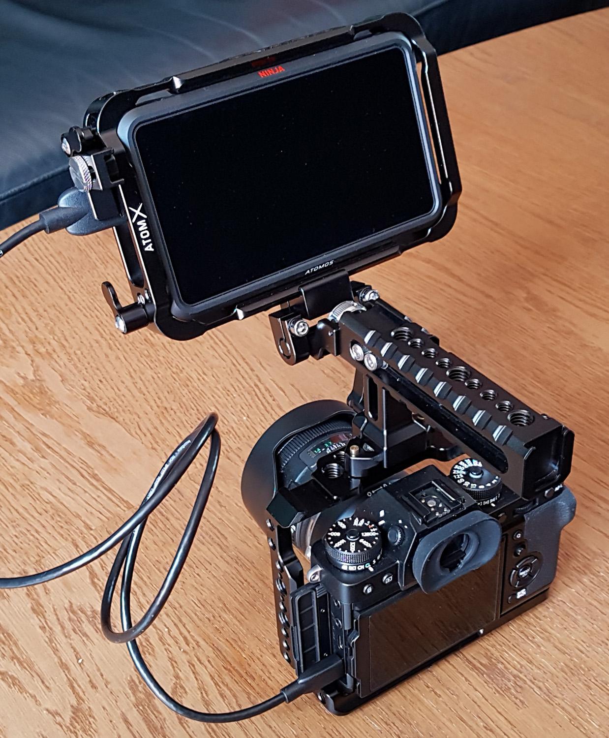

thephoenix Posted May 24, 2019 Share Posted May 24, 2019 speaking of ninja, got my cage today, pretty cool Link to comment Share on other sites More sharing options...
