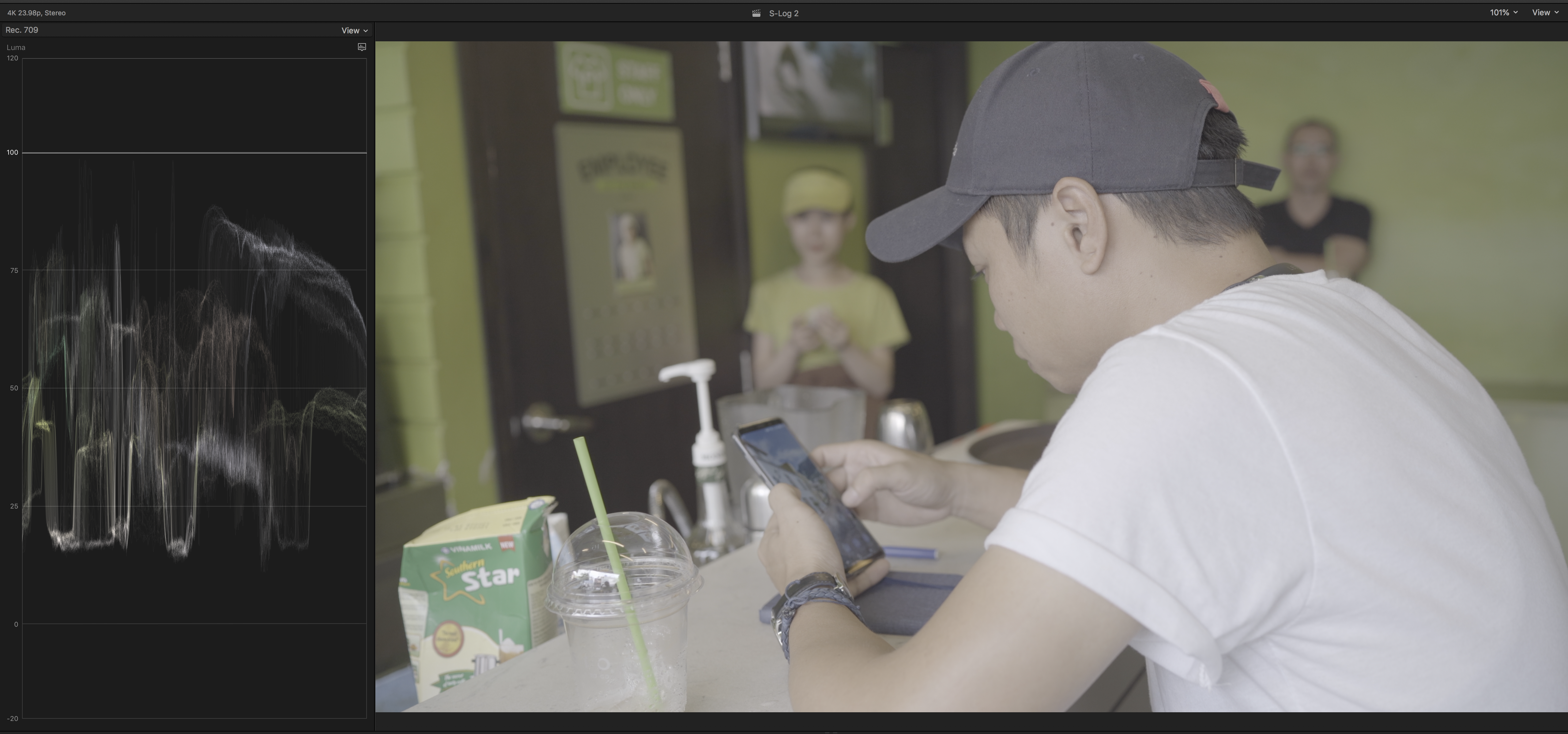

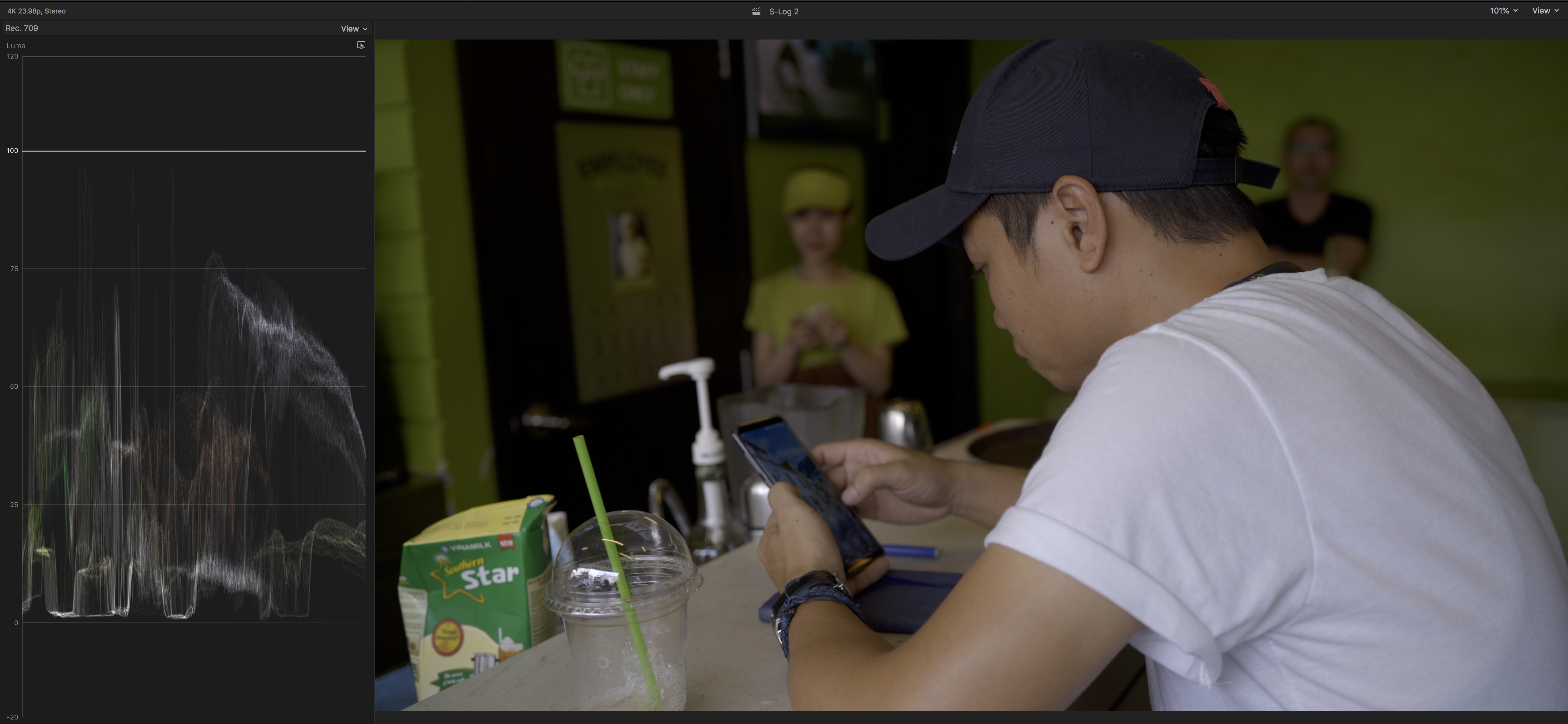

jonpais Posted September 24, 2018 Share Posted September 24, 2018 Log curves lift the lower and middle parts of dynamic range higher up where most of the bit depth is located so you have more shadow detail to play with without clipping highlights. When exposing S-Log2, the footage looks flat and washed out. Watching some grading tutorials, you’ll see that all log clips have the same milky desaturated appearance. It has not been overexposed so much as properly exposed. If underexposed, you’re losing the benefits of shooting log. I believe all log profiles work pretty much the same way. Samples Link to comment Share on other sites More sharing options...
Robert Collins Posted September 24, 2018 Share Posted September 24, 2018 49 minutes ago, jonpais said: Log curves lift the lower and middle parts of dynamic range higher up where most of the bit depth is located so you have more shadow detail to play with without clipping highlights. When exposing S-Log2, the footage looks flat and washed out. Watching some grading tutorials, you’ll see that all log clips have the same milky desaturated appearance. It has not been overexposed so much as properly exposed. If underexposed, you’re losing the benefits of shooting log. I believe all log profiles work pretty much the same way. Samples Actually SLog on Sony cameras is something of a special case. While the camera says it is recording at 'iso800' it is in fact recording at base iso 'iso100' so footage is bound to be underexposed irrespective of the underlying log curve.. You can see this by analysing the underlying metadata. Supposedly Panasonic cameras do something fairly similar but with only a one stop difference. Link to comment Share on other sites More sharing options...
jonpais Posted September 24, 2018 Share Posted September 24, 2018 @Robert Collins Interesting. hehe I think you're right, because I exposed for his shirt with zebras at 100+ and the scopes show it's quite a bit lower! omg Link to comment Share on other sites More sharing options...
Robert Collins Posted September 24, 2018 Share Posted September 24, 2018 7 minutes ago, jonpais said: @Robert Collins Interesting. hehe I think you're right, because I exposed for his shirt at 100+ and the scopes show it's quite a bit lower! omg If you think about it - a camera (as in say the A7iii) which has a base iso of 100, why would it really choose to shoot SLOG at an iso of 800 (lets forget about the dual iso bit for the moment)? If it did so, it would effectively reduce dynamic range by close to 3 stops and increase noise by close to 3 stops. The answer is it doesnt record slog at iso 800 but at iso 100 and therefore you have to 'overexpose' to 'expose' correctly by +2EV+. (I think the situation is pretty similar with the Panasonic GH5. Its native iso is 200 but it records log showing iso at 400. Something like that.) Why Sony does this I really dont have a clue - someone suggested it was something to do with maintaining compatibility with cinema cameras which have a higher inherent base iso. Link to comment Share on other sites More sharing options...
