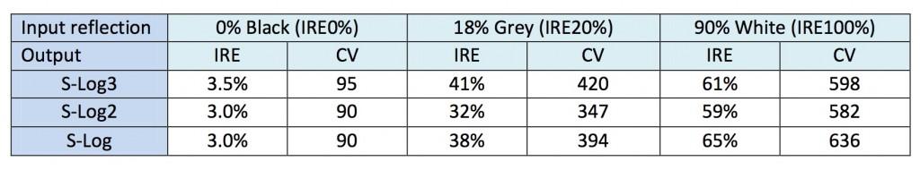

AlexTrinder96 Posted September 24, 2018 Share Posted September 24, 2018 The Mlut/cine IE helps with rating the camera at a different iso to what's it actually recording; so you can set the lut to show at 800 or 640 when you're actually recording at 2000. I also forgot to attach the Recommended Ire values from Sony themselves. It's can be helpful as a starting point if you don't monitor in rec709! Link to comment Share on other sites More sharing options...
