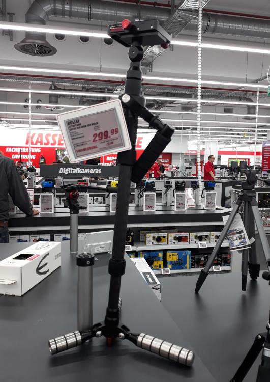

UncleBobsPhotography Posted October 3, 2018 Share Posted October 3, 2018 Perhaps we should take more note from archery stabilizers: https://luacguides.wordpress.com/equipment/stabilizers/ The goal should be to spread the mass out as much as possible while keeping image sensor (or focal plane?) in the center of mass. Putting the battery on the very back is the most obvious way of doing this, but I've also got some tungsten weights I can attach to 15mm rods to get a similar effect while keeping size down. kye 1 Link to comment Share on other sites More sharing options...
