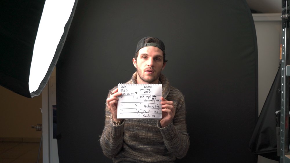

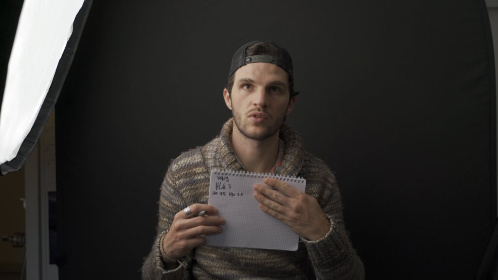

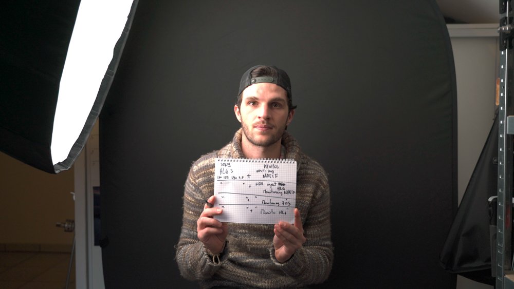

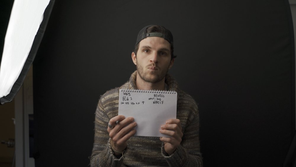

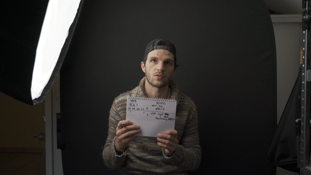

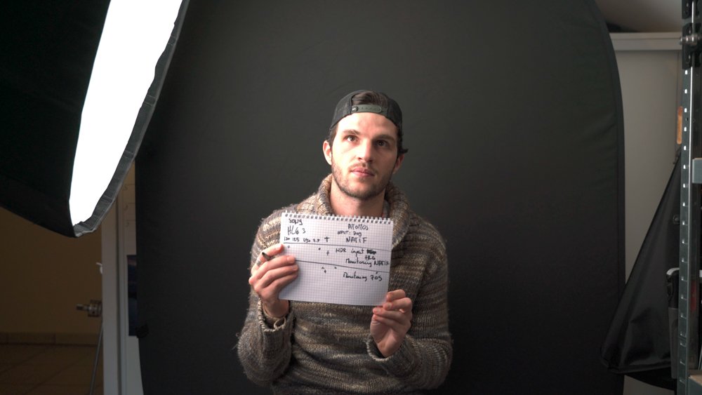

Mindwide Posted January 16, 2020 Share Posted January 16, 2020 On 12/28/2019 at 2:55 AM, androidlad said: What makes you think you PC monitor and camera monitor have accurate color? ? Ninja V does have a slighter warmer factory calibration, around 6000K instead of standard D65. If it really bothers you, you can calibrate the screen with i1 Display Pro. Hi everyone, Maybe @Androidlad you ll be able to answer. I have the Sony A7III and the Atomos Ninja V. I made a test this afternoon and I can't figure out what it's happening. I set my Sony in hlg3 picture profile. I record first internally, then I record with the Atomos ( Atomos without matching camera and hlg) and get the same result. Then I switch the Atomos in HDR input and switch CAMERA OUTPUT to the correct brand Sony the Correct Gamma HLG and correct gamut BT2020. I let the monitoring gamma to native and the record was the same as the 2 first record. I tried with the monitoring gamma on rec709, HLG and PQ and you can see on screenshot that the highlights are blown out. The camera setting never change and the EV was set to 0.0. All the screenshots are from my timeline in premiere pro. I'd like to know what I'm doing wrong?? PS: I'm unable to put the screenshoots in the right order. The 3 pictures with blown out highlights are those with monitoring gamma set to rec709, HLG and PQ Hope to read you soon Link to comment Share on other sites More sharing options...
androidlad Posted January 16, 2020 Share Posted January 16, 2020 12 hours ago, Mindwide said: Hi everyone, Maybe @Androidlad you ll be able to answer. I have the Sony A7III and the Atomos Ninja V. I made a test this afternoon and I can't figure out what it's happening. I set my Sony in hlg3 picture profile. I record first internally, then I record with the Atomos ( Atomos without matching camera and hlg) and get the same result. Then I switch the Atomos in HDR input and switch CAMERA OUTPUT to the correct brand Sony the Correct Gamma HLG and correct gamut BT2020. I let the monitoring gamma to native and the record was the same as the 2 first record. I tried with the monitoring gamma on rec709, HLG and PQ and you can see on screenshot that the highlights are blown out. The camera setting never change and the EV was set to 0.0. All the screenshots are from my timeline in premiere pro. I'd like to know what I'm doing wrong?? PS: I'm unable to put the screenshoots in the right order. The 3 pictures with blown out highlights are those with monitoring gamma set to rec709, HLG and PQ Hope to read you soon It's a Premiere Pro issue, in the third clip with blown out highlights, Premiere Pro sees the PQ/HLG metadata and display the HDR clips as is, without tone-mapping, it assumes you working on an HDR monitor. The highlights aren't actually blown out, if you check the scope, it can be brought back to SDR range with exposure tools. The workaround is record the clips without the HDR metadata. Link to comment Share on other sites More sharing options...
Mindwide Posted January 16, 2020 Share Posted January 16, 2020 2 hours ago, androidlad said: It's a Premiere Pro issue, in the third clip with blown out highlights, Premiere Pro sees the PQ/HLG metadata and display the HDR clips as is, without tone-mapping, it assumes you working on an HDR monitor. The highlights aren't actually blown out, if you check the scope, it can be brought back to SDR range with exposure tools. The workaround is record the clips without the HDR metadata. First thanks a lot for answering! Do you mean record the cilps without HDR metadata on the Atomos or in premiere? If it s premiere how do you change that? In Fcpx it s easy but can't find the right way to do it in premiere. Link to comment Share on other sites More sharing options...
androidlad Posted January 16, 2020 Share Posted January 16, 2020 3 hours ago, Mindwide said: First thanks a lot for answering! Do you mean record the cilps without HDR metadata on the Atomos or in premiere? If it s premiere how do you change that? In Fcpx it s easy but can't find the right way to do it in premiere. Record on the Ninja V. There's no way to change that in Premiere at the moment. BTW you're hot. Link to comment Share on other sites More sharing options...

androidlad Posted January 16, 2020 Share Posted January 16, 2020 1 hour ago, Mindwide said: Tu es français? Si je veux record en hlg il faut que j utilises Davinci pour que je puisse gérer le hdr? Yes, or you can record HLG on Atomos with "native" input to avoid HDR metadata. Link to comment Share on other sites More sharing options...
