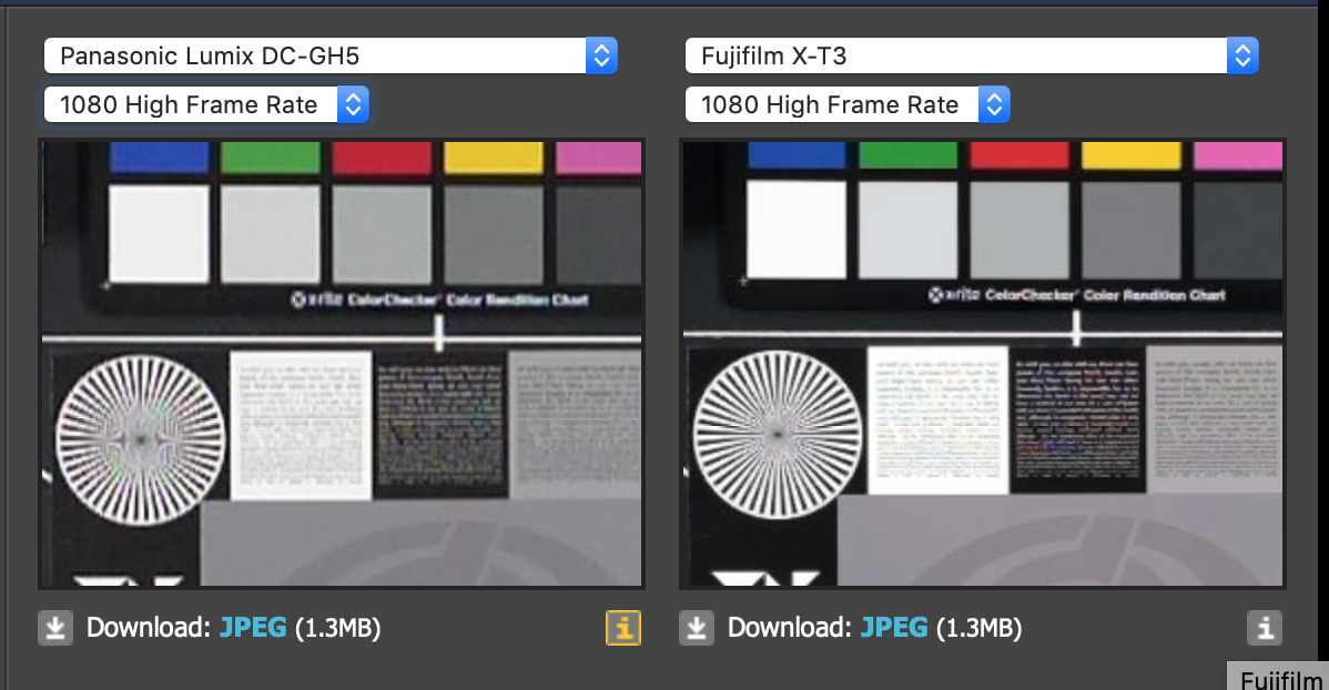

androidlad Posted October 17, 2018 Share Posted October 17, 2018 DPReview just published X-T3 lab test for video, the 120P quality is significantly better than A7 III and GH5. https://***URL removed***/reviews/fujifilm-x-t3-first-impressions-review/7 Quote Link to comment Share on other sites More sharing options...
wolf33d Posted October 17, 2018 Author Share Posted October 17, 2018 14 minutes ago, androidlad said: DPReview just published X-T3 lab test for video, the 120P quality is significantly better than A7 III and GH5. https://***URL removed***/reviews/fujifilm-x-t3-first-impressions-review/7 Thanks for posting So much better indeed. Look at the text phrase under the squares. Damn, much better even than D5500 1080p24 which is pretty good for 1080p. I am buying this thing, at least until the S1 and A7SIII come. Wow, good to finally get a great 120p. It's even better than RX100 VI 1080p24 !! Quote Link to comment Share on other sites More sharing options...
