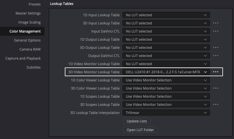

KnightsFan Posted October 14, 2018 Share Posted October 14, 2018 On 10/13/2018 at 1:37 PM, Geoff CB said: Media Player Classic gives the best results for me on PC. 8 hours ago, ade towell said: Me too I checked out Media Player Classic Home Cinema (MPC-HC). It's an improvement over VLC, but it does not match my other color-managed applications (yet!). Would you guys mind sharing your settings or any insights? Currently, I have found: A) Davinci resolve, Krita, Rawtherapee, and GIMP all look identical, and all are manually set to use my calibrated icc profile. In the case of Resolve, this includes generating a 3D LUT from the icc profile using DisplayCAL, as per the tutorial here. (Though I am using sRGB instead of Rec709). B) MPC-HC looks identical to the default Windows Picture and Photo Viewer, but appears to have slightly more contrast than the programs listed in A), or maybe just a slightly lower black level. I adjusted every setting I could find, but could only get worse results, not better. Reading through Wikipedia, I came across this: Quote Unlike most other RGB color spaces, the sRGB gamma cannot be expressed as a single numerical value. The overall gamma is approximately 2.2, consisting of a linear (gamma 1.0) section near black, and a non-linear section elsewhere involving a 2.4 exponent and a gamma (slope of log output versus log input) changing from 1.0 through about 2.3. The purpose of the linear section is so the curve does not have an infinite slope at zero, which could cause numerical problems. AND I notice that in the color management section of MPC-HC, you can choose between Gamma 2.2, 2.35, and 2.4. So perhaps MPC-HC is actually using a single gamma value? That would explain why it looks just BARELY off from the A) programs. C) VLC is on its own planet. Changing renderers will change the colors around, but they don't explain what is actually happening so it's anyone's guess which settings are most accurate. 1 hour ago, Dimitris Stasinos said: Overall i think those are major issues and must be discussed more on the forums. It's funny cause we talk everyday about how disruptive a codec or a compression method could be and i just discovered that every single clip i have exported from AE has been rendered in a slightly shifted colorspace. I couldn't agree more. Every day, lots of people here on EOSHD discuss the color science of various cameras. I'm assuming they are all viewing on calibrated monitors? If so, I hope they will chime in and help us out! Dimitris Stasinos 1 Quote Link to comment Share on other sites More sharing options...

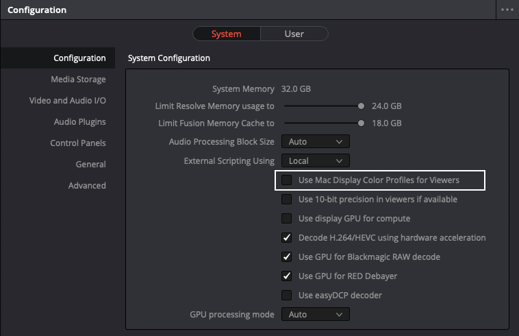

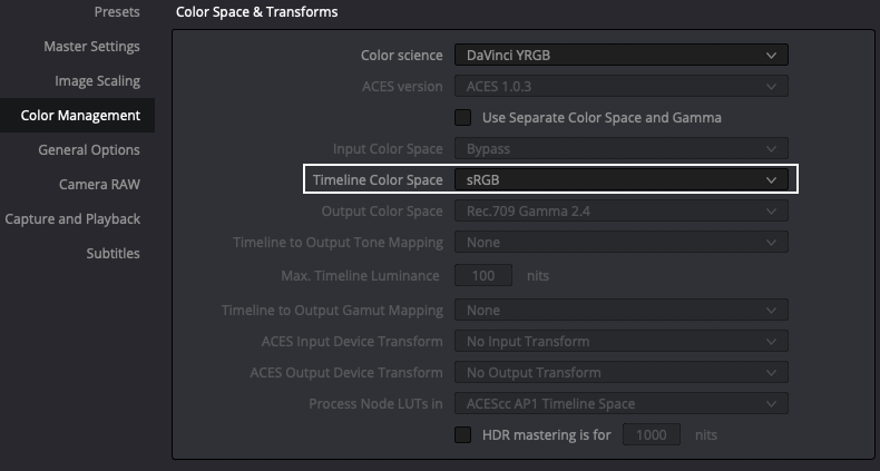

Stathman Posted October 14, 2018 Share Posted October 14, 2018 Just did a quick test on Davinci also. The way I get the exported file (ProRes) to look exactly the same with what I see inside Davinci is this: 1.Turn off "Use Mac Display Color Profiles for Viewers 2. Instead, convert your monitors' icc profile to .cube and use it as a 3D Video Monitor LUT 3. Use sRGB for Timeline Color Space 4. Export ProRes I'm sure that this is not the correct way to do it, but this is a workflow that works for me. Quote Link to comment Share on other sites More sharing options...
Dimitris Stasinos Posted October 15, 2018 Author Share Posted October 15, 2018 Thanks for your input @Stathman Indeed i used ProRes 422 for my tests and this where the color shift pops up. Choosing my icc profile in project settings didn't work in first place (i was getting strange results) but i just tried the sRGB 2.1 colorspace you mentioned and i can say it's the closest thing i can get to the rendered file. Thanks for that man! This is legit workaround and more reliable than using my own lut. As for Resolve, the most common solution is what KnightsFan suggested. Making a custom LUT through DisplayCal. Quote Link to comment Share on other sites More sharing options...

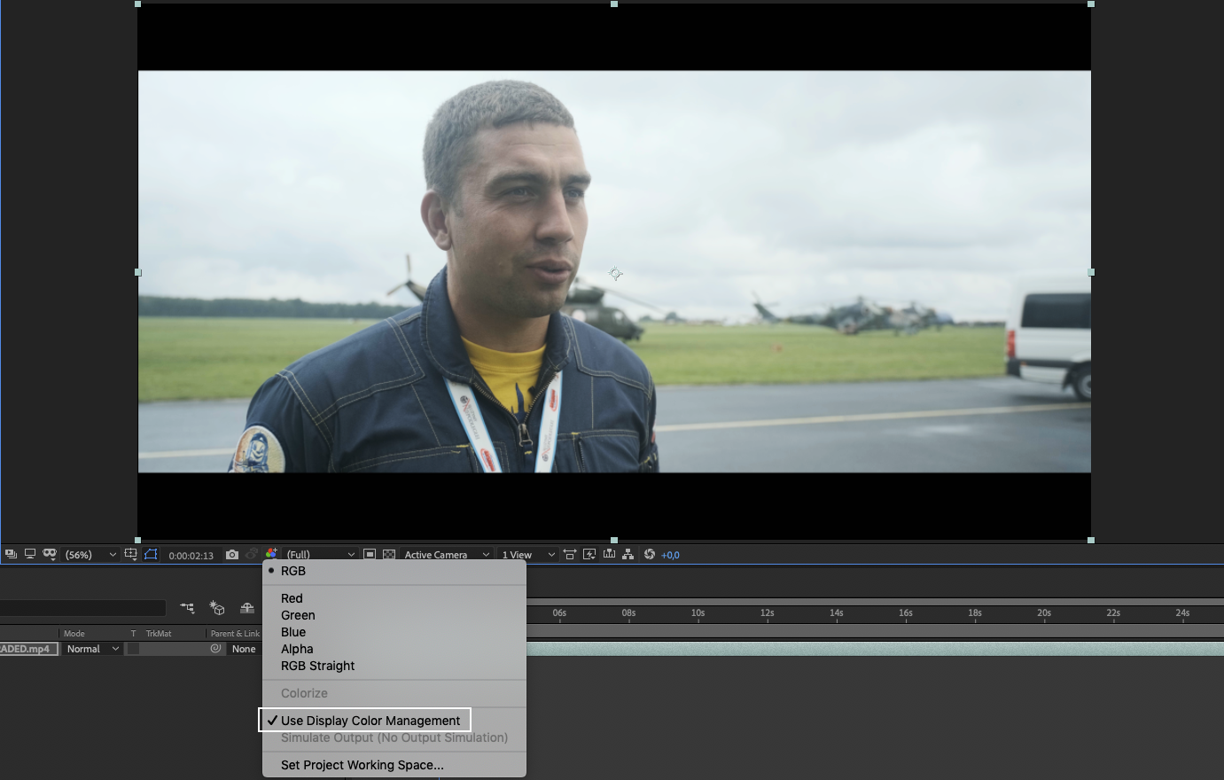

Stathman Posted October 15, 2018 Share Posted October 15, 2018 After some more tests on after effects I have found that this settings gives me the most accurate results: 1. Enable "Use Display Color Management" 2. Prepare your work in Rec.790 Gamma 2.4 color space 3. Just before rendering switch the working space to sRGB 2.1 4. The exported ProRes file will look almost identical to the preview you get on Rec709 working space. Just with a negligible exposure shift. Quote Link to comment Share on other sites More sharing options...

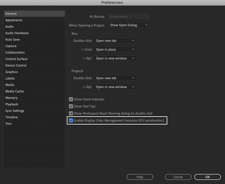

Stathman Posted October 20, 2018 Share Posted October 20, 2018 Finally, they added a Display Color Management option on Premiere 2019. Quote Link to comment Share on other sites More sharing options...
