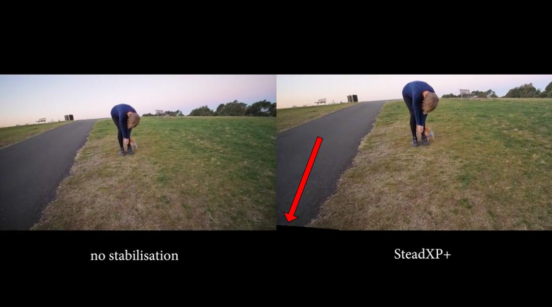

Super Members BTM_Pix Posted October 21, 2018 Author Super Members Share Posted October 21, 2018 30 minutes ago, Emanuel said: Absolutely. I find this test sample much more interesting though, apart the subject : -) It looks so promising and really could be a huge thing for X-T3,GH5s and Pocket4K but the workflow in having to render it first in their software rather than it be a plug in for NLE's is a drawback. I've also noticed a few instances in videos where its run out of road and left some black areas. The video I posted at the top has a couple and this one has one at 0:28 which I've highlighted here I think thats an area where if it was a plug in and you were doing it on a clip by clip basis you could fix small glitches like that. It would be a pain to render the entire thing out in their app and then have to either re-do it all or take it into an NLE and just fix it manually. Link to comment Share on other sites More sharing options...

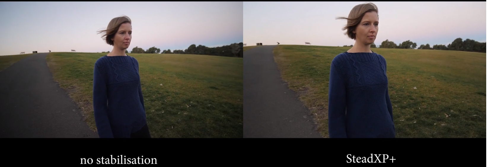

UncleBobsPhotography Posted October 21, 2018 Share Posted October 21, 2018 I'm pretty sure they're using crazy fast shutter speed to get it to work. That doesn't mean that it's not useful, but it's simply not possible to make shaky 30p shot at 180 degrees good. I don't have any real proof, but I would have guessed her hair would usually have been more blurry in windy weather than this: Link to comment Share on other sites More sharing options...
Super Members BTM_Pix Posted October 21, 2018 Author Super Members Share Posted October 21, 2018 9 minutes ago, UncleBobsPhotography said: I'm pretty sure they're using crazy fast shutter speed to get it to work. That doesn't mean that it's not useful, but it's simply not possible to make shaky 30p shot at 180 degrees good. I don't have any real proof, but I would have guessed her hair would usually have been more blurry in windy weather than this: Indeed. Looking at this review, it has comments from SteadXP themselves regarding shutter speed. "...we recommend around 1/200 sec shutter speeds, but experienced user can go as low as 1/100. It's a small limitation with very high contrast scenes, but you can get perfect cinematic look in a lot of situations!" Mmm.... https://www.engadget.com/2018/01/24/steadxp-s-dslr-stabilizer-impressions/ UncleBobsPhotography 1 Link to comment Share on other sites More sharing options...
