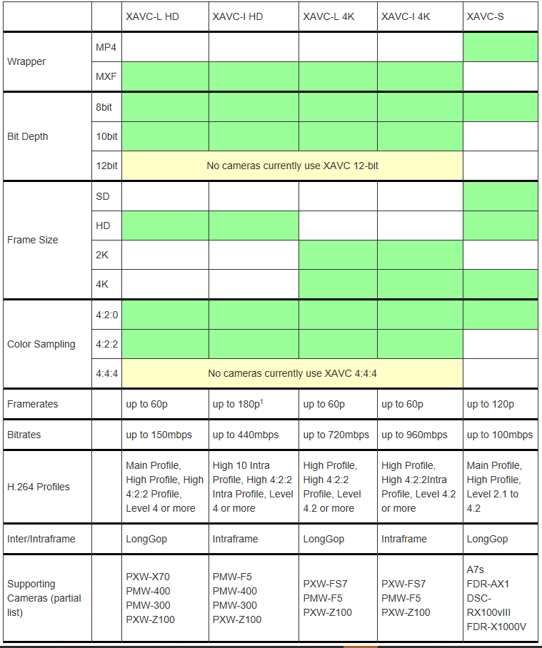

Mako Sports Posted October 23, 2018 Share Posted October 23, 2018 Seems unlikely for a brand new codec as that work and R&D was done years ago. Maybe something like XAVC IL (intraframe light) This new camera would require UHS 2 cards as UHS U3 cards top out at like 150mbps. I really don't want to deal with a bitrate above 300, overkill on cams like these at the moment and just takes up an ubsurd amount of space. If you want 600mbps buy an FS7 or used F5.. (Note - this chart is pre Venice) Link to comment Share on other sites More sharing options...
IronFilm Posted October 23, 2018 Share Posted October 23, 2018 Yes, the most hopeful we can dream of is that Sony gives us XAVC-L 10bit 422 4K 30fps in the a7s mk3 or new Pro APS-C E mount camera. That would even beat the FS5! What would be less surprising is if they simply matched the FS5 and gave XAVC-L 8bit 420 4K 30fps and XAVC-L 10bit 422 1080 60fps in an E mount stills camera. BTW, XAVC-L 10bit 422 1080 60fps on the FS5 maxes out as 50 MB/s Thus I'd assume the XAVC-L 10bit 422 4K 30fps maxes out 100 MB/s (because roughly 4x for the 4K, then roughly halve it for the 30fps vs 60fps. Just as a quick guesstimate seat of my pants assumption on the spot). These SD cards are somewhat pricey, but still quite "cheap", as they're almost the same price I paid for my slower Extreme Pro cards back when I first purchased my BMPCC: https://www.bhphotovideo.com/c/product/1275619-REG/sandisk_sdsdxpk_064g_ancin_extreme_pro_uhs_ii_64gb.html Their rating: Max. Write Speed: 260 MB/s Yeah, I'm sure the SD cards in an a7Smk3 / a7000 could handle XAVC-L 10bit 422 4K 30fps just fine! (if Sony wants to support it. A big if!) Link to comment Share on other sites More sharing options...
