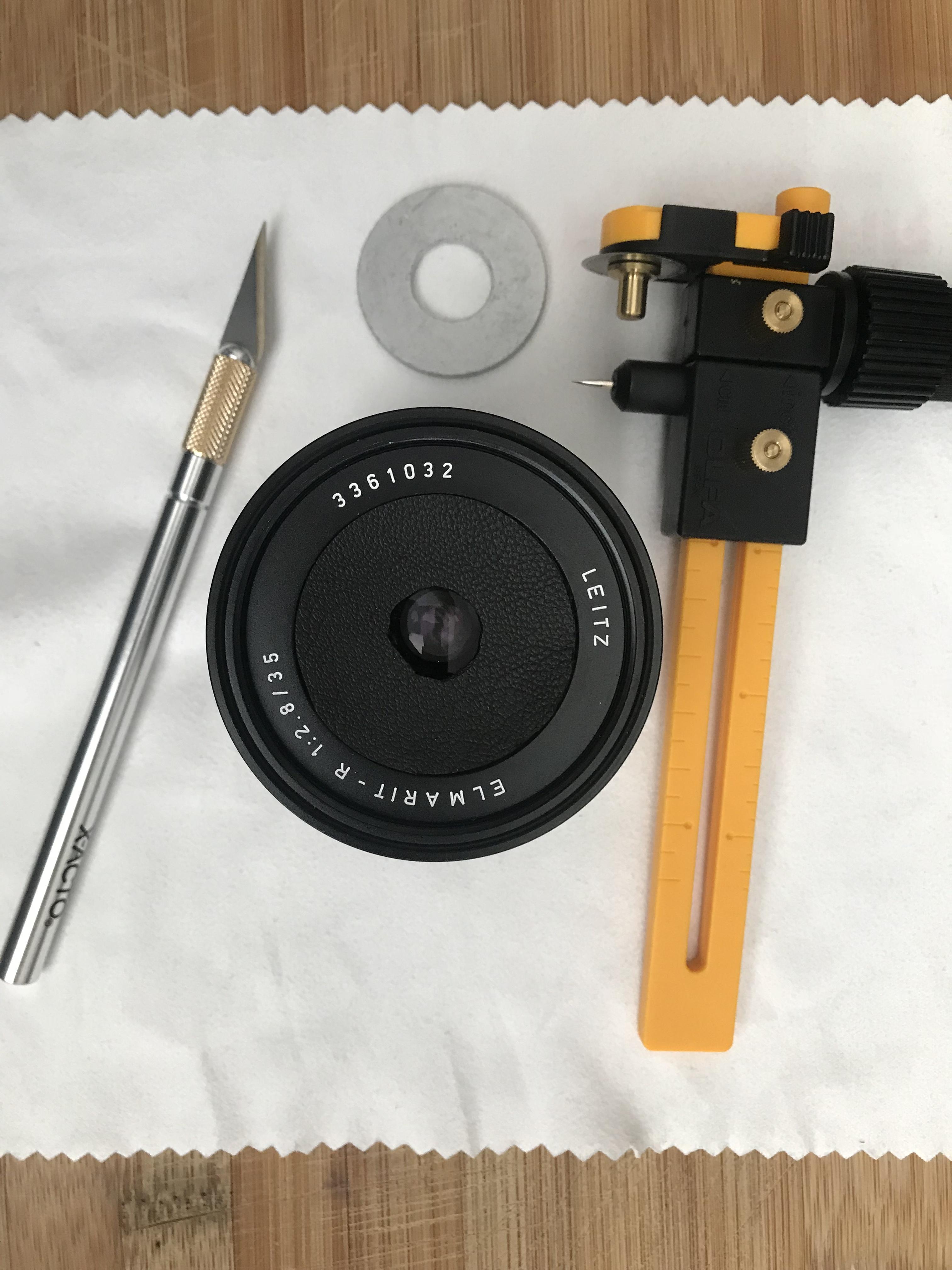

I use Zhongyi II speedbooster with GH5S and 35mm Elmarit-R is the widest I can go. Had to use rings instead of Redsan adapter as it is really important to get the back of pre 36 to the front element of Leica. It is almost touching the glass. Also, I added this to the lens (managed to make better cut in the middle, but don’t have photo), which helped to remove white flare.
That's a good idea, I'll have a look at getting the isco closer to the lens.
