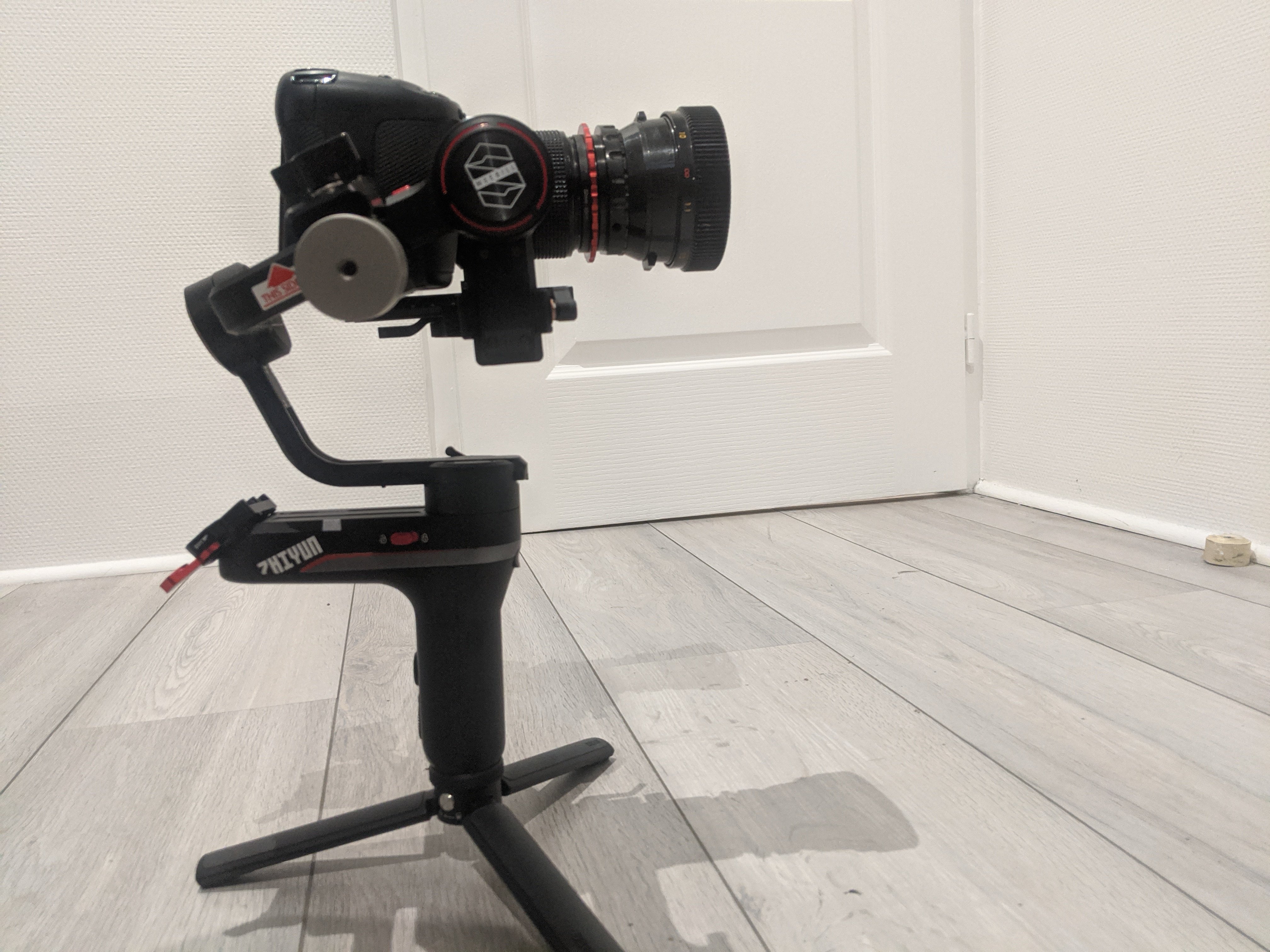

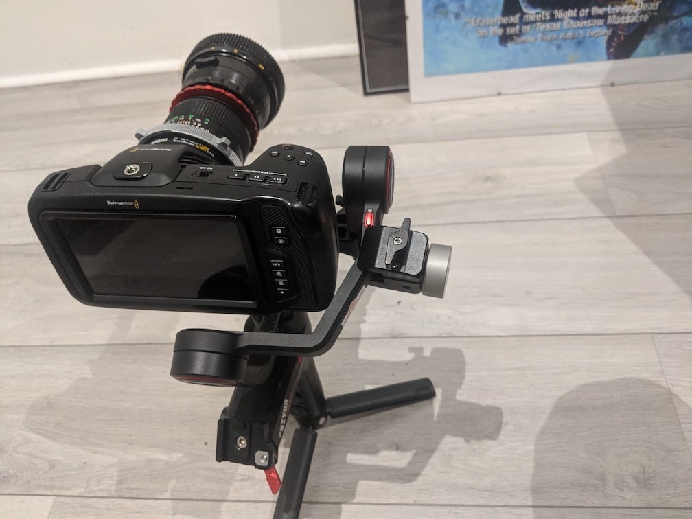

Slothorp Posted November 18, 2019 Share Posted November 18, 2019 You can perfectly balance it on the Zhiyun weebill S with just a counterweight. It even works with a heavy lens such as this combo : metabones speed booster + canon fd 35mm + iscorama 36. Link to comment Share on other sites More sharing options...
