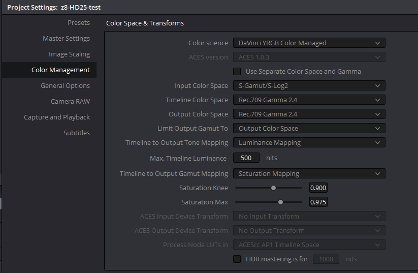

michaelezra Posted December 5, 2018 Share Posted December 5, 2018 I would like to setup color management in Davinci Resolve when using Z-Log L profile. Instead of the LUT I would like to set the correct input color space. What is the suitable input color space? I tried S-Gamut/S-Log (2),(3) and they don't work well. Thanks! Link to comment Share on other sites More sharing options...

michaelezra Posted January 8, 2019 Share Posted January 8, 2019 On 12/4/2018 at 10:55 PM, michaelezra said: I would like to setup color management in Davinci Resolve when using Z-Log L profile. Instead of the LUT I would like to set the correct input color space. What is the suitable input color space? I tried S-Gamut/S-Log (2),(3) and they don't work well. Thanks! its been over 1 month since I purchased the Z-Log profile and asked the question above. Is there ANY support here? Link to comment Share on other sites More sharing options...

Geoff CB Posted October 17, 2019 Share Posted October 17, 2019 On 1/7/2019 at 11:39 PM, michaelezra said: its been over 1 month since I purchased the Z-Log profile and asked the question above. Is there ANY support here? Considering that in order for that menu to support it you would need Blackmagic to implement it. EDIT: Removed my response. Sorry for the harsh reaction. Link to comment Share on other sites More sharing options...
Geoff CB Posted February 16, 2020 Share Posted February 16, 2020 For those grading in ACES this Z-LOG L works wonders if you set the ACES input transform to one the following: Canon C500 Daylight v1.1 DCI-P3+ Canon C500 Tungsten v1.1 DCI-P3+ The gamma curve seems to line up perfectly, creating great highlight rolloff and natural color. Simon Young 1 Link to comment Share on other sites More sharing options...
Administrators Andrew Reid Posted February 16, 2020 Author Administrators Share Posted February 16, 2020 6 hours ago, Geoff CB said: For those grading in ACES this Z-LOG L works wonders if you set the ACES input transform to one the following: Canon C500 Daylight v1.1 DCI-P3+ Canon C500 Tungsten v1.1 DCI-P3+ The gamma curve seems to line up perfectly, creating great highlight rolloff and natural color. Great stuff. I used my C500 as a reference point when creating Z-LOG on my Z7. The C500 is now sold but was a great image. I'll keep my 1D C for a while longer. It really helps as a benchmark for Pro Color and all sorts. Geoff CB 1 Link to comment Share on other sites More sharing options...
Wayne Folta Posted May 18, 2020 Share Posted May 18, 2020 On 10/16/2019 at 9:46 PM, Geoff CB said: Considering that in order for that menu to support it you would need Blackmagic to implement it. EDIT: Removed my response. Sorry for the harsh reaction. I assume that it's unlikely that NIkon Z-Log would become so popular that BMD would add it as a managed input colorspace. But it does seem like there is a fair amount of magic above and beyond a simple LUT... is that true? Is that magic so powerful that it's worth trying to find a managed input colorspace that's sort-of close? For example, I've played with using Nikon N-Log. If I then pull the Lift down to -0.06 and the gain to 0.65, things look reasonable. Maybe a bit too much saturation, and maybe a slight green tint. (I set Luminance Mapping and 350 nits for my couple-of-year-old MacBook Pro, and also turned on Saturation Mapping.) But would I actually gain anything by doing this instead of just picking the simpler -- and more correct -- input LUT and being done? (I'm assuming I also lose some things with by using the wrong colospace, since you didn't model Z-Log to try to get the same results as N-Log, right? Actually, my "seems a bit too much saturation, and maybe a slight green tint" might just be the tip of the iceberg and there might be lots of add-on problems with using a "close enough" managed colorspace.) Link to comment Share on other sites More sharing options...
