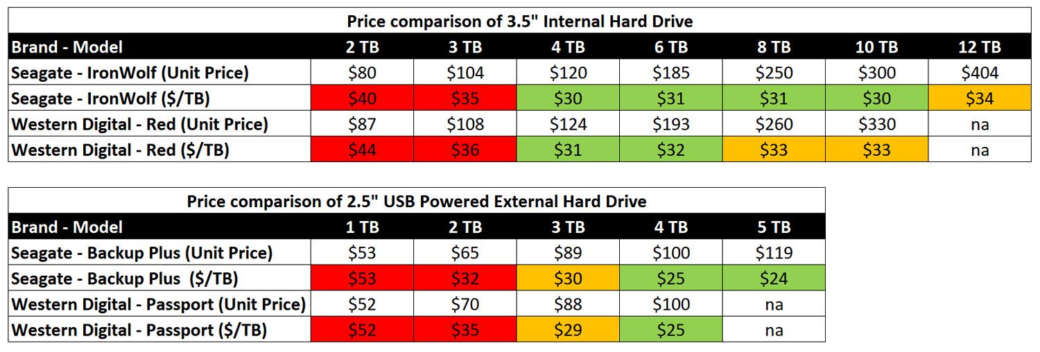

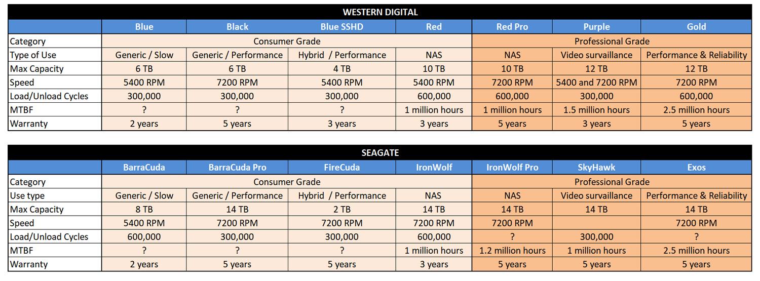

OliKMIA Posted November 14, 2018 Share Posted November 14, 2018 There isn't much options, the 3 majors brands left are seagate, WD and Toshiba. All about the same in terms of performance and reliability (check blackbaze stats on its website). So far the largest HD are in the 12-16 TB range and the price per TB doesn't lower beyond 3-4TB. We are reaching the maximim size and nothing should change until next year when WD and Seagate will introduce HAMR and MAMR. As for speed, you should get a 7200rpm but the best is not to use HD for editing, even mounted in Raid 5. Here are some comparison I made of actual price and product range Mmmbeats and Deadcode 1 1 Link to comment Share on other sites More sharing options...

OliKMIA Posted November 15, 2018 Share Posted November 15, 2018 21 hours ago, chadandreo said: I have a T3 and Sandisk Extreme 510, but its not practical since we work on multiple projects at a time. I usually do basic editing on regular external HDDs and save the intensive stuff and exporting for my raid. I understand. For speed, RAID 0. The more drives you add, the faster but there is also a greater risk of loosing everything if one drive fails. RAID 5 seems a good solution for speed and safety. As for which drive to pick, it depends of your budget. You can see my previous chart as a starting point for your research. For a RAID 0 system used for editing I would got for WD black or Seagte Barracuda Pro. They are fast, relatively cheap and available in different capacity based on your need. Link to comment Share on other sites More sharing options...
