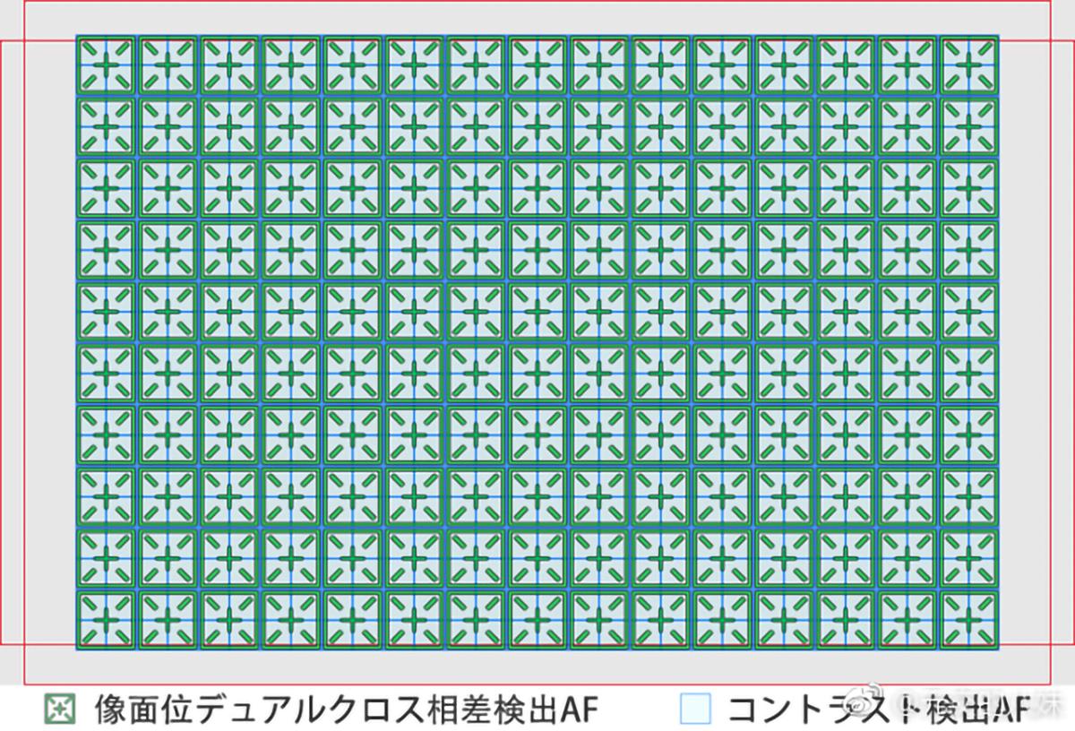

androidlad Posted December 17, 2018 Share Posted December 17, 2018 Brand new PDAF design from Sony Semicon, significantly faster and more accurate AF performance with zero impact on pixel fill factor. Works reliably up to -5EV, f/11. Link to comment Share on other sites More sharing options...

JurijTurnsek Posted December 17, 2018 Share Posted December 17, 2018 On 12/17/2018 at 11:33 AM, androidlad said: Brand new PDAF design from Sony Semicon, significantly faster and more accurate AF performance with zero impact on pixel fill factor. Works reliably up to -5EV, f/11. Expand Wouldn't it be funny if Sony debuted their fastest AF on an a7S body ? Link to comment Share on other sites More sharing options...
liork Posted December 17, 2018 Share Posted December 17, 2018 Funny but welcome! Link to comment Share on other sites More sharing options...
