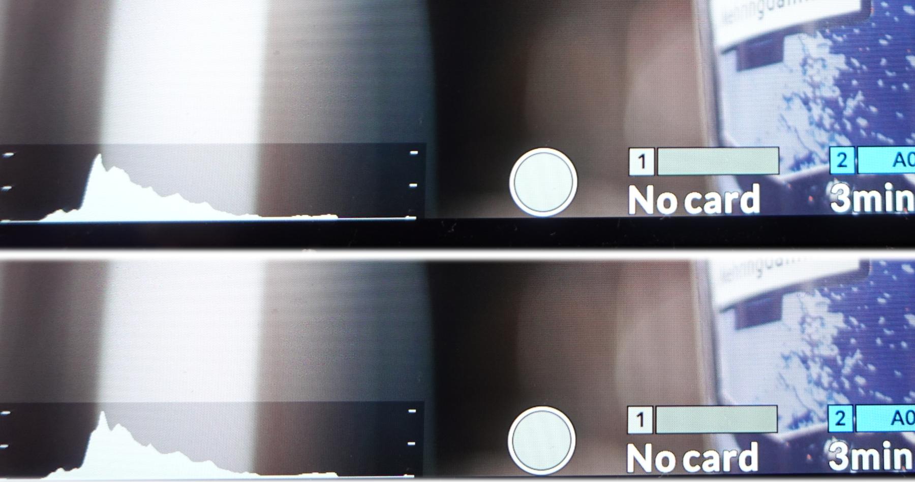

Super Members BTM_Pix Posted November 27, 2018 Super Members Share Posted November 27, 2018 I'm finding what might be described as "interesting" behaviour when changing aperture values. Aside from the unusually high degree of granularity (there are 66 different positions between f1.3 and f22 for example), I'm finding that there are a number of repeats within these positions. For example, there are two f1.3s, so when you have it on f1.3 then step up to the next value it is also f1.3. This is repeated at several other positions and is the same, for me at least, on both native MFT and adapted lenses. At some positions, there is no difference in exposure (so if you move from the "first" f11 to the "second" f11 it appears the same) but worryingly that is not always the case. On a Canon nifty fifty on a speedbooster for example there is a very clear exposure difference between the two f1.3 settings. The quirkiness of it having that many steps and some repeats is something I can live with if it was consistent between lenses and was only an indication foible in terms of the repeats but its neither of those things unfortunately. I have an understanding of why it is happening based on the BM protocol and messages I'm reading back from the camera over bluetooth but I have a limited range of lenses so obviously, it would be appreciated if any of you could check behaviour of a couple of lenses and see what happens with yours and I'd be particularly interested if anyone can try it with lenses with a wider aperture than f1.3 to see if there is a similar issue there. Grimor 1 Link to comment Share on other sites More sharing options...
Anaconda_ Posted November 27, 2018 Share Posted November 27, 2018 I just tested with my nifty fifty and have the same thing. If I'm on f1.3, and try to stop down a notch, I hear the lens tick, but the image remains the same and it still says f1.3. At f.11 though, I stop down a notch and the image gets darker but it still reads f.11. This isn't the case with 24-105 though. When I get home, I'll try my Sigma 30mm 1.4 (f1.0 with viltrox) and see what happens. Interesting find, but don't see it have too much impact on daily shooting. BTM_Pix 1 Link to comment Share on other sites More sharing options...
Super Members BTM_Pix Posted November 27, 2018 Author Super Members Share Posted November 27, 2018 6 minutes ago, Anaconda_ said: I just tested with my nifty fifty and have the same thing. If I'm on f1.3, and try to stop down a notch, I hear the lens tick, but the image remains the same and it still says f1.3. At f.11 though, I stop down a notch and the image gets darker but it still reads f.11. This isn't the case with 24-105 though. When I get home, I'll try my Sigma 30mm 1.4 (f1.0 with viltrox) and see what happens. Thanks These are the histograms from my "two" f1.3 settings on the nifty fifty and I can definitely see from the shift that they are two distinct settings on mine at least. 7 minutes ago, Anaconda_ said: Interesting find, but don't see it have too much impact on daily shooting. I know what you mean but I'm not sure its ideal that depending on which direction you approach some particular f stops will decide whether you get the "real" setting or the one that doesn't do anything, particularly if you are exposing via an external light meter? And that even that inconsistency is in itself inconsistent depending on which lens you are using. In the case of my lens above, I had a little bit extra in hand when I went down to the "second" f1.3 that I wouldn't have been aware of if I'd not gone past the first one. It also has implications for anyone trying to match more than one camera as well in that you'd have to agree that both were on the same version of the f stop. It also causes sync issues with their own app where to add to the fun you can have one setting displayed on the app and another on the camera, which again has implications for anyone such as a gimbal manufacturer making a viable remote control for it. The root of the problem is that the camera doesn't profile the lens so the interpretation by the lens of the value that they use for the aperture ends up being a bit of a crap shoot depending on whether the lens actually has a physical setting that matches it. Link to comment Share on other sites More sharing options...
Anaconda_ Posted November 27, 2018 Share Posted November 27, 2018 I can see it being an issue with the app, but for multi camera shoots, the difference will be minimal. But yeah, I see what you're saying and agree its worth thinking about and knowing before setting up and pressing go. On my 30mm f1.4(f1.0) I get a tick but no value change at f1.0/.1/.2/.3/.4 - So each value essentially has two exposures. And yes, now I look at it more closely, there is a slight difference to the picture with each tick. And lastly it does appear on the 24-105, but only on f11. Link to comment Share on other sites More sharing options...
Super Members BTM_Pix Posted November 27, 2018 Author Super Members Share Posted November 27, 2018 Thanks for checking. I suppose its at the wide end of the aperture that its going to have to be borne in mind as there may be a bit more there that people won't discover - as with the nifty fifty - unless they go one step further than what it is reporting as the maximum aperture. So the rule of thumb is that when you think you've reached the maximum, turn it one more step. It a bit of a reverse Nigel Tufnel from Spinal Tap really as these go to -1 rather than 11. Link to comment Share on other sites More sharing options...
