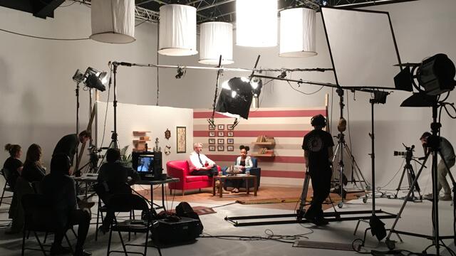

Super Members BTM_Pix Posted November 30, 2018 Author Super Members Share Posted November 30, 2018 4 hours ago, webrunner5 said: I hope there is not a test for all of this! ? Don't worry, it will be quite an easy multiple choice one like this. Q. Assuming an ISO value of 800 and a shutter speed of 1/48th of a second, what is the correct aperture setting for the scene below ? f10 The other f10 Link to comment Share on other sites More sharing options...
graphicnatured Posted November 30, 2018 Share Posted November 30, 2018 It's the other f10. Everyone knows that! webrunner5 1 Link to comment Share on other sites More sharing options...
webrunner5 Posted November 30, 2018 Share Posted November 30, 2018 2 hours ago, BTM_Pix said: Don't worry, it will be quite an easy multiple choice one like this. Q. Assuming an ISO value of 800 and a shutter speed of 1/48th of a second, what is the correct aperture setting for the scene below ? f10 The other f10 You know I have never had to interview on a set like that. I can't imagine how a person would not be intimidated, and could relax, and be yourself! graphicnatured 1 Link to comment Share on other sites More sharing options...
graphicnatured Posted November 30, 2018 Share Posted November 30, 2018 39 minutes ago, webrunner5 said: You know I have never had to interview on a set like that. I can't imagine how a person would not be intimidated, and could relax, and be yourself! It would be even more difficult when the person you're engaging with seems to have Mickey Mouse ears. ? Link to comment Share on other sites More sharing options...
