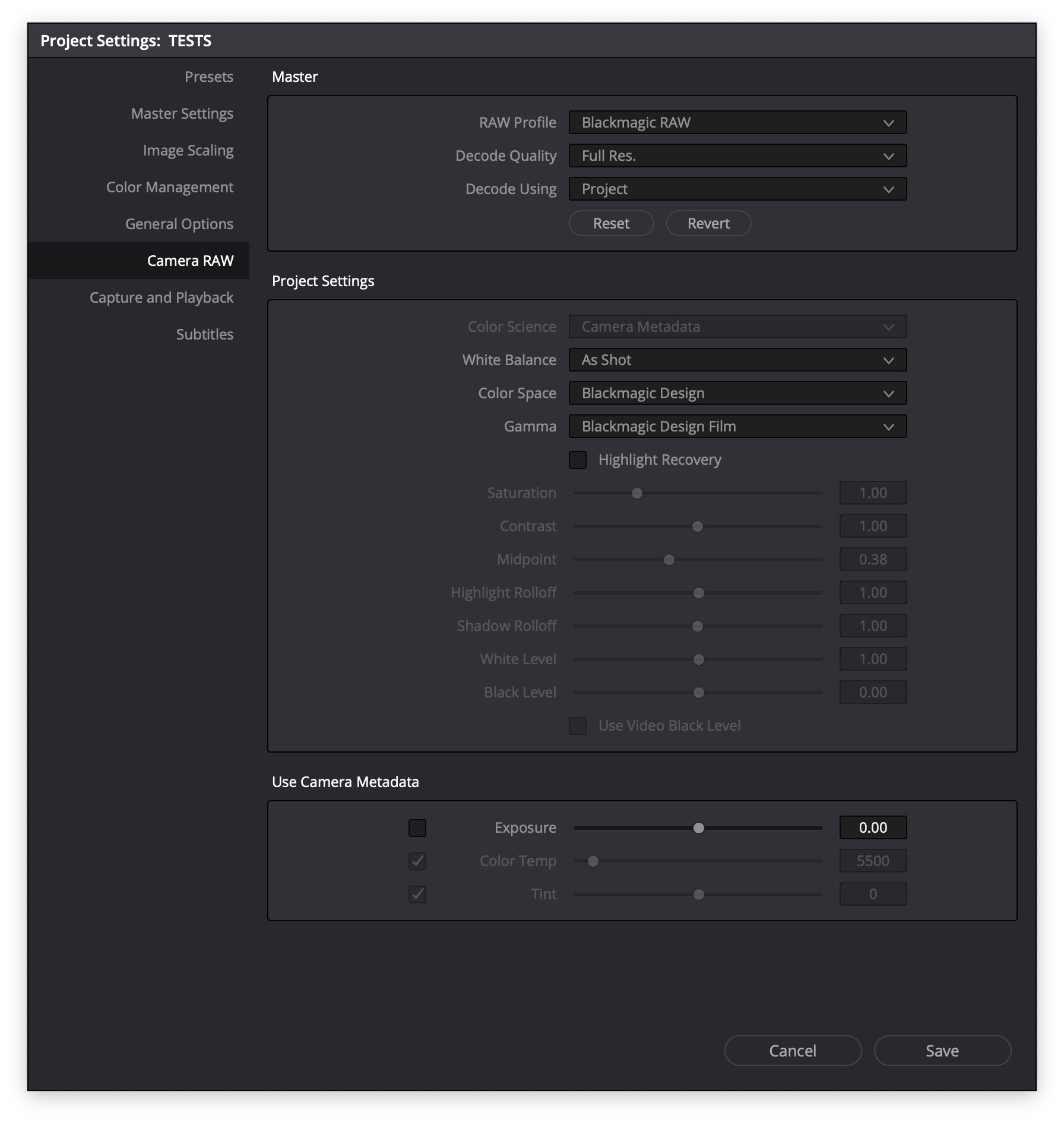

Anaconda_ Posted March 6, 2019 Share Posted March 6, 2019 3 hours ago, kye said: Uh oh, here come the cinematic noobs ??? Including me, as a RAW noob... Can help me with project settings for working with Braw? Does this look right? While editing, there's no problem in adjusting the 'Decode Quality' to half or quarter for smoother playback on a laptop right? as long as I change it back to full for the export? Should I have Highlight Recovery on by default? Or adjust that on a clip by clip basis in the Color tab? All help is greatly appreciated. EDIT: also, I've generated a sidecar file, but the Blackmagic RAW Player still shows me the ungraded clip, even when the video and sidecar are the only files in the folder it's playing from. - anyone else having a similar experience? Link to comment Share on other sites More sharing options...
kye Posted March 7, 2019 Author Share Posted March 7, 2019 6 hours ago, Anaconda_ said: Including me, as a RAW noob... Can help me with project settings for working with Braw? Does this look right? While editing, there's no problem in adjusting the 'Decode Quality' to half or quarter for smoother playback on a laptop right? as long as I change it back to full for the export? Should I have Highlight Recovery on by default? Or adjust that on a clip by clip basis in the Color tab? All help is greatly appreciated. EDIT: also, I've generated a sidecar file, but the Blackmagic RAW Player still shows me the ungraded clip, even when the video and sidecar are the only files in the folder it's playing from. - anyone else having a similar experience? I don't have much experience grading RAW so not really my area unfortunately. What I can tell you is that Resolve seems to do everything in a non-destructive way. What I mean is that you can have a node that pushes the exposure to clip the whole frame, but if you then pull it down with the next node it's all still there. Also, you can have a 4K clip on a 720p timeline and if you export it as a 4K clip it will pull all the resolution from the source clip regardless of what the timeline resolution was. So, in a sense it kind of doesn't matter what you do as long as the end result is where you want it. One exception to this is that you have to be careful with the order of operations as you can get funny results. Ie, you can get different results applying adjustments by applying them before or after various conversions or other adjustments, so that's the thing to watch out for. Link to comment Share on other sites More sharing options...

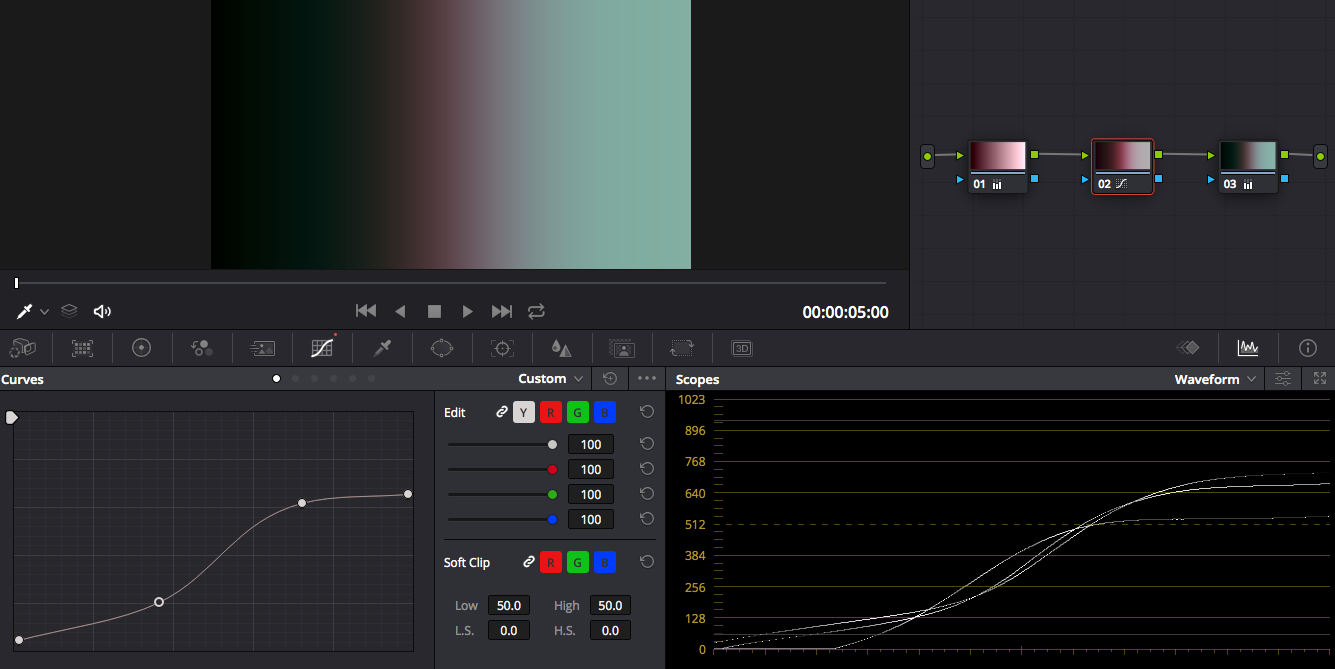

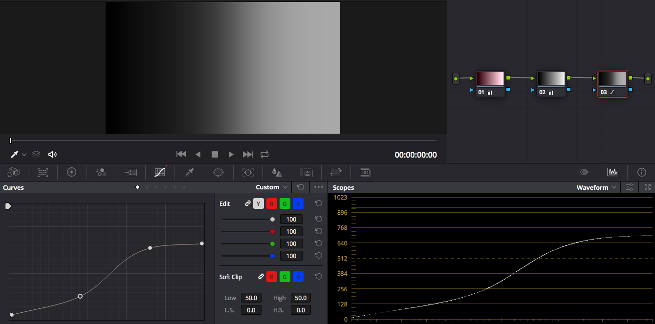

kye Posted March 7, 2019 Author Share Posted March 7, 2019 Edit: to expand on the order of operations comment with an example.. If we take a gradient, apply a colour treatment, apply an opposite colour treatment, then add some contrast with some curves, this is what we get: However, if we apply the same adjustments but change the order so that we apply the curve in-between the colour adjustments we get this: This is relevant because it simulates having an incorrect WB in camera, then trying to balance it in post but doing it in the wrong order. Inside the camera the sensor sees in Linear, then transforms to LOG (or whatever the codec is set to) and so the camera has already made the first two adjustments of WB adjustment and then a set of curves. This is further complicated by the fact that different tools work in different colour spaces. Some are designed to work in LOG (IIRC specifically the Cineon LOG curve - Juan Melara recommends ARRI LogC as being the closest match to this) - I believe the Cffset, Contrast/Pivot, and other tools are for LOG. Others are designed to work in Rec709, such as the Lift Gamma Gain wheels. In a sense this isn't a problem as there is no such thing as 'correct' as very few of us are trying to capture a scene accurately, we deliberately adjust the WB of shadows and highlights separately (orange/teal, film emulation LUTs, etc) and we deliberately abandon a Linear gamma curve (almost any adjustment), and we apply separate treatments to different items within the scene (keys, power windows, gradients) so none of the above really matters in these cases, however it's good to be aware as if you're going for a natural look then you might be applying a teal/orange style adjustment like I showed above, but not in a good way. This is why there is such an emphasis on getting WB correct in-camera if you're using a colour profile - anyone who has done this and tried to recover the shot in post faces an impossible task of basically having to work out how to reverse the adjustments that the colour profiles applied. That magical Canon colour science isn't so magical if you're trying to work out how to un-do it, make an adjustment, and then re-apply it! Link to comment Share on other sites More sharing options...
