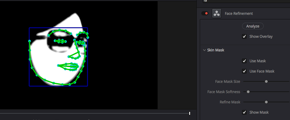

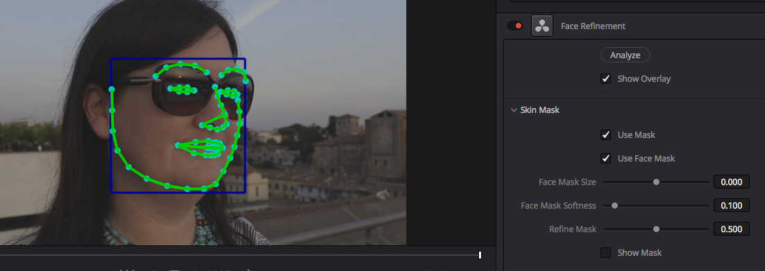

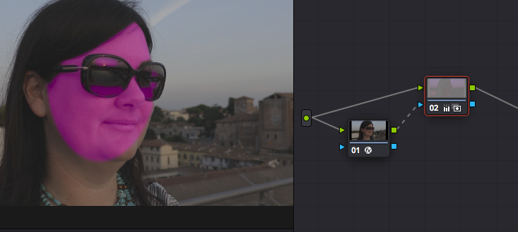

kye Posted May 18, 2019 Author Share Posted May 18, 2019 11 hours ago, andrew_dotdot said: I use the face enhance regularly, and I like it. I don't use it to change the look very much, but I use it judiciously for the following things: * sharpen the eyes * a gentle "remove eye-bags" does wonders * sometimes "remove shine" is helpful for hair-impaired men * brighten or darken a face independently of other nodes in the grade So, it's totally fine for a quick enhance. I've not used other beauty plug-ins -- so I can't compare, I'm afraid. Sometime, though, I wish you could use the mask it generates to do other things outside the face enhance tool itself. You see that nice mask and that nice outline, and you wish you could convert it to a tracked window, for example. You can! Step 1: apply the plugin Step 2: select the "Show Mask" box under Skin Mask Step 3: connect another node like this, then apply adjustments in the second node: As you can see it's not perfect, but this is probably a bad example and I didn't try at all to refine it, and there are lots of mask refinement adjustments in the Face Refinement plugin. Bonus Tip: you can do this with any node that has a "show mask" feature. I've done it with the EdgeDetect plugin, for example to soften only particularly harsh edges, etc. Lots of potential using this method to get highly stylised effects that no single plugin can do by itself. andrew_dotdot, Geoff CB and buggz 2 1 Link to comment Share on other sites More sharing options...
andrew_dotdot Posted May 18, 2019 Share Posted May 18, 2019 5 hours ago, kye said: You can! Step 1: apply the plugin Step 2: select the "Show Mask" box under Skin Mask Step 3: connect another node like this, then apply adjustments in the second node: As you can see it's not perfect, but this is probably a bad example and I didn't try at all to refine it, and there are lots of mask refinement adjustments in the Face Refinement plugin. Bonus Tip: you can do this with any node that has a "show mask" feature. I've done it with the EdgeDetect plugin, for example to soften only particularly harsh edges, etc. Lots of potential using this method to get highly stylised effects that no single plugin can do by itself. Wow! I made a rather halfarsed attempt to do this one time and failed. I will definiera give this another try. Thank you! kye 1 Link to comment Share on other sites More sharing options...
