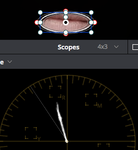

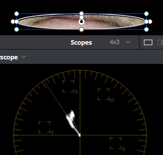

Yep.. that's right, sorry I should have said.  Specifically the line in Resolve.  Theres a bit of a debate about if it's the skin colour line or just an indicator, but the point is that skin tones actually vary wildly in hue depending on lighting conditions.  The idea that skin tones should be on the line are shot down pretty quickly on the grading forums.

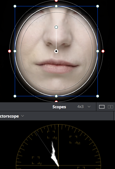

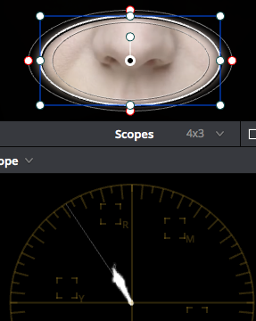

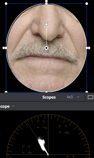

Here are a bunch of vector scopes from the ARRI video - notice the highly, highly, highly controlled skin tones!

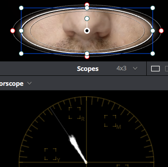

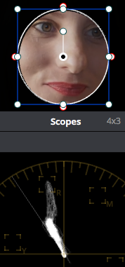

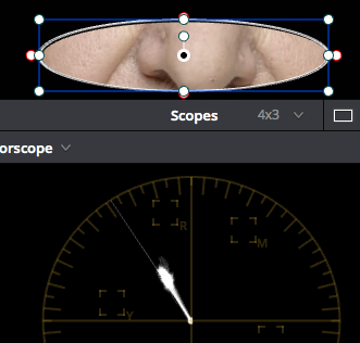

These are a couple from the C200 demo video (IIRC) and note the more spread out line, and also that the line is between the indicator line and the Red reference box, and even slightly beyond the red in certain areas.

wow, @kye, awesome~! thank you for the visual aides!!! i get it now ?
edit: ykno, ive been looking at arri footage for awhile now, but this is eye opening
> their skin tones are super homogeneous... almost too flat...? there must be a lot of magic going on to put those hues all right on that line, and i get why they do it, but...
the people in the arri shots look somewhat... mannequinesque. like, can you imagine them blushing? they are kinda wax like ?
That's right - it depends on the light. Imagine a magenta neon light - its got a limited spectrum. That the LF promo video is on the line is a sign that they are using a rich, full spectrum light in the studio - no doubt the Arri Skypanel. Sunlight and Halogen are relatively smooth spectrum, and an accurately balanced Alexa will place on the line; off-the-self leds and flourescents are a different story.

Actually it's easy to even out the skintones. Just use hue vs hue curve with 4-5 adjustment points between red and yellow.

It's definitely a 'look' but as @Deadcode says it's quite achievable with the hue vs hue curve to push the skintones together a bit and lessen the hue spread. Also worth paying attention to is the saturation as that's quite controlled too. It's worth pulling a still into Resolve and with a tiny window having a look around the face to see which bits make up the overall vectorscopes above.
Personally, when I first saw them I was quite surprised at how yellow and processed they looked and while I've gotten used to the look since then it's still quite a strong look for my eyes.
