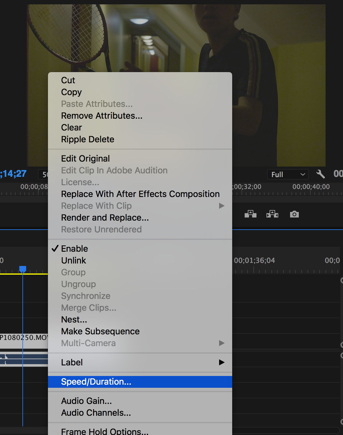

@yan_berthemy_photography Posted December 5, 2018 Author Share Posted December 5, 2018 16 minutes ago, thebrothersthre3 said: I am assuming you'll slow the 60 frame videos down to 24 frames, hence they will be 24 fps not 60, so it should also be rendered at 24fps. For slow motion 120 shutter or 200 or even higher is fine. Ok, shall I change the video speed or will apply by changing the video from 60 to 24? Link to comment Share on other sites More sharing options...
thebrothersthre3 Posted December 5, 2018 Share Posted December 5, 2018 23 minutes ago, @yan_berthemy_photography said: Ok, shall I change the video speed or will apply by changing the video from 60 to 24? You have to change the speed in post. Rendering a video playing at 60 frames per second in 24 frames per second will simply delete frames. Link to comment Share on other sites More sharing options...
@yan_berthemy_photography Posted December 5, 2018 Author Share Posted December 5, 2018 2 minutes ago, thebrothersthre3 said: the speed in post Yes, speed and duration? or directly by editing the original video and interpret the footage to 24fps? So, for shutter speed, I set as 180 shutter angle. Link to comment Share on other sites More sharing options...
