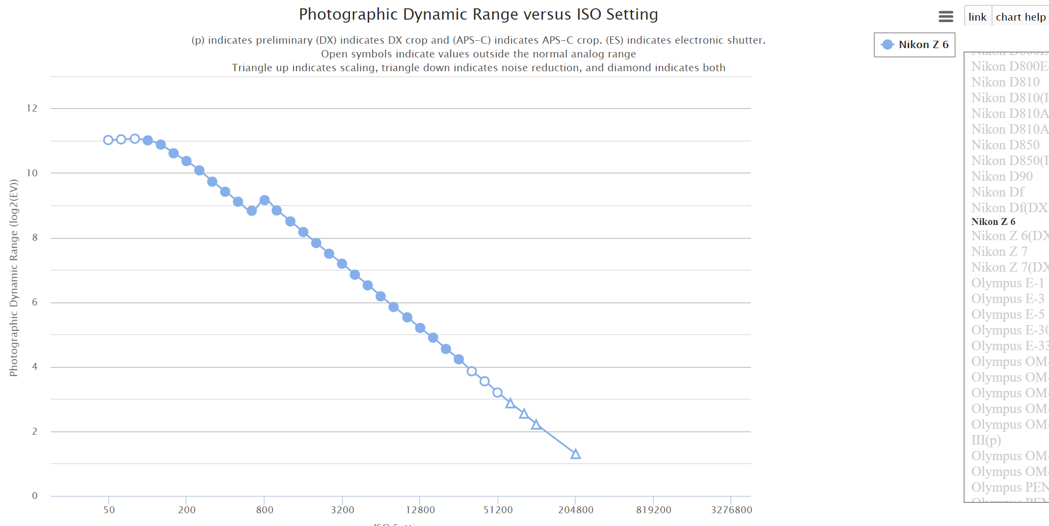

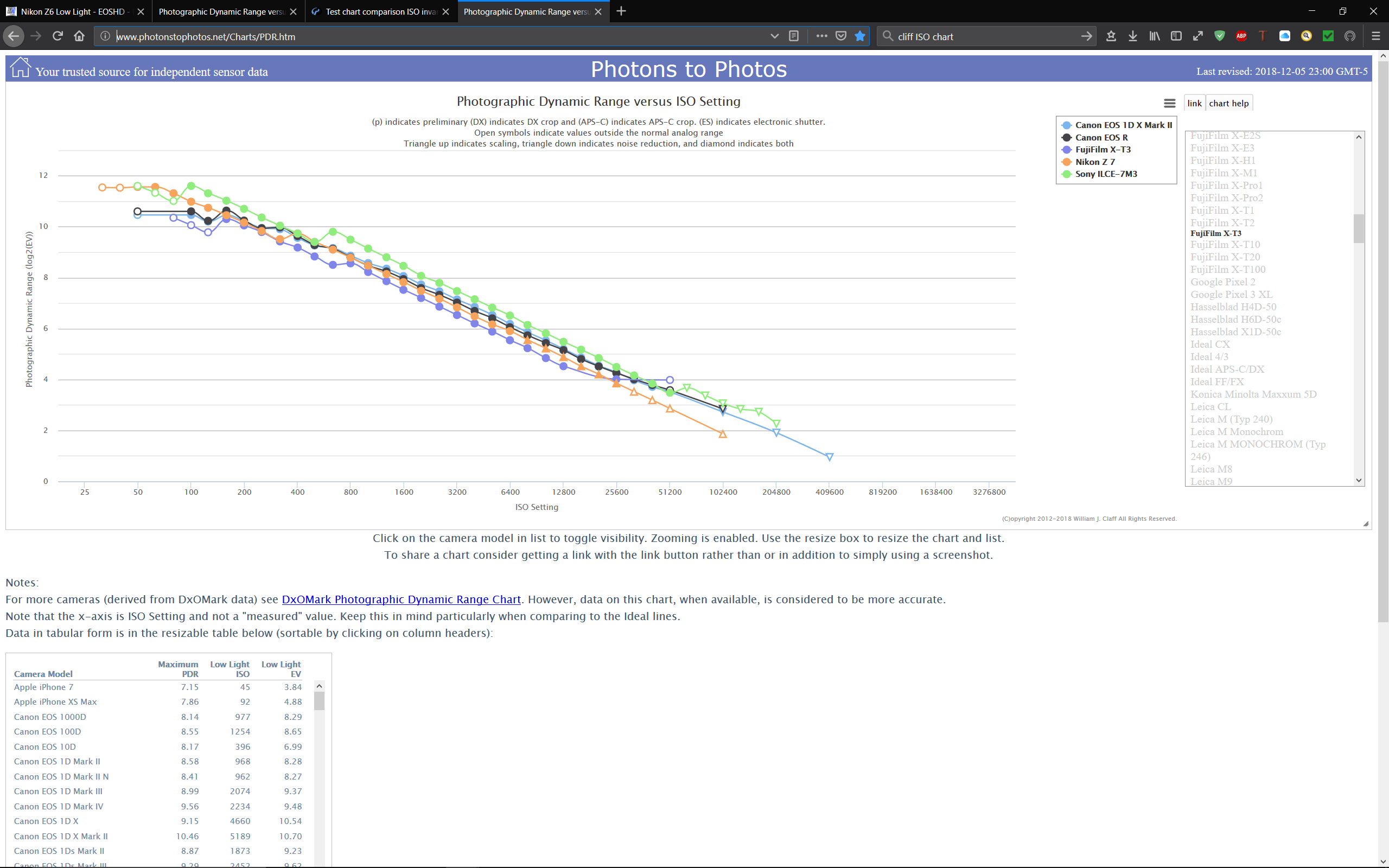

webrunner5 Posted December 11, 2018 Share Posted December 11, 2018 I think just about every camera has a bump in ISO on his test. Plug in a few different late version cameras and they all have some sort of boost or dip in them. I don't think there is any dual ISO going on in a Nikon Z camera at all. The Sony A7 mk III has a Way bigger jump than the Nikon Z7. http://www.photonstophotos.net/Charts/PDR.htm Here is the Nikon Z6 test. Link to comment Share on other sites More sharing options...
