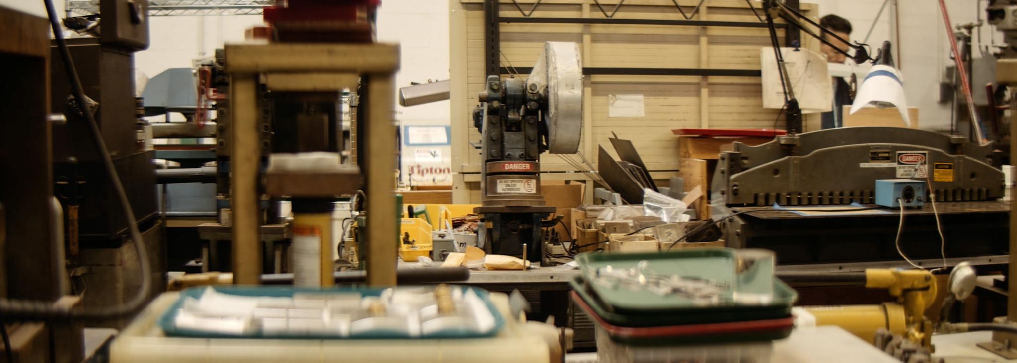

kazkioken Posted January 28, 2019 Author Share Posted January 28, 2019 On 1/22/2019 at 2:29 PM, Rikoshet said: Any news man? Would like to see some footage from you and a couple of words about using experience. Have pocket 4k too. hey yeah! Still waiting for some gear and the project I am working on with this setup doesn't start production till late March or so. But here's some stills from test footage in the meantime. I am going to be using the Nikkor 50 1.8 and the 85 f2 as taking lenses together with an XL .64 Metabones...also waiting to receive a V1 Aivascope which I will use in some shots for flaring. The V2 does not flare unless you really blast it with something. I ended up with a ProtoDNA thanks to the wonderful advice from JSD and it's awesome. I am just now opening a box with the Titla G2X and Nucleus Nano. Will get her all balanced up and report back with some pics! Planning on mostly using one Pocket4K on sticks, another dedicated to the gimbal for tracking shots. Rikoshet and Ian Edward Weir 2 Link to comment Share on other sites More sharing options...
