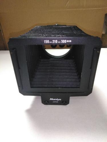

leslie Posted January 24, 2019 Author Share Posted January 24, 2019 its a very backyard construction process, no expense spared at the moment ? but i'm not too concerned my boss has a waterjet cutter arriving in the next couple of weeks. so i plan on cutting some interesting shapes out on it as a learning experience in some more appropriate materials during my lunch break of course. i have bought a bellows off ebay a Mamiya RB67 Bellows lens Hood 150-210-300mm it looks big enough to fit the nap 35 lens and not vignette i hope. well its medium format which is bigger than 35. i know its not a terribly scientific approach more frankenstein than anything. but i think with science you lose alot of the magic in the transmutation process ? Link to comment Share on other sites More sharing options...
