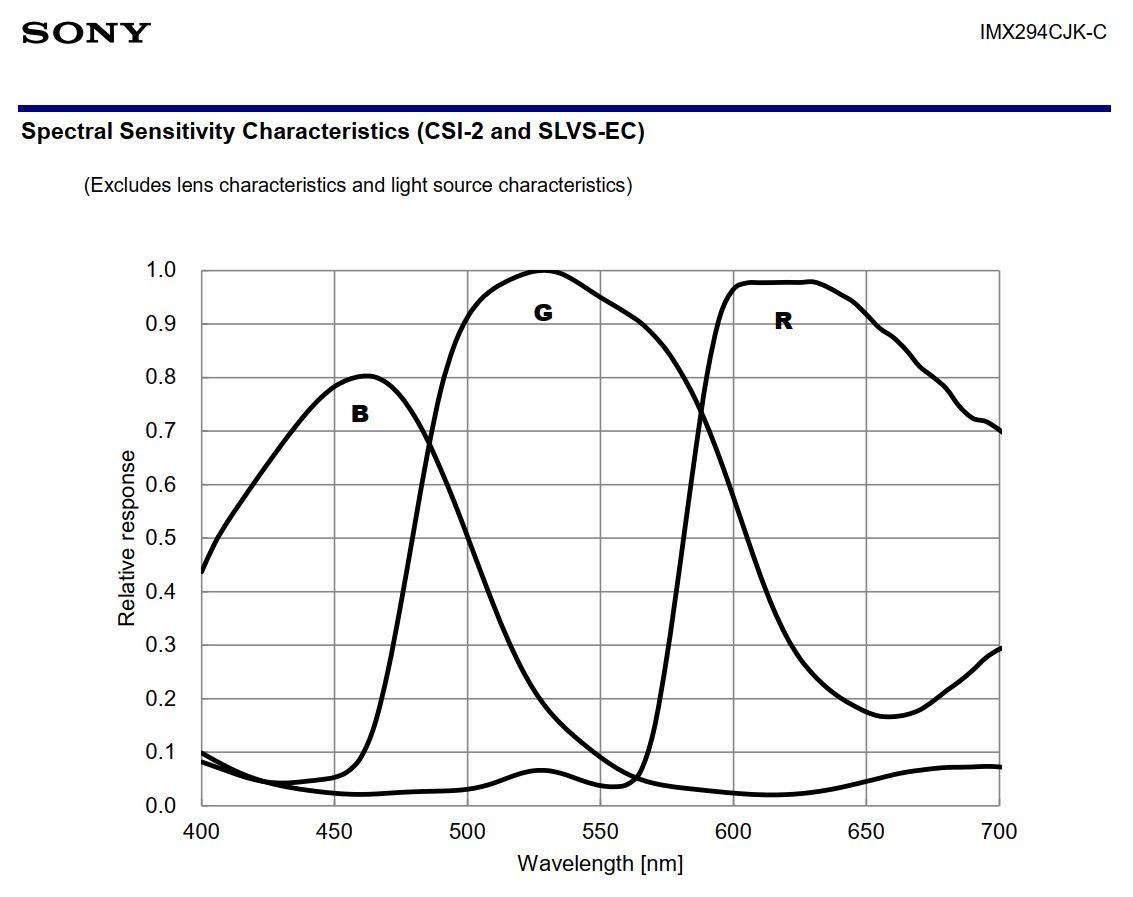

androidlad Posted December 23, 2018 Share Posted December 23, 2018 26 minutes ago, Eric Calabros said: There are pro shooters who can match Canon still raw to Nikon raw, to the level that nobody recognize which is which. The main reason its a bit difficult is that these companies don't share any data about spectral response of the CFA used on the sensor. They don't, but I did. Quote Link to comment Share on other sites More sharing options...
HockeyFan12 Posted December 23, 2018 Share Posted December 23, 2018 39 minutes ago, androidlad said: They don't, but I did. You can get this data from most manufacturers. Much of it is freely available online in white papers. I worked with someone who helped develop the ACES profiles and every major camera manufacturer (except Red, I believe) sent gamut (chromasticities) information for their sensors to help creates the ACES profiles. They varied significantly. And just compare the Sony spectral response curves above to Velvia: http://www.fujifilm.com/products/professional_films/pdf/velvia_50_datasheet.pdf (Note where 0 relative response is.) I love the look of Velvia, and assume the extremely narrow response curves are responsible for it (and for its low ISO). I even prefer it substantially to Velvia 100. Back in the film days, spectral response curves were obviously a big thing. You'd shoot different stocks even if you were doing a DI. So it's no surprise I've always believed a portion of the look is baked into raw images, even if the difference is much smaller than with film stocks. There's been a big change in image characteristics over the course of Canon's dSLR line, even comparing raw files, and I read an article showing much better color (richer yellow/orange) with the earlier CCD models. Even the original 5D has its own look compared with the newer cameras (imo). Canon's changed its BFA filters many times. If there were no functional difference among BFA arrays, Phase One would have never released the trichromatic back (slower but designed for better color) or Sony wouldn't tout the wider gamut on the F55 compared with the F5. At the design stage it seems to be a trade off between color and low light... On the other hand, Red (apparently) has green and red chromasticities closer than most manufacturers, and that's said to account for the ruddy look you'd see in earlier Red footage, but the DXL seems to time that out well with its color profiling, despite having the same sensor. I've been very impressed with the DXL's images, even though I think Arri has the edge with foliage, still. So a lot can be done in post to account for different filter arrays. That's the whole point of ACES... Despite all the evidence that BFAs result in materially different gamuts, and thus materially different looks, I can't conclude anything with any confidence because I'm not an engineer. I suppose in theory if they all cover rec709 the rest can be done with transforms? The story the guy on the ACES board told me was complicated, and way over my head. Whereas those online who claim raw is raw and it's all the same seem very confident in their belief, so, while I choose to believe what I believe because it doesn't really matter that I'm misinformed if I keep my incorrect beliefs to myself, I would generally tend to side with those who believe all raw is the same since they seem to have done the research and are very very confident in their beliefs. Maybe the Phase One back is for suckers or I misunderstand its appeal. ? I do think it's an interesting topic, and I'm a bit ashamed to admit that my belief that different sensors and manufacturers have different imaging and color characteristics has informed my purchasing decisions. There's a sucker born every minute... Quote Link to comment Share on other sites More sharing options...

ND64 Posted December 24, 2018 Share Posted December 24, 2018 In science there is distinct answer to every question, but there are countless ways to make a raw data, visible! So its a anecdotal process, not science. I just put better description from two DPR forum members here: "The term 'colour science' is somewhat meaningless, and has become a marketing and fandom term whereby companies and people can say 'my colours are exceptional due to my special magic'. It's nonsense. So, let's look at the science. Colour vision is a tri-stimulus phenomenon. Your eye has three different kinds of receptor, which have three different spectral responses, generally called S,M and L (a lot of confusion is cause by people incorrectly thinking that they are 'Red', 'Green' and 'Blue'). Your brain decodes the mix of stimuli received in these three types of cone into a colour. Any light stimulus that causes the same mix of S,M and L will cause the same colour to be perceived even if the spectrum is completely different. However, it's even a bit more complex that that. How the brain decodes the colour is not constant, it depends on the prevailing conditions. So, under sunlight and incandescent lighting, the same object will reflect different spectra, and thus produce different S,M and L stimuli, yet the brain will decode the colours the same, because it applies a 'colour temperature' correction.Your camera also has a tri-stimulus system, but its responses are not the same as S,M and L, so your camera doesn't 'see' the same colours as you do. Worse, the spectrum of the three camera stimuli is different camera to camera. Thus, you can't 'see' the colours in a raw file, and your idea that you can 'see' some differences in a raw file is just wrong. To 'see' a raw file it needs to be 'developed'. This means taking the camera-specific stimuli and calculating what human eye responses they should elicit, taking into account the lighting conditions. The human eye responses used are based on a body of work done by the by the International Commission on Illumination known as the Commission Internationale de l’Elcairage (CIE) back in the 1930s. This defined a 'colour space' based on a set of standardised stimuli called XY and Z, which provides a possible description of most human visible colours. From this XYZ space, other spaces for useful devices, such as RGB (if you have a display device based on red, green and blue emission) might be derived. Until your raw file has been transformed into such a standardised and meaningful space you can't 'see' it. When you're 'viewing' a raw file, what you're 'seeing' is a display of a file which is the result if such a development process. This might be a JPEG file embedded in the raw, which the camera generated when you took the photo, or it might be other results of a 'CODEC' operating in the background in your operating system. In either case, what you're seeing is a developed file, and any differences are likely to be as a result of the development process." "Decisions regarding colour made in different converters and cameras, however, do differ. Big part of the difference is that different assumptions of typical colour perception and pleasant colour are made. Another part is that some designers are either rather illiterate in colour science, or employ obsolete tools and notions. Also shortcuts and trade-offs made to balance the system differ. Ultimately, from marketing point of view, cameras are JPEG-producing tools, and everything, including sensor spectral response, is nearly inevitably designed to produce nice-looking JPEGs faster. Sensors in different cameras may have intentionally different spectral responses, different compensations and calibrations may be applied before the raw data is written to what we call a raw file, and after all that a raw converter takes on, adding its own technologies (that may favor some spectral responses over others), trade-offs, and idiosyncrasies to the mix. Because raw file formats are not publicly documented, third-party converters may have additional troubles interpreting colour. Custom profiling of raw converters using modern software, custom-measured targets, and good target shooting discipline makes the difference to mostly go away." Quote Link to comment Share on other sites More sharing options...

HockeyFan12 Posted December 24, 2018 Share Posted December 24, 2018 8 hours ago, Shirozina said: Why? I assume because so long as the chromaticities defined by a given sensor's filter array encompass at least rec709 or sRGB (same chromasticities/gamut, different decoding gammas), then transforms exists to map an image acquired with that sensor to an image acquired with a different sensor that also covers sRGB (assuming the final output is sRGB or rec709). And all color sensors should cover at least sRGB. This is sort of the idea behind ACES if I'm not mistaken. The flilpside of the above argument would be that things like dynamic range, noise performance, and metamerism error can result in an image clipping, being overly noisy, or having poor tonality or colors that bleed into each other or simply false or indistinct colors. And those are inherent to the raw file. And metamerism error cannot be accounted for in software so far as I know. As I wrote above, Phase One's trichromatic back and their standard backs should both more than cover rec709, and yet the images taken with one appear more saturated and with better looking (imo) color than those taken with the other, even on an sRGB monitor. And, for instance, Red's too-close red and green chromasticities make it more difficult to get punchy green foliage in post (though the DXL proves it's possible to and I've also seen work from Company 3 that looks amazing with the Red). So for an expert colorist, I could see making the argument that raw files might as well all be the same... to a point. With raster, however, each company is baking things in quite differently and I think that really does matter, just maybe not where one expects. And that's where Red applies their "color science" label, in the debayer process. So personally I don't think it's entirely BS, even if I think it's mostly a marketing term. (No offense to @Mako Sports, I don't mean to speak for him or disagree with someone more experienced, just hoping to contribute to the discussion even though I'm a real neophyte with this kind of thing. I suspect you have better reasons for claiming it's entirely BS than I do for thinking it's somewhere in-between BS and material.) Also, a lot of raw isn't really really. Canon Raw Light has a lot baked in. I suspect ARRIRAW does, too. As regards color being more important in raster than raw, a friend worked with Stephen Sonnenfeld (founder of Company 3) on a project he cut and even he wasn't able to fully account for chroma clipping on cheaper cameras, though I'm sure what he did still looked absolutely amazing. But it's specific bugaboos like chroma clipping that ended up being the hardest things to address, and with raw that's not so much an issue. Again, this is just my uninformed opinion and I don't mean to speak for anyone or insult their abilities. I'm just a fan of Sonnenfeld's work so that's my bias, to agree with what he says, but it's totally possible someone more technical has figured this out better than he could. Back when I was shooting with the F5 I couldn't grade out clipping color channels in SLOG2, then I worked with it again with a a different LUT (Sony now has Arri-emulating and Kodak-emulating LUTs) that addressed that and the image was much easier to work with. So I think for raster images the pipeline makes a big difference, but I'm not much of a colorist. IronFilm 1 Quote Link to comment Share on other sites More sharing options...

HockeyFan12 Posted December 25, 2018 Share Posted December 25, 2018 3 hours ago, Mokara said: Well, actually, if you know the chromatic profiles of each dye element used for a particular camera, you should be able to produce a correction table that will largely adjust the responses from different cameras RAW output. There will still be some differences since computation might be required to figure out more or less where in that response curve an individual particular cell is, but it is possible. Not by anyone reading this board though. It is the sort of thing the NLE producers would have to do (those that work with RAW footage that is). If they don't (or do a crappy job at it) I suppose a user could do it themselves in post manually, but it would require exceptional skill and a lot of trial and error to get it right, something most users are not prepared to do. I think this is basically the idea behind ACES. But it still doesn't account for metamerism error, which I believe increases as the spectral response curves of a given dye become thinner and as the sensor's inherent gamut becomes smaller. So that's where I think it's not BS. The Phase One Trichromatic back I suspect does render better color than the standard Phase One back, even in sRGB images, even though both sensors cover more than rec709, just as Velvia 50 renders better color than faster slide films. But there's a lot of debate about it and the promotional videos for that back is full of demonstrable half truths and lies and marketing talk. Do you think it makes a difference? Unfortunately I'm not very technical, so I leave it to the experts like you and @Mako Sports for the final word. I agree most raw files of decent quality can be transformed to match if you have the software. I just think it's more true for stills than it is for video because ACR exists for stills but not for most video raw formats. I haven't compared Canon and Sony side-by-side in ACR myself, but DPreview's test charts I suspect are mostly processed through ACR (does anyone know otherwise?) and the color rendering between systems seems nearly identical. But I do suspect there are some subtle differences that show up more in faces and foliage than they do in color charts, but in theory are measurable in both. That might just be me being a sucker for marketing, though. What I'm curious about, and what I wonder if either of you could help me understand, is this: The F5 and F55 have different CFA arrays, one covers an exceptionally wide gamut, the other is designed for rec709. Assuming a rec709 deliverable, is there any difference in color between the two? I'm guessing there isn't unless the colorist wants to bring colors outside the rec709 gamut into it for the graded image–but for most work, there's none. Does a camera that covers rec709 inherently have low enough metamerism error that it can be transformed losslessly to match any other such camera? Does the sensor's gamut encompass all color values that can be derived without substantial error or simply all color values that can be derived at all (with some error or without)? This is where I'm still confused. It's my understanding that metamerism error is a significant problem in terms of fine hue differentiation (and the reason thinner CFAs can be problematic), which is difficult to see in color charts but easier to see in fine skin and foliage details, but I could be tripping up on advertising terminology. As I mentioned, I'm not very technical and do get drawn into ad speak. I also have read that even if it's a problem, it's very overrated. The only sensors with material metamerism problems are Foveon sensors. Someone here did some simple math to derive the chromasticities of the Red sensor in different development settings and found that they all cover >rec709/sRGB, but that the green chromasticity is pushed toward red, possibly accounting for the ruddy "red look." I can tell from the URL that you probably think this is BS, but it seems like their methodology makes sense: https://web.archive.org/web/20160310022131/http://colour-science.org/posts/red-colourspaces-derivation/ An author cited that article when he later claimed that the DXL largely solves this problem with its custom software, but that the DXL doesn't fully provide color that looks as good as the Alexa, for instance: https://www.provideocoalition.com/panavision-millenium-dxl-light-iron-red-create-winning-new-look-large-format-cinematography/ Was he monitoring in rec2020 (or another wide gamut) or is it possible that part of the "red look" is inherent to its sensor? Maybe some of those values we like in certain memory colors come from outside the rec709 gamut? It is VERY VERY lacking in greens relative to human vision, after all. I'd like to understand more about this because the F55, F65, C300 Mk II, etc. all have incredibly wide gamut sensors. Does this matter for rec709 viewing? I suppose one could map out of gamut colors to rec709, which though mathematically wrong might be scientifically pleasing, and only certain sensors would have gamuts wide enough for that... but in real world use is there any difference or not? Any insight would be much appreciated, I've long been confused about this but was ashamed it was a dumb question. I'll just embrace being dumb and ask it. Quote Link to comment Share on other sites More sharing options...
