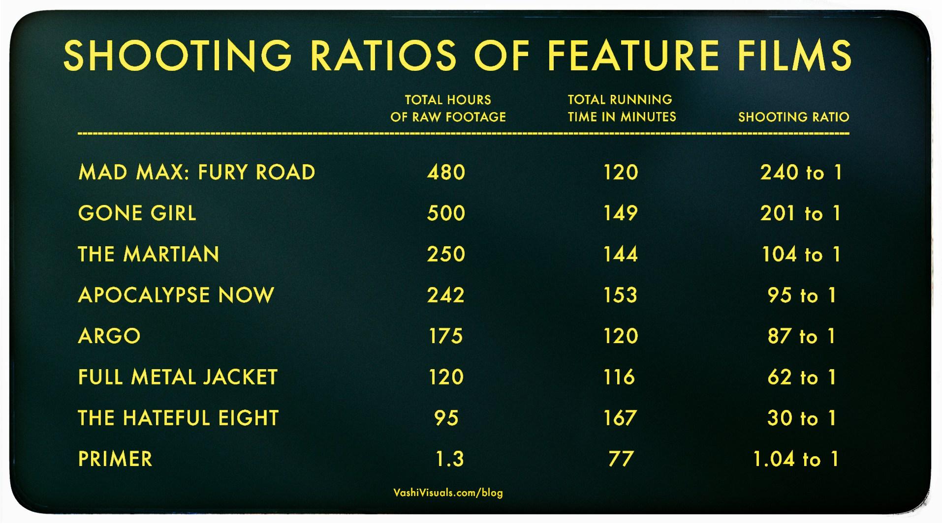

Super Members BTM_Pix Posted January 6, 2019 Super Members Share Posted January 6, 2019 There are a lot of variables in what you are looking for but here is a rough guide to storage size per min for common formats. There are a number of calculator apps available for Android and iOS that will give you an exact result for more cameras and codecs but the chart above should be enough to get you in the ballpark but the biggest variable though - and one which no calculator will get you anywhere near a solution for - is the shooting ratio. If you were doing a 10 minute UHD film shot in RAW on the BMPC 4K then it would need 123.6GB of storage (12.36 x 10) but that is if you did it in one take of course. The shooting ratio will vary wildly and make the total storage requirement many times that amount but only you will know what that ratio will be depending on the type of film it is and how you will be shooting it and numerous other different unique factors. Just as an FYI, here are the shooting ratios for some feature films. Aim for Primer but budget closer to Hateful Eight ! Grimor, thephoenix and Kisaha 3 Link to comment Share on other sites More sharing options...
kye Posted January 7, 2019 Share Posted January 7, 2019 Remember that you can always buy more drive space if a project ends up being larger than expected. Worth noting is that RAW comes in different flavours and I suspect there is very little difference between them in the real world. People talk about Prores HQ being good enough for most projects, and considering the difference between 272MB/s and 117MB/s you might end up shooting RAW 3:1 or 4:1. Quote Storage Rates Storage rates based on 30 frames per second. 4096 x 2160 CinemaDNG RAW - 272 MB/s CinemaDNG RAW 3:1 - 129 MB/s CinemaDNG RAW 4:1 - 97 MB/s Apple ProRes 422 HQ - 117.88 MB/s Apple ProRes 422 - 78.63 MB/s Apple ProRes 422 LT - 54.63 MB/s Apple ProRes Proxy - 24.25 MB/s 3840 x 2160 CinemaDNG RAW - 255 MB/s CinemaDNG RAW 3:1 - 122 MB/s CinemaDNG RAW 4:1 - 92 MB/s Apple ProRes 422 HQ - 110 MB/s Apple ProRes 422 - 73.6 MB/s Apple ProRes 422 LT - 51 MB/s Apple ProRes Proxy - 22.4 MB/s You're looking at some serious drive space though - 4K RAW 3:1 at 30:1 shooting ratio for a 90 minute film is still 20TB. That's just the source media - you will also need to render proxies to edit with, and various other assets. Link to comment Share on other sites More sharing options...

AaronChicago Posted January 7, 2019 Share Posted January 7, 2019 You can easily get away with a 3:1 ratio on narrative if you’re prepared, and rehearse. 90 min x 3 = 270 min (3TB of 4k Raw). A 4tb external drive is $99. Get one extra for backing up. kaylee 1 Link to comment Share on other sites More sharing options...
