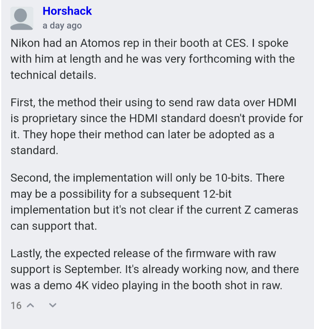

ND64 Posted January 11, 2019 Share Posted January 11, 2019 On 1/10/2019 at 1:22 AM, androidlad said: They drop the bitdepth at the time of sensor readout. Sony sensors can use 10/11/12/14bit readout for video, in the case of Nikon Z6/Z7 they only operate at 12bit for video. Readout bit depth is different from output bit depth. Atmos technical rep has said its 10bit. Probably sensors can't output 10bit at 30fps. Link to comment Share on other sites More sharing options...
androidlad Posted January 11, 2019 Share Posted January 11, 2019 1 hour ago, Eric Calabros said: Readout bit depth is different from output bit depth. Atmos technical rep has said its 10bit. Probably sensors can't output 10bit at 30fps. Source for this Atomos rep? Link to comment Share on other sites More sharing options...

ND64 Posted January 11, 2019 Share Posted January 11, 2019 @androidlad @DBounce Horshack is an engineer Z7 owner, he knows this stuff very well. The only benefit of this RAW that comes to mind is outputing image larger than 4k. Link to comment Share on other sites More sharing options...

ND64 Posted January 11, 2019 Share Posted January 11, 2019 40 minutes ago, DBounce said: Jeremy Young is the CEO and founder of Atomos... And that is where the buck stops my friend. He didn’t say it “could” do 12 bit... he said it “does”. Oh snap... you didn’t buy a P4k did you? What P4k has anything to do with this? I'm not interested in anything smaller than FF. @Django is right, CEO guy is just saying our device is capable of "receiving" 12bit signal up to 60fps. Nikon never mentioned the bit depth, or frame rate. I guess Atmos asked all camera makers to use their proprietary idea, and only Nikon let them start the development, and when they saw it works they found it a free hype generator. Link to comment Share on other sites More sharing options...

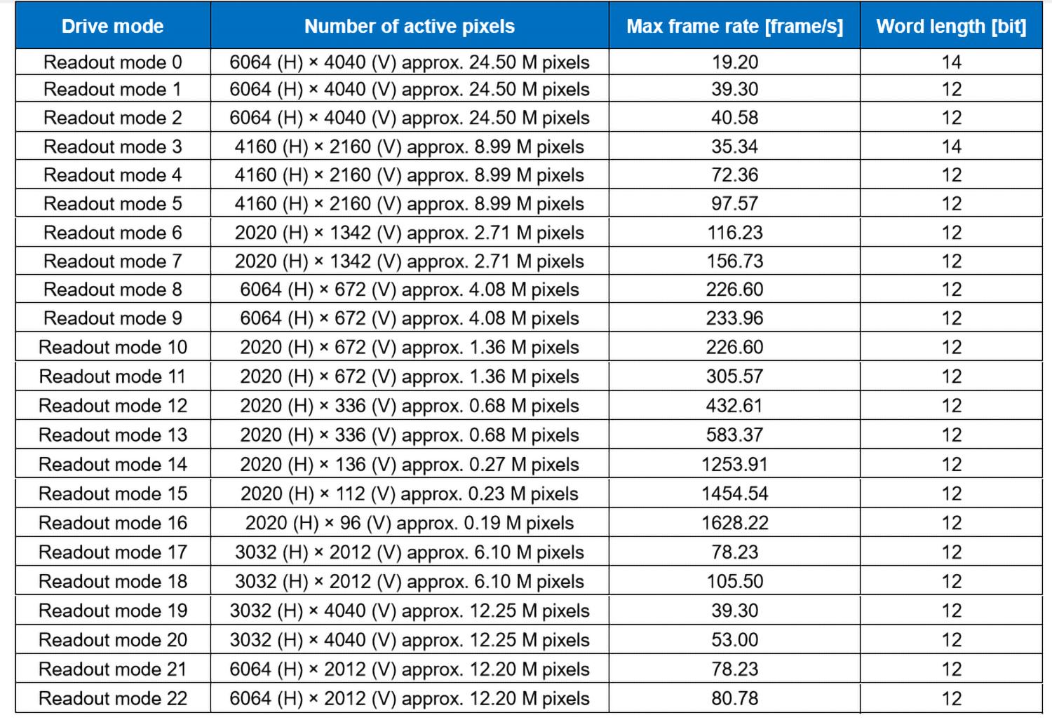

androidlad Posted January 11, 2019 Share Posted January 11, 2019 2 hours ago, Eric Calabros said: @androidlad @DBounce Horshack is an engineer Z7 owner, he knows this stuff very well. The only benefit of this RAW that comes to mind is outputing image larger than 4k. Let's use some common sense: 1. ProRes RAW is linear RAW, 10bit code values are extremely insufficient for storing linear data, you'd get severe banding. ARRI uses 12bit log RAW and Sony CineAlta uses 14bit linear RAW. 2. Z6's base sensor IMX410 does not have 10bit ADC. Link to comment Share on other sites More sharing options...

androidlad Posted January 11, 2019 Share Posted January 11, 2019 This is what the Z6 sensor IMX410 is capable of with the fast and expensive SLVS-EC interface, note that Nikon uses subLVDS which is a lot slower. If you cross reference this with Mavo LF spec, it's identical. It's also an indication of the capabilities of Panasonic S1 Link to comment Share on other sites More sharing options...
