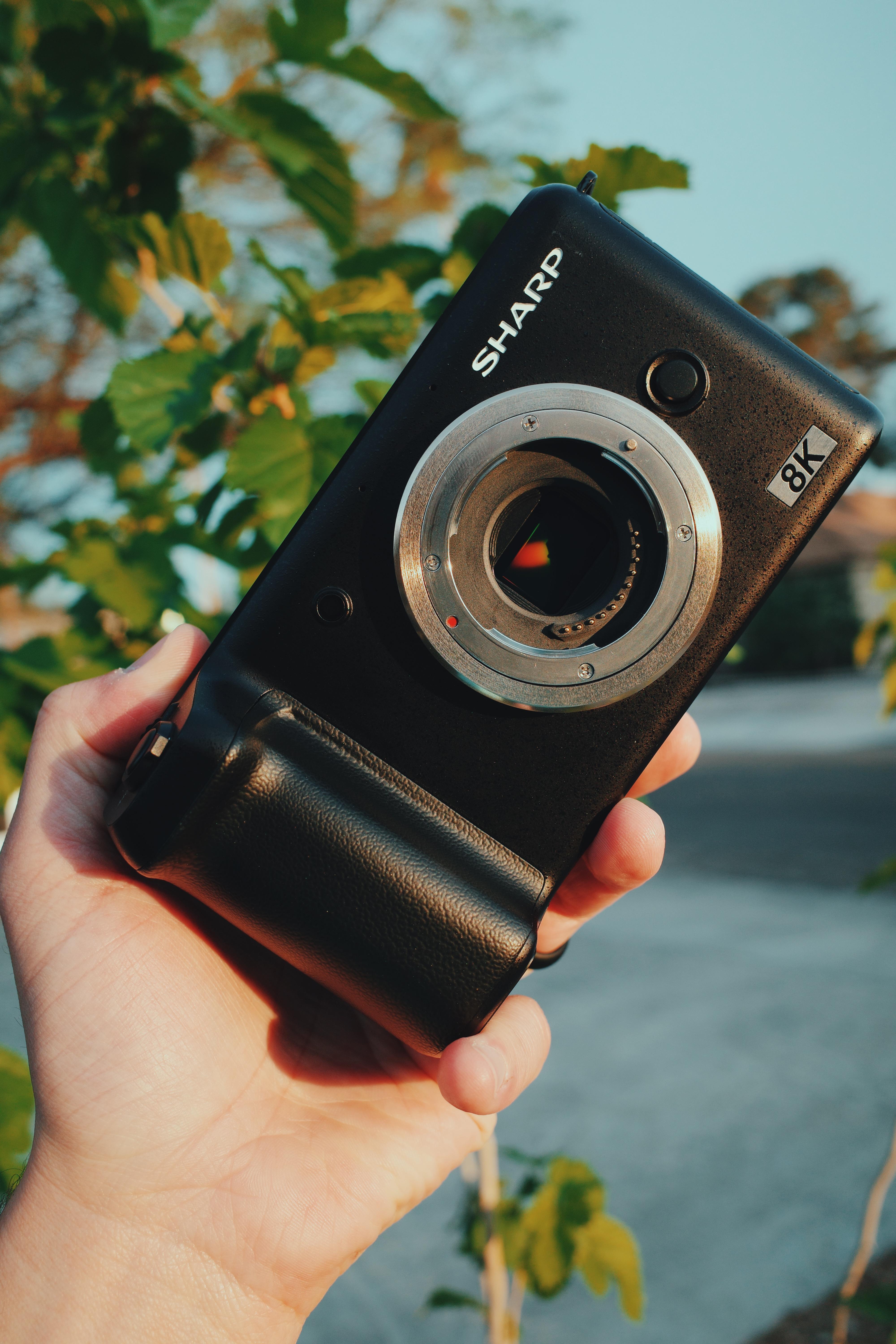

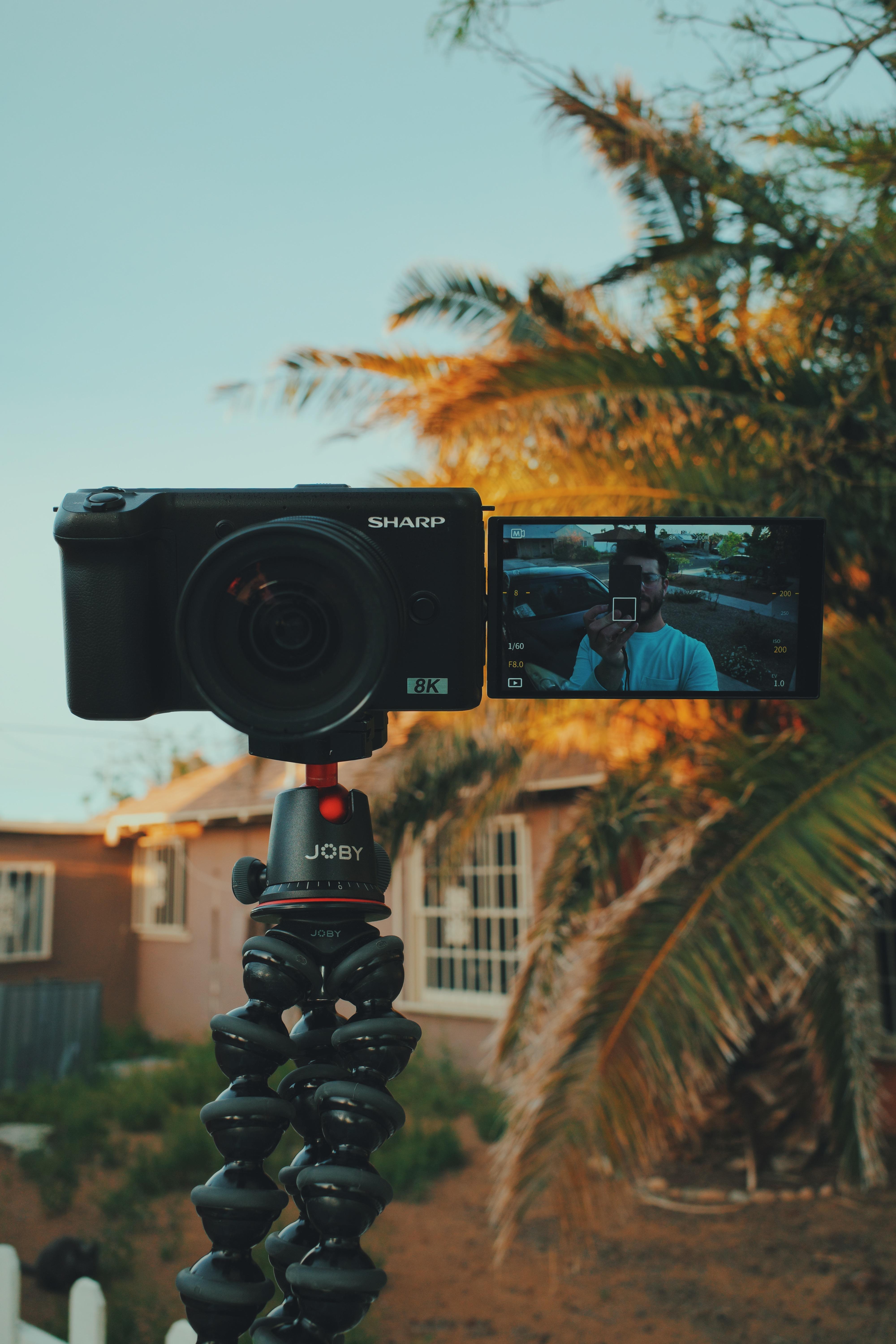

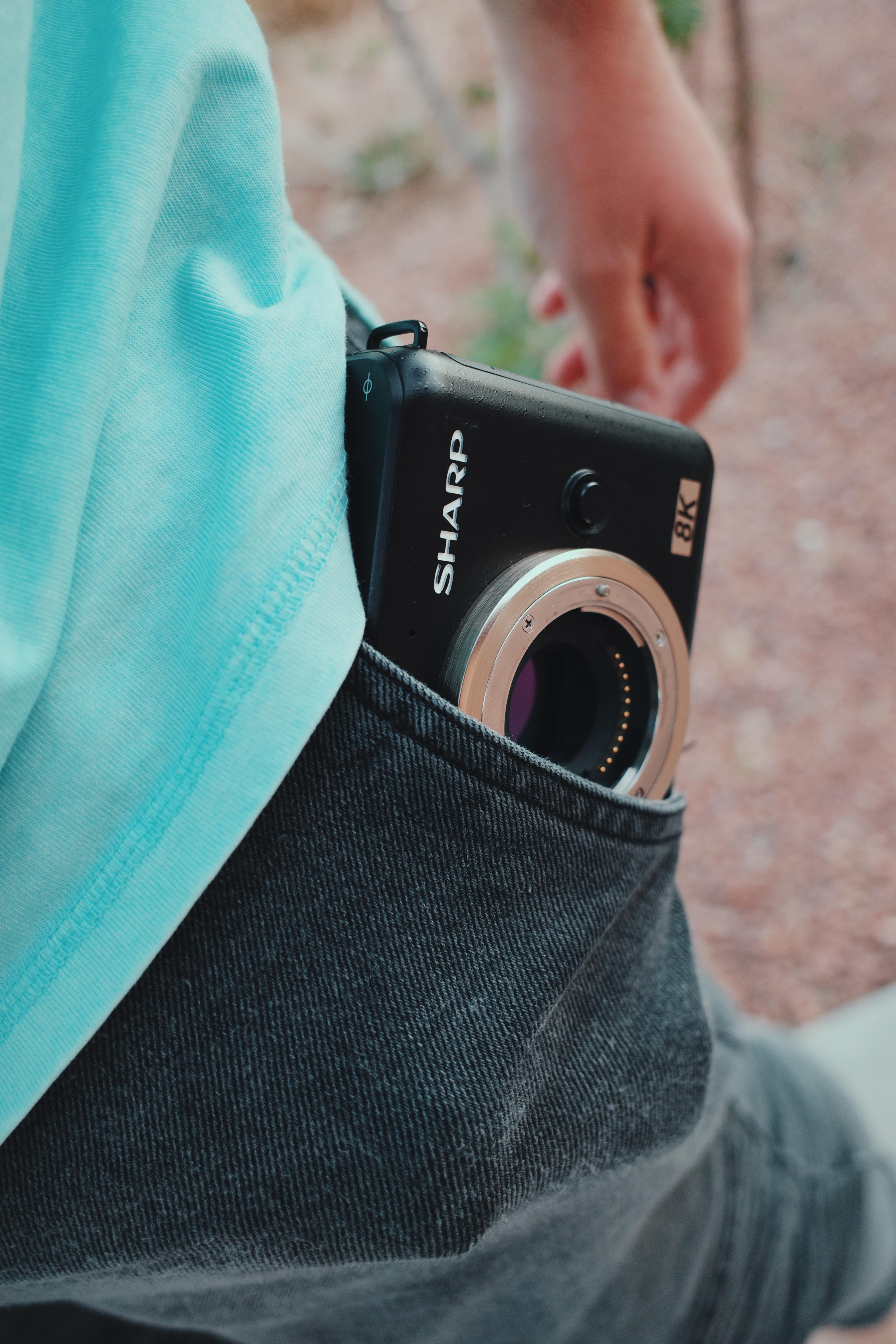

Dave Maze Posted April 8, 2019 Share Posted April 8, 2019 Had a sweet hands-on with it! Give it a minute....still transcoding! It'll click into 4k soon.... kye and ntblowz 2 Link to comment Share on other sites More sharing options...

MeanRevert Posted April 9, 2019 Share Posted April 9, 2019 If it hasn't been said already, that flippy screen is awesome! Dave Maze and Emanuel 2 Link to comment Share on other sites More sharing options...
Kisaha Posted April 9, 2019 Share Posted April 9, 2019 17 minutes ago, MeanRevert said: If it hasn't been said already, that flippy screen is awesome! ..and 5.5"! Emanuel and Dave Maze 2 Link to comment Share on other sites More sharing options...
Amazeballs Posted April 9, 2019 Share Posted April 9, 2019 Yes, that 5.5 almost bezeless FLIP-OUT smartphone-alike screen is GORGEOUS and I dont undestand why other camera manufactures dont use those kind of screens. Three key things missing for me in this camera - IBIS, high frame rates and AFC. But it is still an acheivment and I am glad that Sharp joind MFT game. Also impressed by the sensor lowlight abilities. Emanuel 1 Link to comment Share on other sites More sharing options...
