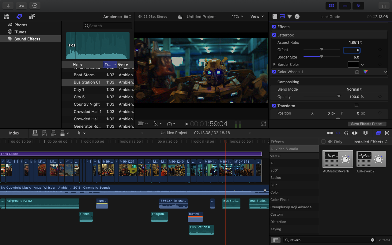

ZEEK Posted June 17, 2019 Share Posted June 17, 2019 This is what my Editing Board looks like in Final Cut PRO X. Typically the same format for all my videos. I use Davinci Resolve for the BMPCC. mercer 1 Link to comment Share on other sites More sharing options...
