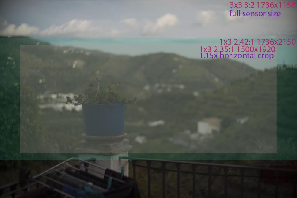

Alpicat Posted January 27, 2019 Share Posted January 27, 2019 It's incredible how much progress has been made on the EOS M in the last few months! I've tried several builds with the 1x3 binning setting but was getting corrupt footage every time, until today - with Danne's latest build I'm finally getting good results in this mode. The max res in 1x3 seems to be 1184x2000 in this build (which stretches out to 3552x2000) - I'm getting continuous shooting in 14-bit lossless. As @Brian Williams mentioned the rolling shutter is really pronounced though, and there's noticeable fixed pattern noise in the shadow areas which I hadn't seen this camera do before. Don't know if these things can be improved in future builds. Link to comment Share on other sites More sharing options...
Emanuel Posted January 27, 2019 Share Posted January 27, 2019 21 minutes ago, Alpicat said: It's incredible how much progress has been made on the EOS M in the last few months! I've tried several builds with the 1x3 binning setting but was getting corrupt footage every time, until today - with Danne's latest build I'm finally getting good results in this mode. The max res in 1x3 seems to be 1184x2000 in this build (which stretches out to 3552x2000) - I'm getting continuous shooting in 14-bit lossless. As @Brian Williams mentioned the rolling shutter is really pronounced though, and there's noticeable fixed pattern noise in the shadow areas which I hadn't seen this camera do before. Don't know if these things can be improved in future builds. What about 1504x1920? Not continuous without dropped frames? Link to comment Share on other sites More sharing options...
ZEEK Posted January 27, 2019 Share Posted January 27, 2019 6 hours ago, Emanuel said: Why don't you variably shoot with 1x3 binning mode as well? I have tried it out, but am not having luck so far with the live view and the purple frames. I will give it more time and see how everyone is doing with it. But it definitely looks like a great step forward, although I am quite happy with the build I am using now. 2 hours ago, Alpicat said: It's incredible how much progress has been made on the EOS M in the last few months! I've tried several builds with the 1x3 binning setting but was getting corrupt footage every time, until today - with Danne's latest build I'm finally getting good results in this mode. The max res in 1x3 seems to be 1184x2000 in this build (which stretches out to 3552x2000) - I'm getting continuous shooting in 14-bit lossless. As @Brian Williams mentioned the rolling shutter is really pronounced though, and there's noticeable fixed pattern noise in the shadow areas which I hadn't seen this camera do before. Don't know if these things can be improved in future builds. Great News Aplicat! Link to comment Share on other sites More sharing options...
Alpicat Posted January 27, 2019 Share Posted January 27, 2019 8 hours ago, Emanuel said: What about 1504x1920? Not continuous without dropped frames? With the latest build Danne posted the max resolution that I can set is 1184x2000 (i.e. 3552x2000) in 1x3 mode - I don't know why, maybe beyond that it becomes too unstable and he set that limit, or maybe I'm doing something wrong - but for me it's a nice resolution, it comes out exactly as 16:9 aspect ratio. Link to comment Share on other sites More sharing options...
Nikkor Posted January 27, 2019 Share Posted January 27, 2019 11 minutes ago, Alpicat said: With the latest build Danne posted the max resolution that I can set is 1184x2000 (i.e. 3552x2000) in 1x3 mode - I don't know why, maybe beyond that it becomes too unstable and he set that limit, or maybe I'm doing something wrong - but for me it's a nice resolution, it comes out exactly as 16:9 aspect ratio. When you use the ratio presets it reduces resolution. Danne went for resolutions that are stable. If you turn off the ratio setting in the crop module it will record full resolution. Link to comment Share on other sites More sharing options...
Alpicat Posted January 27, 2019 Share Posted January 27, 2019 3 hours ago, Nikkor said: When you use the ratio presets it reduces resolution. Danne went for resolutions that are stable. If you turn off the ratio setting in the crop module it will record full resolution. That makes sense, thanks for letting me know! I've tried the 2.35:1 ratio preset recording at 1504x1920 but I'm getting quite a few pink frames unfortunately. Link to comment Share on other sites More sharing options...
Nikkor Posted January 27, 2019 Share Posted January 27, 2019 29 minutes ago, Alpicat said: That makes sense, thanks for letting me know! I've tried the 2.35:1 ratio preset recording at 1504x1920 but I'm getting quite a few pink frames unfortunately. I'm getting pinkframes when the buffer is running low and that usually happens when a lot of highlights are in the scene because data increases a lot. Link to comment Share on other sites More sharing options...
Alpicat Posted January 27, 2019 Share Posted January 27, 2019 That must be it. I guess the best way to avoid it is lowering the resolution slightly. Link to comment Share on other sites More sharing options...
Emanuel Posted January 27, 2019 Share Posted January 27, 2019 3 hours ago, Nikkor said: I'm getting pinkframes when the buffer is running low and that usually happens when a lot of highlights are in the scene because data increases a lot. So no highlights or under control underexposing a bit, no pinkframes? The same using ratio presets? What's the percentage average you get with along of usable footage you are able to find in the end going on 1504x1920 1x3 binning mode? And what's the safest highest resolution for 2.35:1 continuous 24p or 25p? Link to comment Share on other sites More sharing options...
Nikkor Posted January 27, 2019 Share Posted January 27, 2019 4 minutes ago, Emanuel said: So no highlights or under control underexposing a bit, no pinkframes? What's the percentage average you get with along of usable footage you are able to find in the end going on 1504x1920 1x3 binning mode? And what's the safest highest resolution for 2.35:1 continuous 24p or 25p? The safest is to try oneself, I would rather shoot lower res than to underexpose, because the little camera gives bad colors,etc.. when underexposed. But the RS is so bad, you don't want to use this for anything other than static landscape shots. I think it's a good alternative for when the standard 3x3 binning mode struggles with aliasing (landscape shots) Btw, could anyone share a compiled MLV version, I can't compile it and the latest official compiled exe doesn't have the stretch options to oversample. Thanks!!! Windows and/or Mac OSX Link to comment Share on other sites More sharing options...
