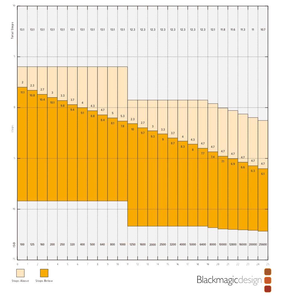

drm Posted January 24, 2019 Share Posted January 24, 2019 12 hours ago, Shirozina said: This is not true. The low ISO's compress the shadows and put more tonal data in the highlights and the higher ISO's expand the shadows and compress the highlights. This is clearly evident on the scopes of a monitor or in an NLE. The attached chart is directly from Blackmagic Design for the BMPCC4K. I may have worded my original message poorly, but Blackmagic shifts the middle grey point up or down based on the ISO when not recording RAW. With lower ISOs in the range, there are more points below the middle grey, with higher ISOs there are more points above the middle grey point. Quote Link to comment Share on other sites More sharing options...

Shirozina Posted January 25, 2019 Share Posted January 25, 2019 9 hours ago, drm said: The attached chart is directly from Blackmagic Design for the BMPCC4K. I may have worded my original message poorly, but Blackmagic shifts the middle grey point up or down based on the ISO when not recording RAW. With lower ISOs in the range, there are more points below the middle grey, with higher ISOs there are more points above the middle grey point. Notice how the DR stays the same throughout the ISO ranges? This means BM is not varying the ISO like other cameras by digitally amplifying the whole signal but is altering the mid point in the response curve using a gamma like change. Cycle through the ISO at a constant exposure and see how the data moves on some scopes and you will understand. The above chart looks like they have made an exposure change for each ISO which is misleading. Look at any other camera DR vs ISO graph and the DR ramps down as ISO goes up just as in practice if you ETTR you need to change your exposure with ISO. Not so with the BM where the clipping point remains at the same exposure value throughout the ISO range. Quote Link to comment Share on other sites More sharing options...
drm Posted January 25, 2019 Share Posted January 25, 2019 2 hours ago, Shirozina said: Notice how the DR stays the same throughout the ISO ranges? This means BM is not varying the ISO like other cameras by digitally amplifying the whole signal but is altering the mid point in the response curve using a gamma like change. Cycle through the ISO at a constant exposure and see how the data moves on some scopes and you will understand. The above chart looks like they have made an exposure change for each ISO which is misleading. Look at any other camera DR vs ISO graph and the DR ramps down as ISO goes up just as in practice if you ETTR you need to change your exposure with ISO. Not so with the BM where the clipping point remains at the same exposure value throughout the ISO range. @Shirozina thanks for your reply. It is a shame that we couldn't discuss this over a beverage It would be so much easier and faster. I know that BM says that the dynamic range doesn't change as you change ISO within each range (100-1000, 1250-6400), they claim they are moving the middle grey point. That is why I posted the chart. My original comment was: "...a lower ISO in the 100-1000 range and a lower ISO in the 1250-6400 range shows more details in the shadows. The ISOs in the higher end of each range do a better job preserving detail in the highlight areas." to which you said: "This is not true. The low ISO's compress the shadows and put more tonal data in the highlights and the higher ISO's expand the shadows and compress the highlights. This is clearly evident on the scopes of a monitor or in an NLE. " (emphasis added) I posted the chart because you said that my original comment was not true. QUESTION: So, suppose that you are recording a landscape shot that includes clouds on a bright day and you want to emphasize detail in the clouds. What ISO should we use? With many other cameras, I would pick a low ISO to get the most dynamic range, then adjust the camera settings so the highlights are just below clipping. With the BMPCC4K, what ISO should we choose? If we are recording RAW, I suggest that we choose the 100-1000 ISO range to maximize dynamic range then expose so we aren't clipping the highlights. What if we are not recording RAW? What ISO would you suggest that someone use when recording this scene on the BMPCC4K, when not recording in RAW, in order to have the most detail in the highlights? Quote Link to comment Share on other sites More sharing options...
Shirozina Posted January 25, 2019 Share Posted January 25, 2019 Hum - beer......? If you need to retain highlights without clipping then first of all ETTR is naturally the best exposure method and if in addition to this you want a lot of tonal information in those highlight areas then a low ISO with it's flatter response curve allocates more data in the upper end of the response curve. DR remains the same so it's just about placing the most data where you want the most tonal detail and with the P4k once you have got an ETTR exposure just under clipping you can change the ISO and highlights will remain unclipped (as long as you use scopes and not the Zebras). On the other hand if you want to avoid clipping the clouds but want to show a lot of shadow detail then I'd be setting a high ISO that allocates more data in the lower levels and compresses the highlights into less data. With RAW it doesn't matter as long as you ETTR at native ISO but RAW is not truly RAW on the P4k as it still has a tonal response curve baked into the data so I'd still want to get this curve as close as possible in camera to the required output. Obviously for maximum DR I'd use the lower of the 2 native ISO ranges. I need to photograph a stepped density chart from black to white using the same exposure but different ISO to show the change in the response curves. Again I have to state that to do this properly you need to use scopes as ETTR with the Zebras away from 400 and 3200 doesn't appear to be very accurate. Quote Link to comment Share on other sites More sharing options...
