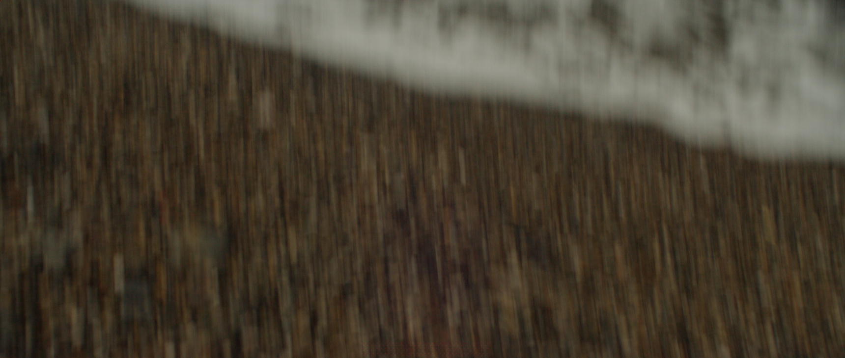

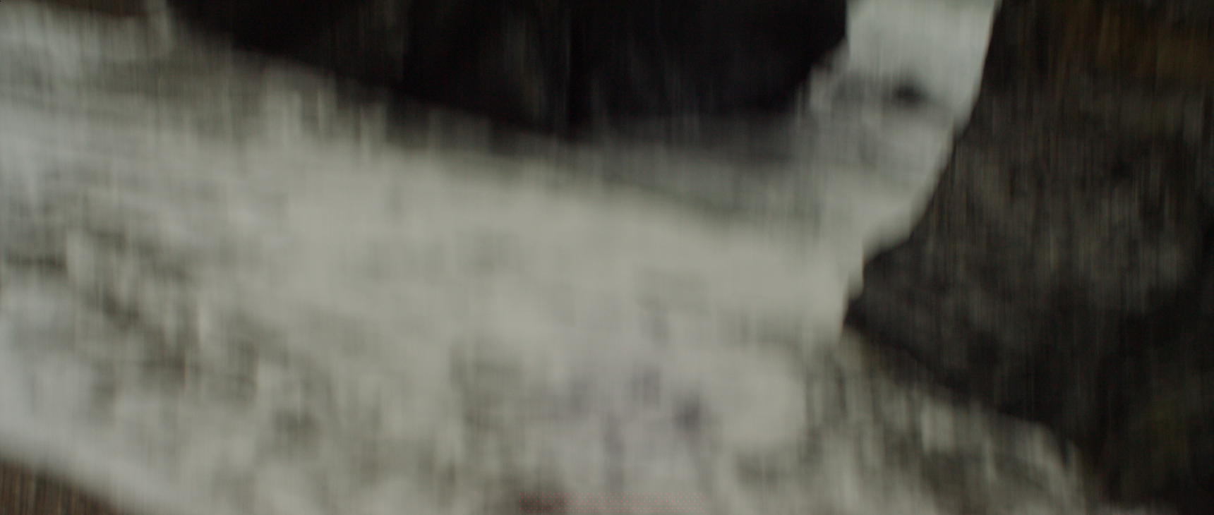

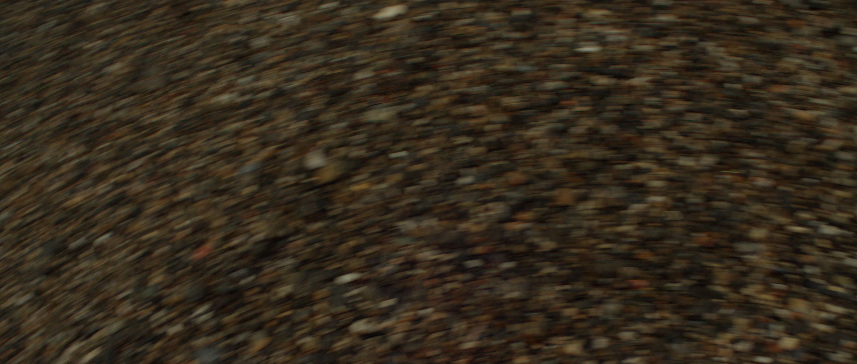

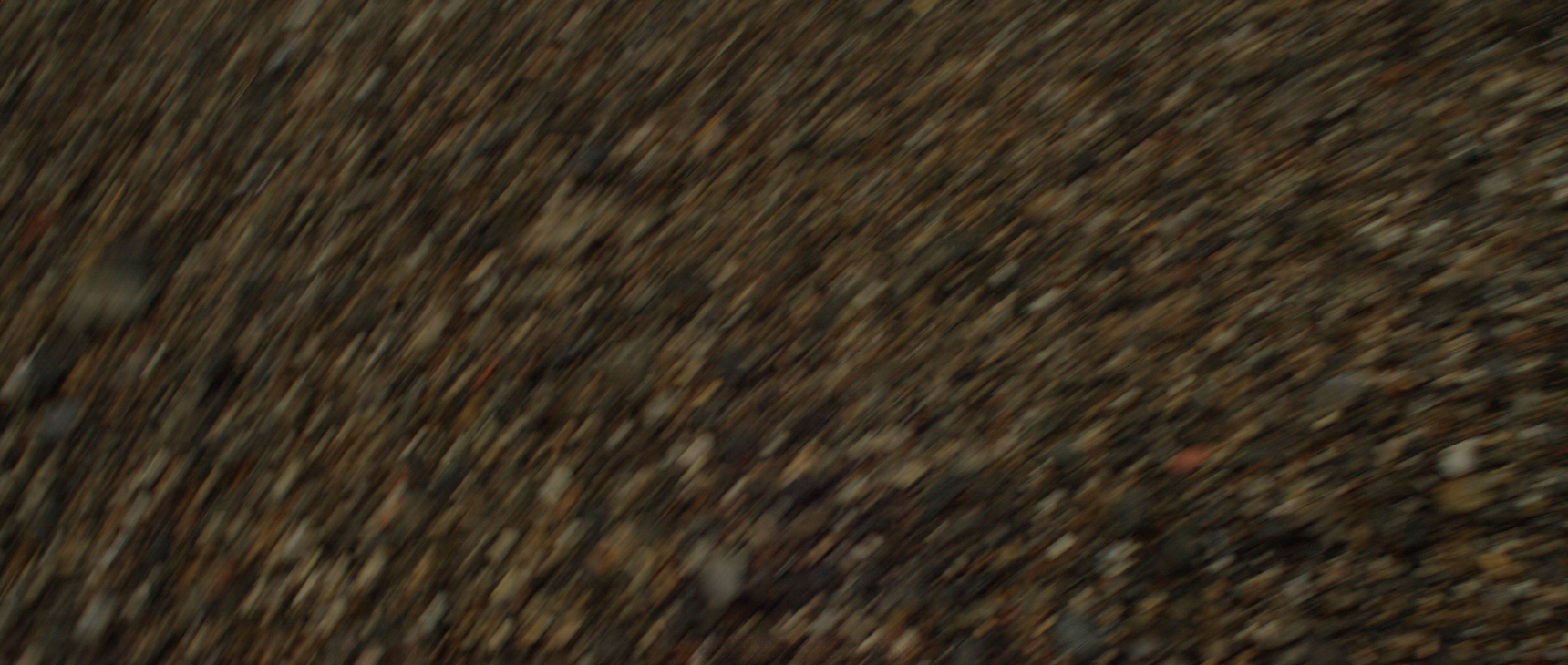

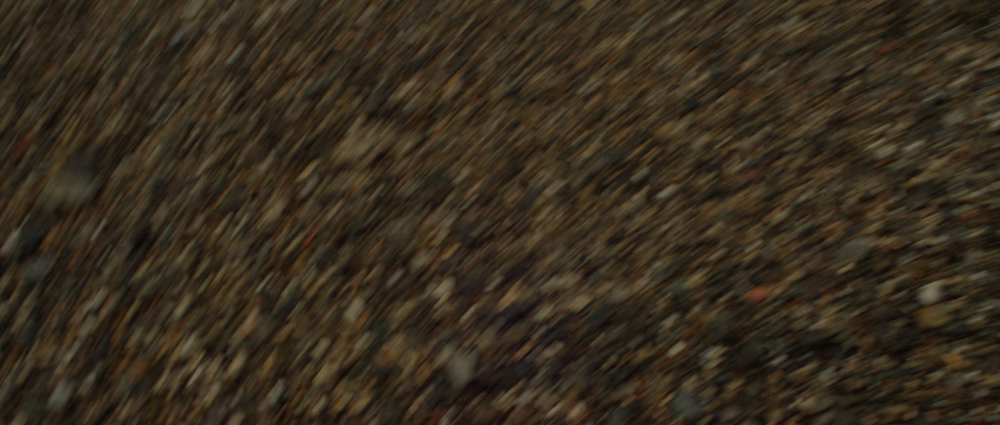

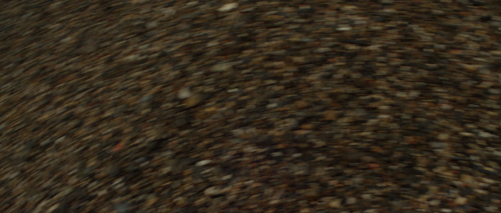

I've always asked me the same, and it's true, in RAW footage the motion blur looks really epic, I often find myself admiring and extracting blur Frames out of sequences.
No real answer but I find that following the 180 degree shutter rule and recording raw Never looks choppy no matter how Hard the Pans are.
