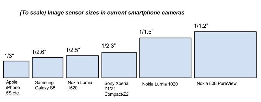

webrunner5 Posted February 2, 2019 Share Posted February 2, 2019 Only 10 or 12 bits. A little bit better than 2K output. "Key Specifications Model nameIMX490 Number of effective pixels2896 (H) × 1876 (V), approx. 5.4 megapixels Image sizeDiagonal 10.36mm (type 1/1.55) Unit cell size3.0μm (H) × 3.0μm (V) Frame rateFull pixelAD10bit 40fps, AD12bit 30fps Sensitivity (F5.6 standard value, 1/30 second storage time)2,280mV (green pixel) Dynamic range (EMVA 1288 standard)120dB (140dB when prioritizing dynamic range) Power supplyAnalog3.3V Digital1.8V1.1V Interface1.1V1.8V InterfaceMIPI CSI-2 serial output (4 lane / 2 lane) Package124pin plastic BGA Package size15.35mm x 11.68mm" Sensor size. 1/1.5. Not too bad. Smartphone size I guess. Quote Link to comment Share on other sites More sharing options...
