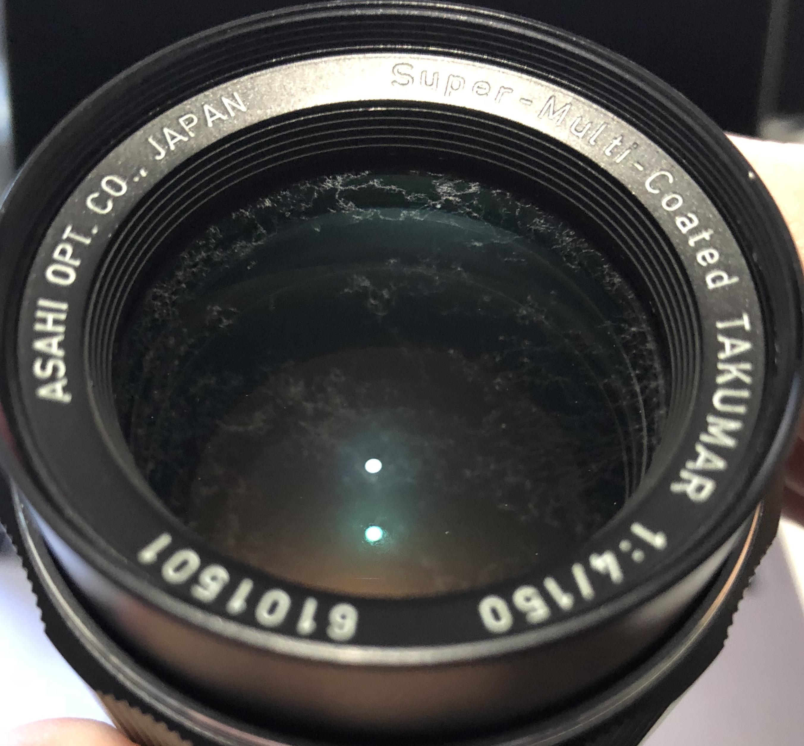

kye Posted January 29, 2019 Share Posted January 29, 2019 I've gone a little crazy and ordered a bunch of cheap vintage lenses, some with fungus in them. I've ordered some without fungus, but I'm not 100% that they won't contain any, and cleaning them is probably a good idea anyway, so I'm kind of jumping in at the deep end, and I thought I'd just make a new thread to compile my notes etc. This might be useful because in my reading I've discovered that there are a bunch of threads online about cleaning fungus where people don't know the first thing about anything, so they're just full of BS basically. Here are some interesting links and notes I've gathered so far: Alcohol, vinegar, consumer grade acids, UV from the sun or otherwise, aren't effective (or will damage the lens if concentrated) says a microbiologist, and they recommend caustic soda (Sodium Hydroxide) (source) This is a nice tutorial on how to do it and they recommend Hydrogen Peroxide and Household Ammonia (source) Sodium Hydroxide / caustic soda is widely available, but is a powder and must be dissolved to be used, unfortunately neither of the above talk about concentrations to use. Adding it to water also creates a lot of heat, risking splashing, so it's not nice or safe stuff to work with. I've looked for tips from a lens maintenance person and unsurprisingly I couldn't find anyone that would give away trade secrets for free. It's kind of difficult to tell who knows what as lots of people say "I did X and it worked" but the consensus is that storing lenses without lens caps in a relatively well-lit room will prevent fungus growth, so these people might be completely full of it and just have a well-lit room. You can never fully cleanse lenses of fungus (or protect them from it in use either) so you need to view every lens as potentially contaminated and store them somewhere there is light available and is dry. Leaving lens caps off and using a desiccant are commonly recommended strategies. Some suggest using cheap filters instead of lens caps but your mileage may vary. More research is required. The lens tear-down videos I've watched show that many of these old lenses were designed to be serviced and that you can get to the optics without having to mess with the sensitive aperture mechanisms which is really cool. Only one of my fungus lenses has arrived so far, but here's a shot of my new friend.... No, the lens isn't cracked, that's just the edge of the rear of the lens being lit up by the torch. Apart from the colony the lens is super nice, and basically looks new. Anyone else taken the plunge with cleaning lenses? heart0less 1 Quote Link to comment Share on other sites More sharing options...

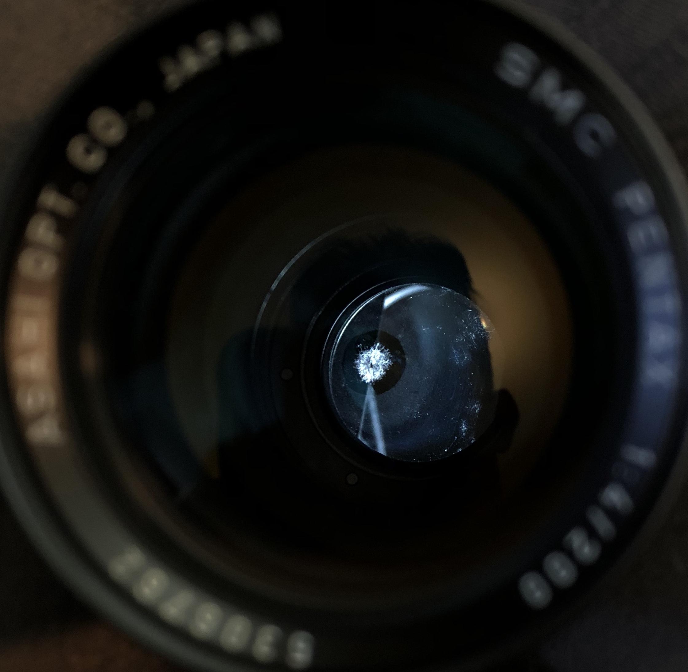

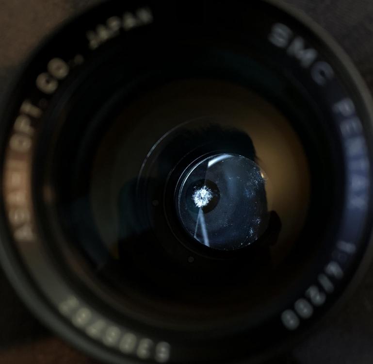

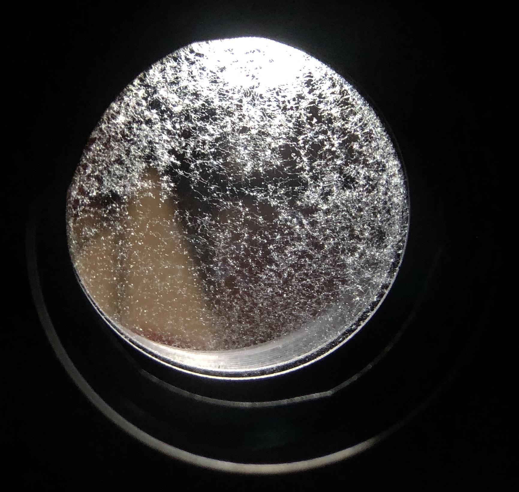

kye Posted January 30, 2019 Author Share Posted January 30, 2019 13 minutes ago, Mako Sports said: I heard once a lens has fungus it can never be 100% removed as it will just grow back.. I think that's because the spores get into all the grooves and mechanisms. Of course, non-infected lenses can become infected at any time just by sucking in a spore during normal use. Ultimately it's about keeping them in such a way that prevents the fungus already inside them from growing. Dry and exposed to light is the way to go. My second infected lens arrived. Looks like a different type, and has a lot more coverage, but perhaps with smaller colonies than the last one. It's important to have variety in life I think. The front elements: The back elements: This lens is also as new. From same seller, so I suspect from the same source. This one came with a lens hood! Quote Link to comment Share on other sites More sharing options...
webrunner5 Posted January 30, 2019 Share Posted January 30, 2019 Wow that one is the poster child for fungus on the rear element! Yikes. Quote Link to comment Share on other sites More sharing options...
kye Posted January 30, 2019 Author Share Posted January 30, 2019 8 minutes ago, webrunner5 said: Wow that one is the poster child for fungus on the rear element! Yikes. You'd be surprised. I already own these lenses and so am taking photos to highlight the fungus. Many ebay auctions don't shine a light into the lens so you can only just tell that there's fungus there - notice how the auctions all say something like "the photographs are part of the description of the lens, please make sure you check them before purchase". Lots of the auctions don't even have photos through the glass at all. This one is interesting.... it's from a current live auction, and it's going for about three times the price of previous fungus-free items. Quote Link to comment Share on other sites More sharing options...
