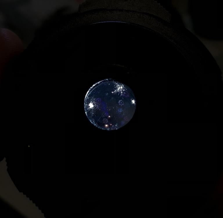

kye Posted January 31, 2019 Author Share Posted January 31, 2019 15 hours ago, hansel said: Keep infected glass away from the others!!! 13 hours ago, Márcio Kabke Pinheiro said: And important - never store a lens with fungus in the same container of the clean one, they can spread. 9 hours ago, mercer said: And never put a lens infested with fungus on your camera... it can spread to your sensor. I don't think this is how it works. Yes, they can probably spread, but I get the impression that viewing infected lenses as contagious and the rest of the world as sterile is missing the point. All the articles (including that one from Zeiss) say that fungus is everywhere, in the air. Ask yourself how the spores got to where they are in these lenses - between two glass elements with only a tiny gap between them. I'm pretty sure that fungus spores can't move, so this is where the spore landed. This is a fun article: https://www.uni-mainz.de/presse/13180_ENG_HTML.php Quote On average, there are between 1,000 and 10,000 fungal spores in every cubic meter of air. So, either you never take your camera out of the box (actually, they don't box them in a clean room - too late!) or you just store things so that they don't grow. 8 hours ago, CyclingBen said: As far as letting the solution sit, on the bottle (I looked online) it said for fungus to let it sit for 10 minutes (same as for killing MERSA). If I were to use it I would probably follow those instructions, the next time I go to the store I will ask him. Looks like the main ingredient is Hypochlorous Acid. Maybe there is another product in your area that has it in there. Otherwise I’d be happy to ship you some, though it’s -33 Celsius here today without the wind chill... I'm kind of tempted to use the other ingredients as they have them in the grocery store, and whatever I post here will be useful to more people when I work out the concentrations etc. It would be nice for this thread to be the one I was looking for, instead of the blind-leading-the-blind threads or only-half-the-information-required tutorials. hansel 1 Link to comment Share on other sites More sharing options...

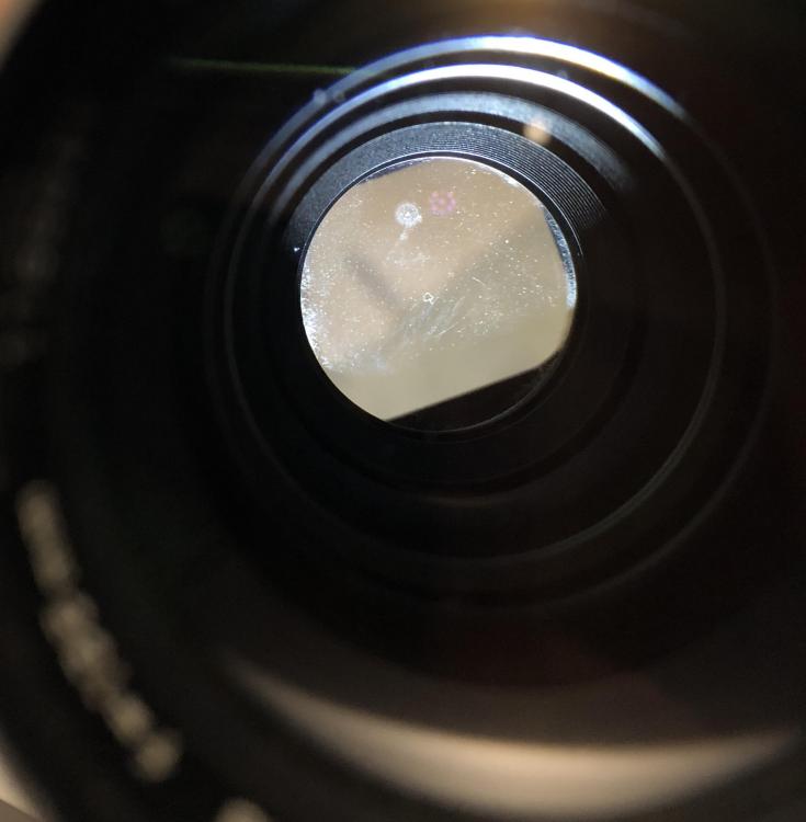

kye Posted February 14, 2019 Author Share Posted February 14, 2019 More lenses have been arriving.. Super-Takumar 35mm 3.5 - ebay auction specified fungus: and some with fungus that didn't specify it in the ebay ad.... I figured there's always a chance of them having it, so it's not a problem, but buyer beware! Minolta 135mm 2.8: (Note that the little 9-dot pattern is from the LED torch I was using, so they're just reflections, not fungus colonies!) The Minolta 200mm 3.5 also has some patches that look like greasy smudges on the front element, but further investigation shows they're on the inside of the front element, so I suspect fungus with that too. I tried taking a photograph but couldn't get the angles right, it's quite faint and you need light from a certain angle etc. My hygrometer says that my lens storage drawer sites between 65% and 40% humidity, even though we have refrigerative air conditioning on many hours a day (it's peak summer here). I'm not sure if that's acceptable, but the Zeiss page here says: Quote Where does fungus come from? Fungus spores are everywhere and germinate under suitable environmental conditions: Growing conditions Relative humidity of at least 70% (more than 3 days) No or little airflow Darkness Nutrients (textile lint, traces of grease, varnish, dust and dirt) Temperatures between 10 and 35°C How can fungus be avoided? Reduce the relative humidity to less than 60% (never under 30% as it is dangerous for the instrument) by storing: in climate-control cabinets in which hygrometers maintain environmental conditions next to driers (e.g. silicagel orange packs) in the containers in a special cabinet whose interior is heated to 40°C (max. 50°C) using a fan heater/ incandescent lamps, thereby reducing the relative humidity in hermetically sealed cabinets with fungicides with high vapor pressure (fungicide depot must be replaced at regular intervals) in an dehydrator above driers After the work is done, Immediately clean the instruments. If possible, you can use a fan to facilitate evaporation of surface moisture. Do not use containers made of leather, textiles or wood for storage. Short solar radiation or irradiation with UV light may also help avoiding fungus. These seem a little contradictory, so I think more reading is needed. Once all my lenses arrive I'll begin the cleaning process in earnest. No point cleaning a bunch only to have another one arrive and you have to set it all up over again. Link to comment Share on other sites More sharing options...

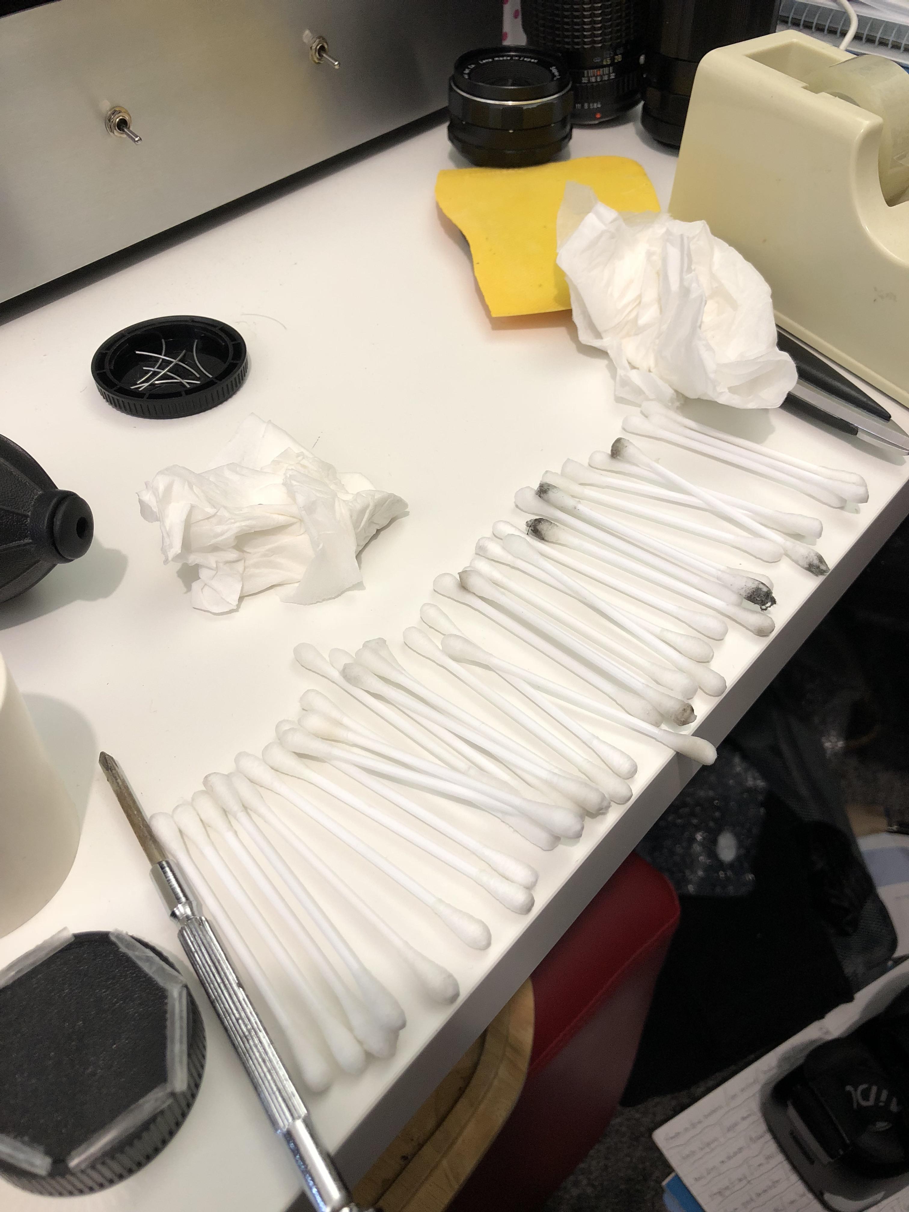

kye Posted February 22, 2019 Author Share Posted February 22, 2019 The $7 Petri 135mm f3.5 was the first to have cleaning attempted, and holy wow did it need it. It was absolutely filthy. There's a lot of discussion online about how Petri lenses are high quality Japanese lenses, but are "uncleanable" because the manufacturer glued the screws in, and even things like soaking them in acetone for days doesn't loosen them. Someone broke a screwdriver trying to get one apart. Luckily I had no problems with the screws on this one.. Unfortunately, I had two kind of trouble, the first was that I couldn't get the front element out. I tried the old elastic bands and a lens rear cap, I tried PVC pipe and blu-tak (bad idea, it just gets pushed into the grooves), lens caps and tape, nothing would make it move. This is a pity because there is fungus between the front and next element. I was able to clean the back of the second element, which was filthy - it looked like someone had wiped the kitchen and bathroom benches and then tried to wipe this out. Soapy water and rinse cycle of distilled water got it nice and clean. Then the last element came out ok, but unfortunately it was actually two elements glued together as one lens, and naturally the filth was in-between them, so game over at my current skill level. You can see it a bit in the pic above. However, I was able to clean both sides of that, which was also needed. Now it's back together again and still works! Bonus!! Did I mention it was dirty? Link to comment Share on other sites More sharing options...

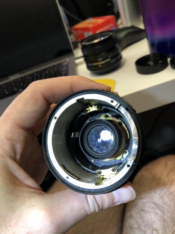

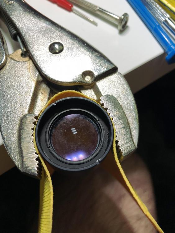

kye Posted February 24, 2019 Author Share Posted February 24, 2019 Just dismantled, cleaned, and re-assembled four lenses. Three of them still work! The normal way to disassemble a lens is to take some of the elements out of the front, and some out of the back, and there might be a third group in the middle somewhere a bit deeper. So, I took the back off the Minolta 135/2.8 and then unscrewed the rear lens group, which came free from its thread but there was no way to grip it and pull it up, so I then did what any normal person would do, I put a cloth over the top and turned it upside-down. The rear lens group came out, but unfortunately so did 6 curved pins and 4 of the smallest ball-bearings I've ever seen (maybe 1mm diameter?). The ball-bearings didn't concern me (look - I de-clicked the aperture without even trying!) but the pins were a bit worrying. I was taking photos as I disassembled but nothing showed these pins, and long story short, they play some crucial role in the aperture. So I now have a Minolta 135mm fixed at f2.8. Focus still works fine and image looks great but no stopping down unfortunately. To be fair it's pretty sharp wide open and it was a pretty knackered sample of that lens anyway - full of dirt, fungus spots, and the focus has no friction to it, it just moves like it's not connected and then stops. So if I decide that that is the lens for me (I had already decided it was a keeper unfortunately) then I can use it at 2.8 or buy another one and not take that one apart. TBH I'm a bit annoyed that the aperture mechanism wasn't a little better designed. That was the fourth lens I took apart and the others were just fine. Maybe it was broken in some way but who knows. Anyway, I learned a bunch of things, including that fungus spots are easily cleanable with a weak mixture of dish-soap and water. I also learned that with distilled water and an air blower you can clean a lens until it is invisible, even if you shine a LED torch right through it. Link to comment Share on other sites More sharing options...
