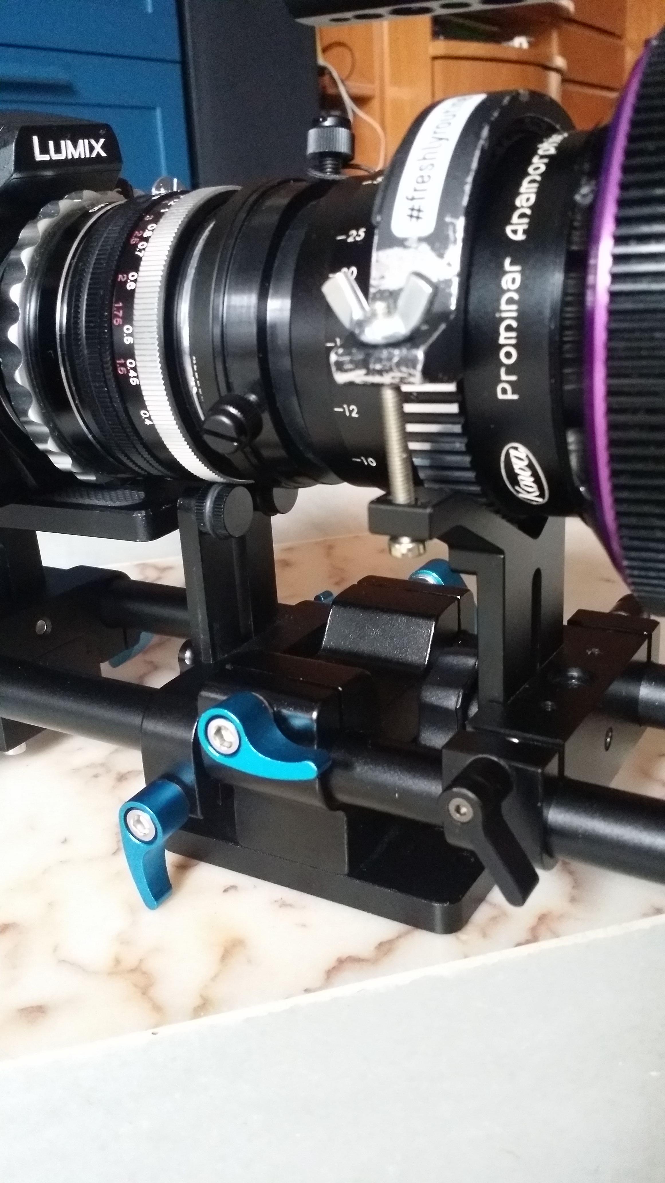

Grimor Posted January 31, 2019 Share Posted January 31, 2019 Well, i store anamorphic and taking lens rigged together with rods and supports. And this way i really dont move it so much. You can see i use 2 long lens supports: one blocks the taking focus and the other one block anamorphic aligment and focus. CfFilmmaker and Ian Edward Weir 2 Link to comment Share on other sites More sharing options...

ultra909 Posted March 1, 2019 Share Posted March 1, 2019 probably depends on which clamps you use. vid-atlantic are general purpose ones but can't say they are super durable. I would also use extra clamps to lock anamorphic lens to infinity forever as focusing with rangefinder also alters lens alignment, I used electrical tape to lock anamorphic adapter but whole construction is still wobbly. or use a few lens supports as mentioned above, anyway using rangefinder without rails and follow focus is difficult because of wide range throw Link to comment Share on other sites More sharing options...
