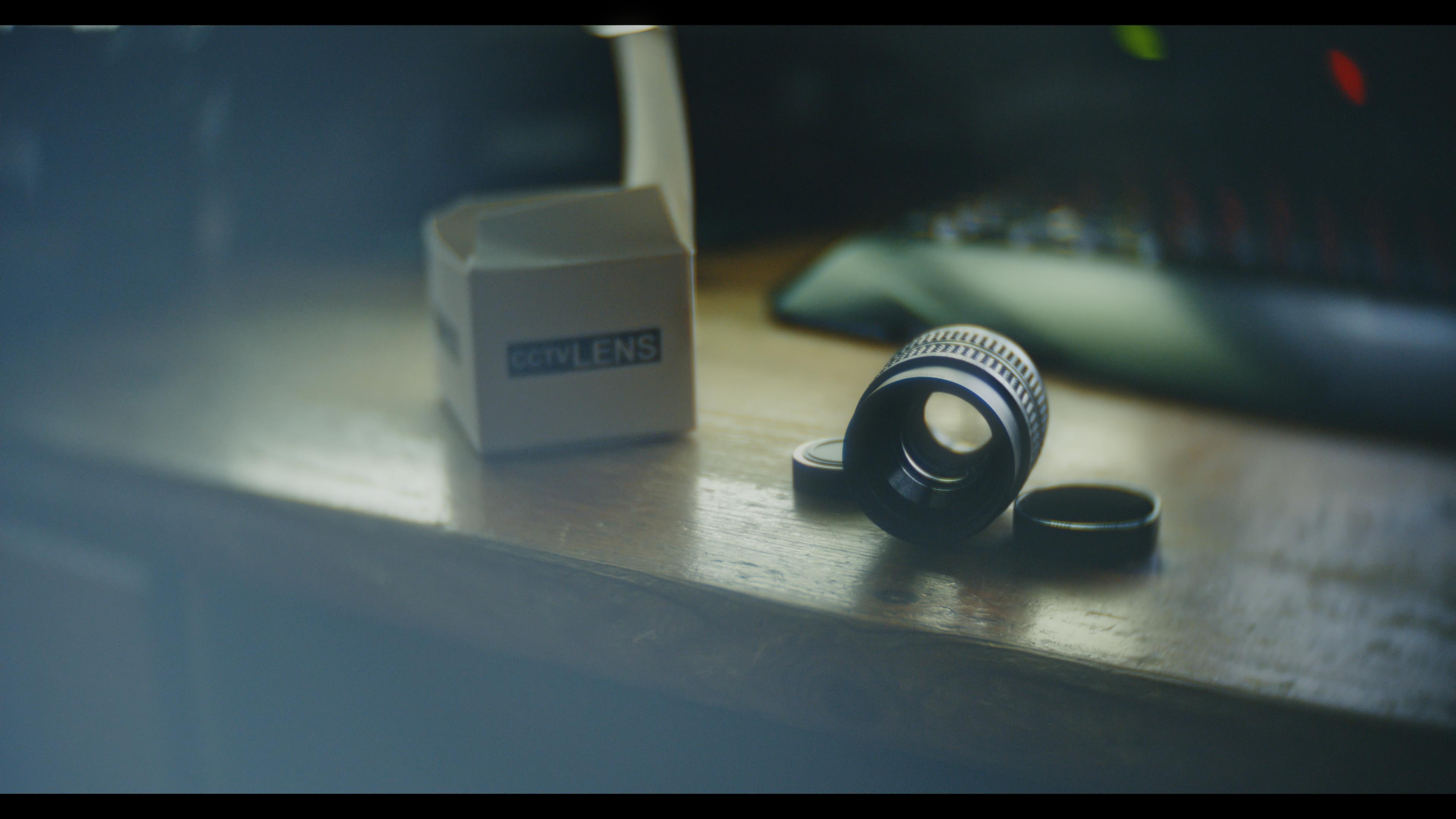

Ehetyz Posted February 2, 2019 Share Posted February 2, 2019 I don't think the P4K sharpens in-camera. Post-blurring might help make it look more vintage but also just using vintage/lower res lenses does the trick of not making it feel too sharp. Here's a test shot with a CCTV lens, Fujian 24/1.4. kye, Emanuel, Goose and 1 other 4 Link to comment Share on other sites More sharing options...
