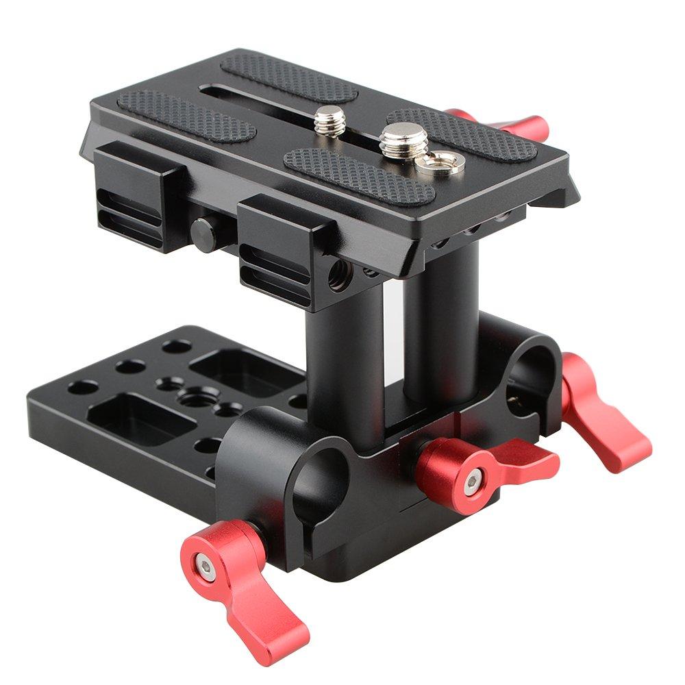

Super Members BTM_Pix Posted February 2, 2019 Super Members Share Posted February 2, 2019 This Camvate one is OK and great value for £35. Takes standard Manfrotto QR plates (they do an Arca Swiss version as well) to swap the cameras and has adjustable rail height for the lens support. https://www.amazon.co.uk/dp/B0749MLGHG zerocool22 1 Link to comment Share on other sites More sharing options...
zerocool22 Posted February 2, 2019 Author Share Posted February 2, 2019 It is quite high though, is that adjustable? As when im run and gunning, id like to rest the camera on the floor or table. But this will surely tip over. Link to comment Share on other sites More sharing options...

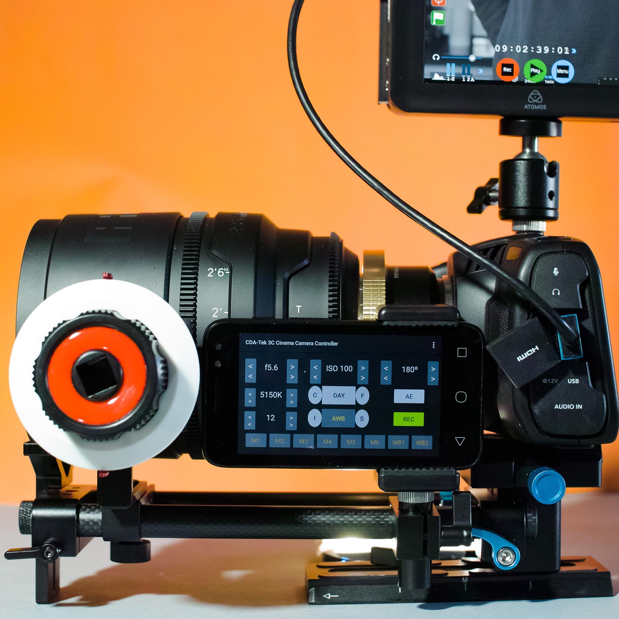

Super Members BTM_Pix Posted February 2, 2019 Super Members Share Posted February 2, 2019 28 minutes ago, zerocool22 said: It is quite high though, is that adjustable? As when im run and gunning, id like to rest the camera on the floor or table. But this will surely tip over. No, the adjustment is just in the rails part so that you can re-adjust the height of the lens support. This is a similarish one on my BMP4K. With the tripod plate on the bottom, the lens support centre column forms another contact point so when you align it you can settle down on a surface like it is here. It all depends on the lenses you put on it but with something like this PL prime you obviously need that adjustment to get the camera up higher but with a longer tripod plate on the base it becomes stable enough to set down. zerocool22 and webrunner5 2 Link to comment Share on other sites More sharing options...
