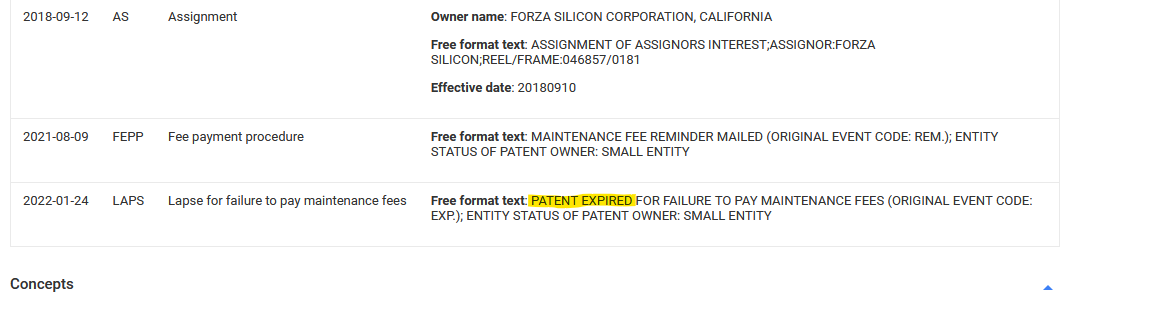

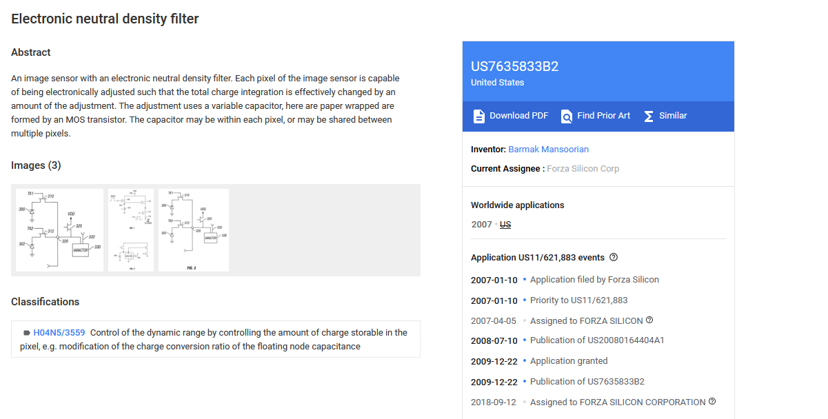

Sharathc47 Posted March 2, 2022 Share Posted March 2, 2022 Patent of electronic nd filter is expired in january 2022 (patent holder- Forza silicon) Can we see more cinema cameras with electronic nd filter in the future?🤷♂️ kye 1 Link to comment Share on other sites More sharing options...
