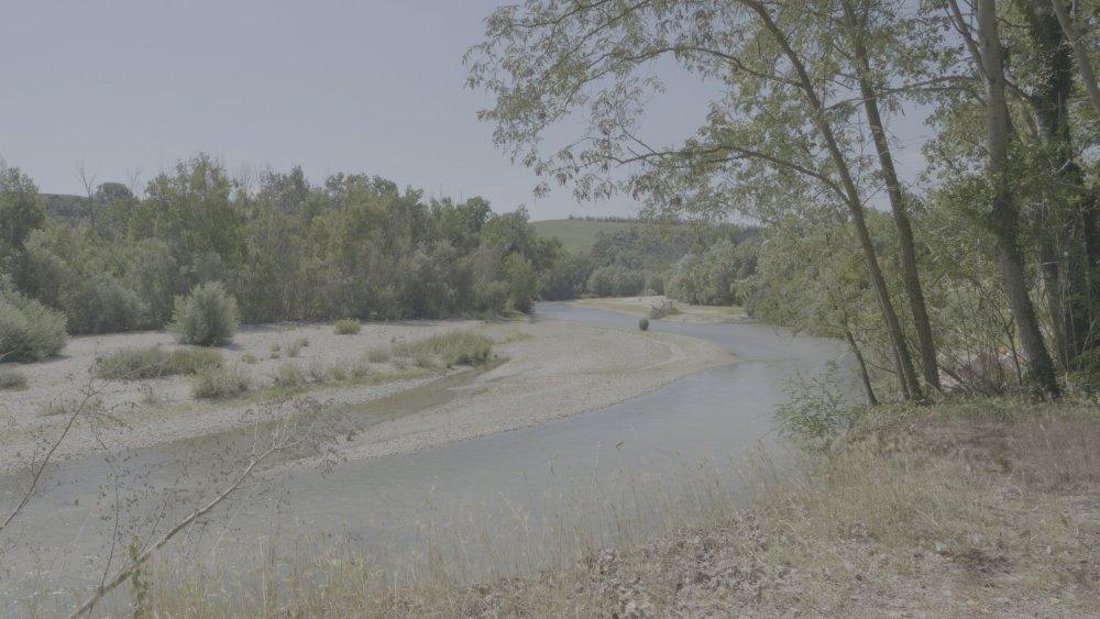

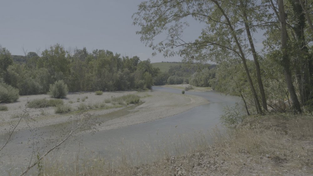

FoxAdriano Posted June 12, 2022 Share Posted June 12, 2022 I think, I hope it is better if I send you the clip: https://www.dropbox.com/s/67bny6beslc0477/P1012783.MOV?dl=0 You will hear my voice in the clip / test. The clip was exposed at f13 with +2 overexposure. Link to comment Share on other sites More sharing options...

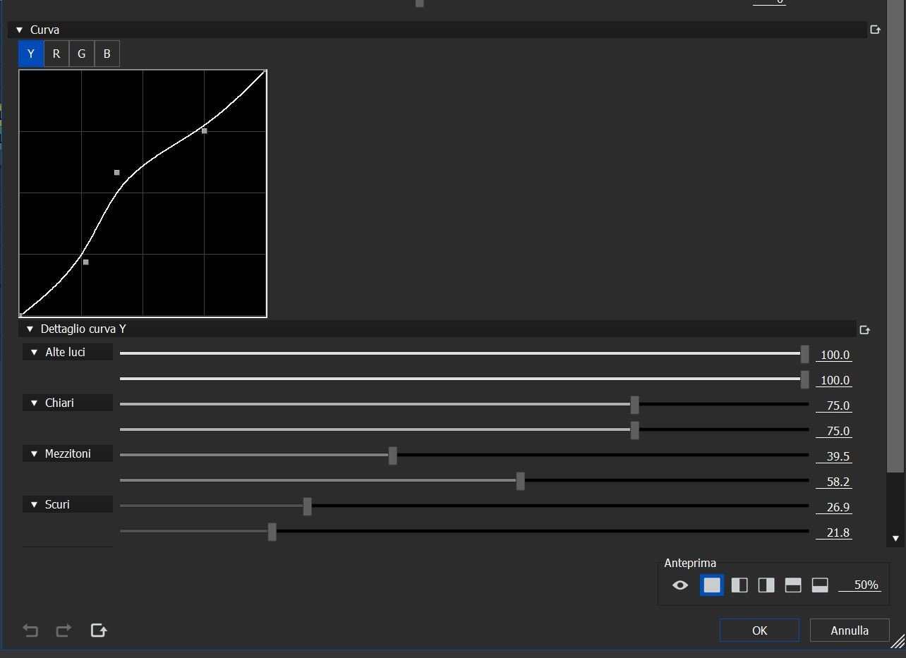

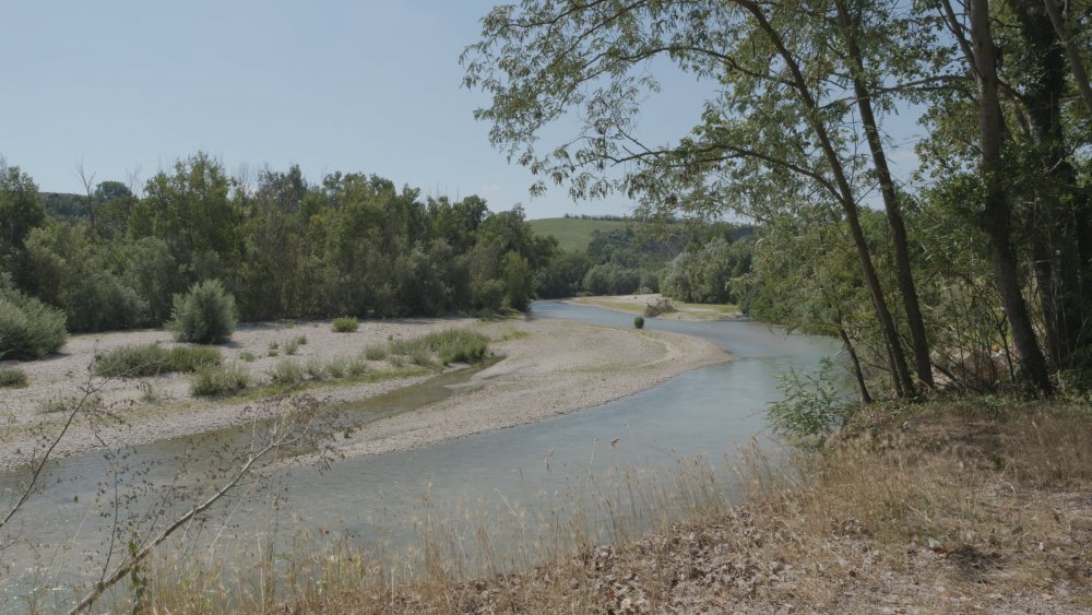

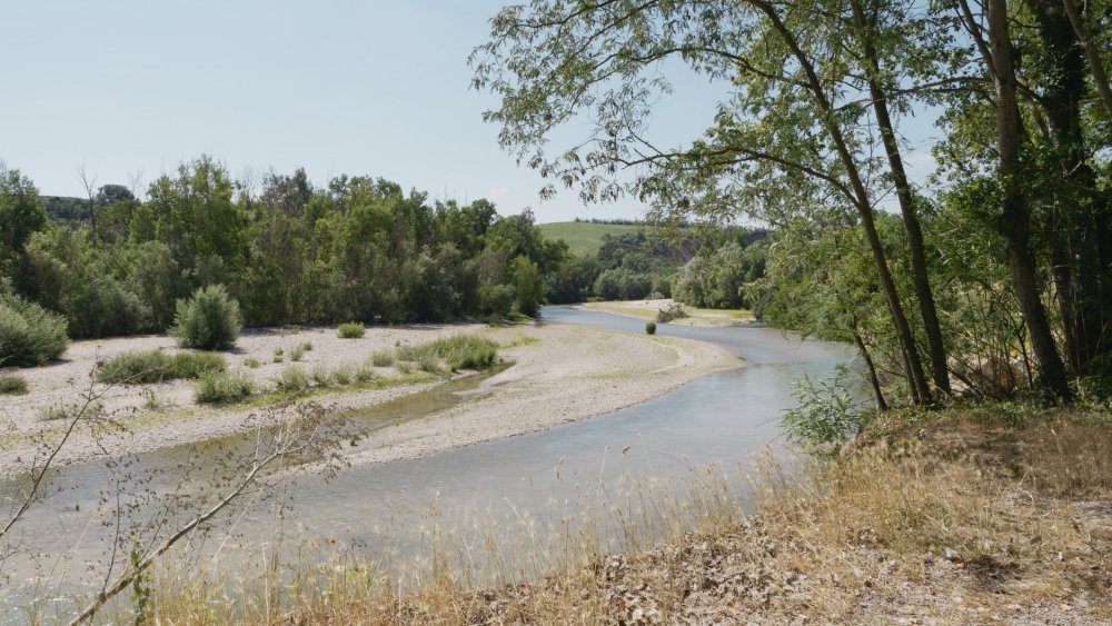

FoxAdriano Posted June 13, 2022 Share Posted June 13, 2022 I apologize if I ask you so many questions but I would like to understand well. Today I did many tests without overexposing anything, I left the exposure bar at "0". I shot with the 3top ND filter, in 4K, 50p, 1/100, 2.2.2. But when I went to put the clips on the editing software timeline, I had to turn up the curve to lighten the clip images (I think it is too much). I had to do it for all the clips. Is this normal or am I getting some problem with the GH6? Link to comment Share on other sites More sharing options...

hyalinejim Posted June 13, 2022 Share Posted June 13, 2022 9 hours ago, FoxAdriano said: I had to turn up the curve to lighten the clip As mentioned, my opinion is that the Panasonic lut is slightly too dark. Aside from this the issue of "perfect" exposure is complex. None of it matters if you can get the results that you're looking for. It's normal to brighten or darken clips in post. I'd imagine that the only people who are trying to get extremely accurate exposures in-camera are those shooting slide film. webrunner5 1 Link to comment Share on other sites More sharing options...
