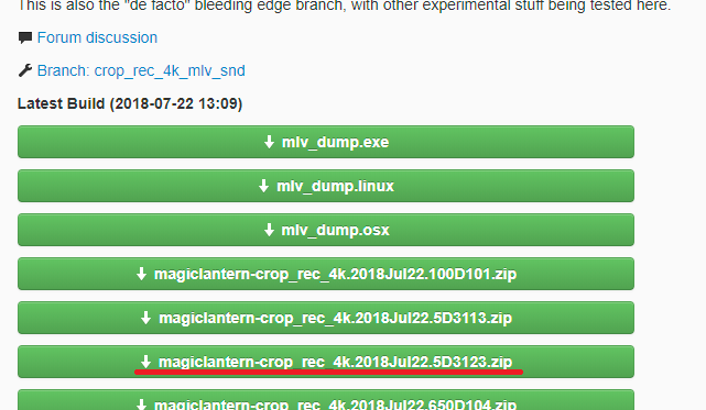

kaylee Posted February 8, 2019 Share Posted February 8, 2019 guys, im running the 10/12/16 nightly build, i dont see the crop movie recording option, can i add it somehow? pls talk to me like im 4 years old Quote Link to comment Share on other sites More sharing options...
heart0less Posted February 8, 2019 Share Posted February 8, 2019 You have to download crop_rec from here: https://builds.magiclantern.fm/experiments.html Then just unzip it and copy to your CF card. It's a different build, so format the CF card in camera (important! don't do this on your PC/Mac) beforehand. kaylee 1 Quote Link to comment Share on other sites More sharing options...
kaylee Posted February 8, 2019 Author Share Posted February 8, 2019 thank you @heart0less!! i dowloaded and unzipped. when you say format the card in camera, that means im completely reinstalling magic lantern? or do i drop it in an existing ML folder on the memory card? Quote Link to comment Share on other sites More sharing options...
heart0less Posted February 8, 2019 Share Posted February 8, 2019 3 minutes ago, kaylee said: when you say format the card in camera, that means im completely reinstalling magic lantern? or do i drop it in an existing ML folder on the memory card? Yup, you have to reinstall it completely. Like I said, format the card in camera and after it's done, copy the unzipped files onto the fresh and empty CF card you just took out of your 5D3. Good luck! Quote Link to comment Share on other sites More sharing options...
Nikkor Posted February 8, 2019 Share Posted February 8, 2019 5 minutes ago, kaylee said: thank you @heart0less!! i dowloaded and unzipped. when you say format the card in camera, that means im completely reinstalling magic lantern? or do i drop it in an existing ML folder on the memory card? Drop the existing folders. Then you have to load the module, once you have it loaded (maybe restart camera) it will appear in the movie menu (magic lantern menu) -edit- I never format and reflash the camera, I just copy the new files and replace the stuff on the card, am I doing it wrong? kaylee 1 Quote Link to comment Share on other sites More sharing options...
kaylee Posted February 8, 2019 Author Share Posted February 8, 2019 ohh ok, so im doing a clean install of ML? ? i get it my bad so, wipe the memory card in camera, install the above package, correct? Quote Link to comment Share on other sites More sharing options...
heart0less Posted February 8, 2019 Share Posted February 8, 2019 3 minutes ago, Nikkor said: -edit- I never format and reflash the camera, I just copy the new files and replace the stuff on the card, am I doing it wrong? I'm not sure. If it works for you, then I guess it's okay. ( : I just read that some dev suggested doing a clean install to avoid conflicting files. edit: @kaylee, correct! kaylee 1 Quote Link to comment Share on other sites More sharing options...
mercer Posted February 8, 2019 Share Posted February 8, 2019 52 minutes ago, kaylee said: guys, im running the 10/12/16 nightly build, i dont see the crop movie recording option, can i add it somehow? pls talk to me like im 4 years old Do you just want the regular crop or are you looking to test the experimental 3.5K modes? Quote Link to comment Share on other sites More sharing options...
kaylee Posted February 8, 2019 Author Share Posted February 8, 2019 @mercer regular crop is fine for now... trynna learn how it works ? have you gotten into the higher k modes? Quote Link to comment Share on other sites More sharing options...
mercer Posted February 8, 2019 Share Posted February 8, 2019 Well regular crop just requires you to load the module that is already in the firmware on your camera. In the menu scroll all the way to the right where the module tab is and then click to load crop mode. When you restart your camera it will be loaded, then you just use the magnify button on the camera. I tried the experimental build but couldn’t figure it out. I had something set up wrong but not enough time to eff around with it, so I went back to the normal nightly build. Quote Link to comment Share on other sites More sharing options...
kaylee Posted February 9, 2019 Author Share Posted February 9, 2019 dammit, i have firmware 1.1.3 on my 5d3, should i have 1.2.3? ? Quote Link to comment Share on other sites More sharing options...
mercer Posted February 9, 2019 Share Posted February 9, 2019 1.13 is fine. Do you still have ML installed on your camera? Quote Link to comment Share on other sites More sharing options...
kaylee Posted February 9, 2019 Author Share Posted February 9, 2019 ok! i used the 1.1.3 version from here and it looks like things are working. @mercer should i be using the mlv_rec Raw video v2.0 (MLV) option? i havent done mlv before but i wanna start, im not seeing the raw_rec option? sorry im so dumb jeez ? UPDATE: oooo omg im doing it!! mlv app is awesome why didnt i do this sooner ? mercer, what are your fav mlv app settings/etc?? heart0less 1 Quote Link to comment Share on other sites More sharing options...
