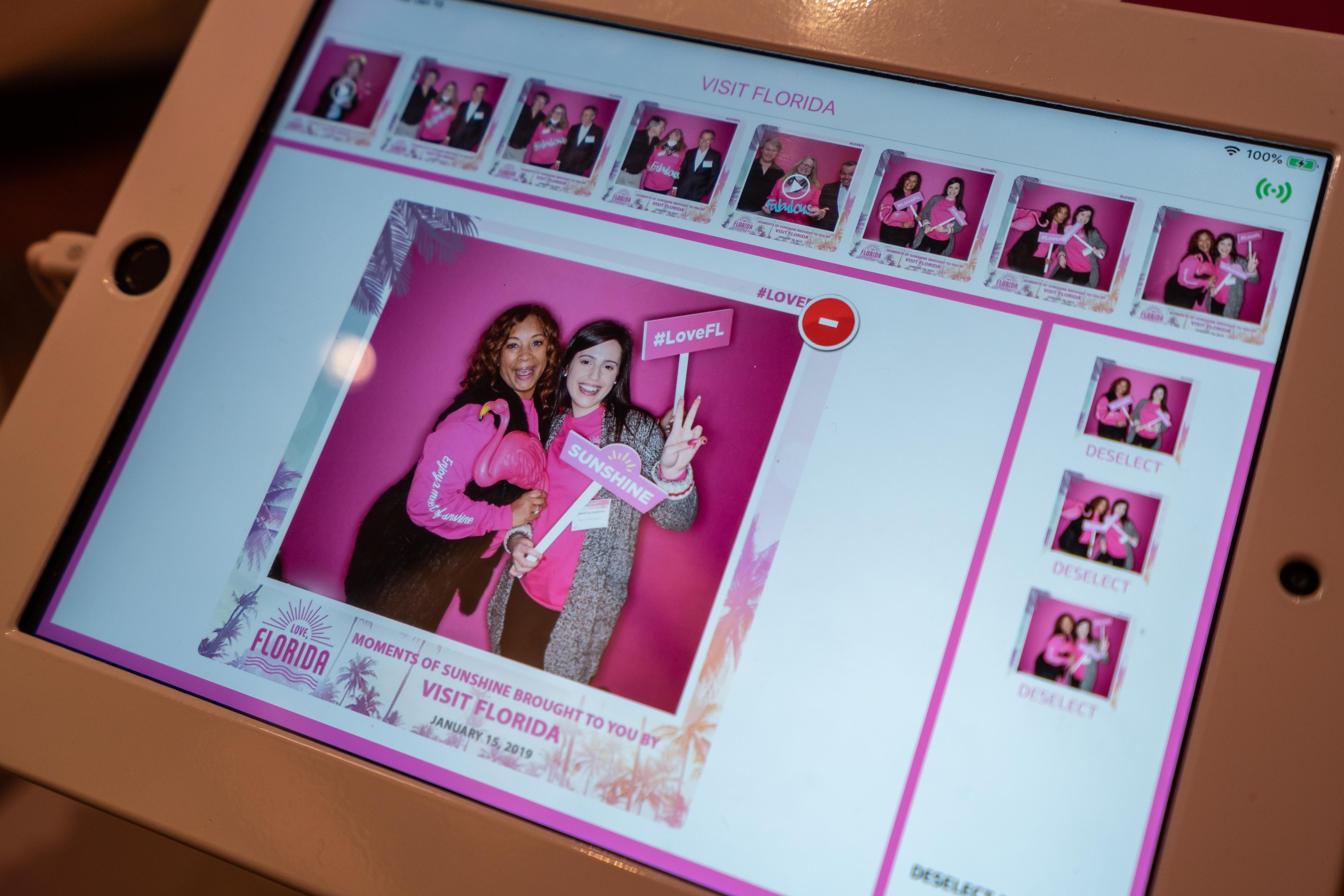

Trek of Joy Posted February 16, 2019 Share Posted February 16, 2019 The video from Matthew Staffords wedding looks like it was shot on a Red. I was at an event where they did this with an iPhone taking with a simple setup of a small fluorescent key/fill/hair light. They shot stills, boomerangs and recorded goofy slow mo stuff, sending it to an iPad through an app (don't know what the app was called, but guests were able to email the video to themselves), and broadcast with an Apple tv mirroring the iPad. In good light the iPhone 120fps looks good, and its fine for social. If you didn't have the app, someone could just shoot the video on a phone and airdrop it to an iPad or MacBook for a quick edit, and then it can be emailed or airdropped to other iPhones. I've attached a shot of the iPad that was used for review and emailing images/videos. Wish I could help with specifics, but a combo of iphone/ipad would be my solution. A ILC presents a lot of headaches in terms of file transfer, file size, edit/render speed and so on. I have the iPhone XS and XS Max (one is supplied by a company I work for, I'm not a two phone dink by choice) and the iPad Pro. I think it would be easy to pull off what you're looking for with my little setup with two people - a shooter and a editor to make quick clips and send them to guests. Five seconds of slow-mo video of someone dancing or throwing crap in the air could easily be edited in iMovie and emailed in less than a minute. Everything you need including lights and stands can probably be carried in one large bag/case. The days of the DSLR based photo booth are numbered, there's no reason to lug all that around for small instant prints or social when phones and a few lights will get you virtually identical quality. And you can probably charge a lot for the service. Hmmmm... Chris TurboRat and lissa 2 Link to comment Share on other sites More sharing options...
