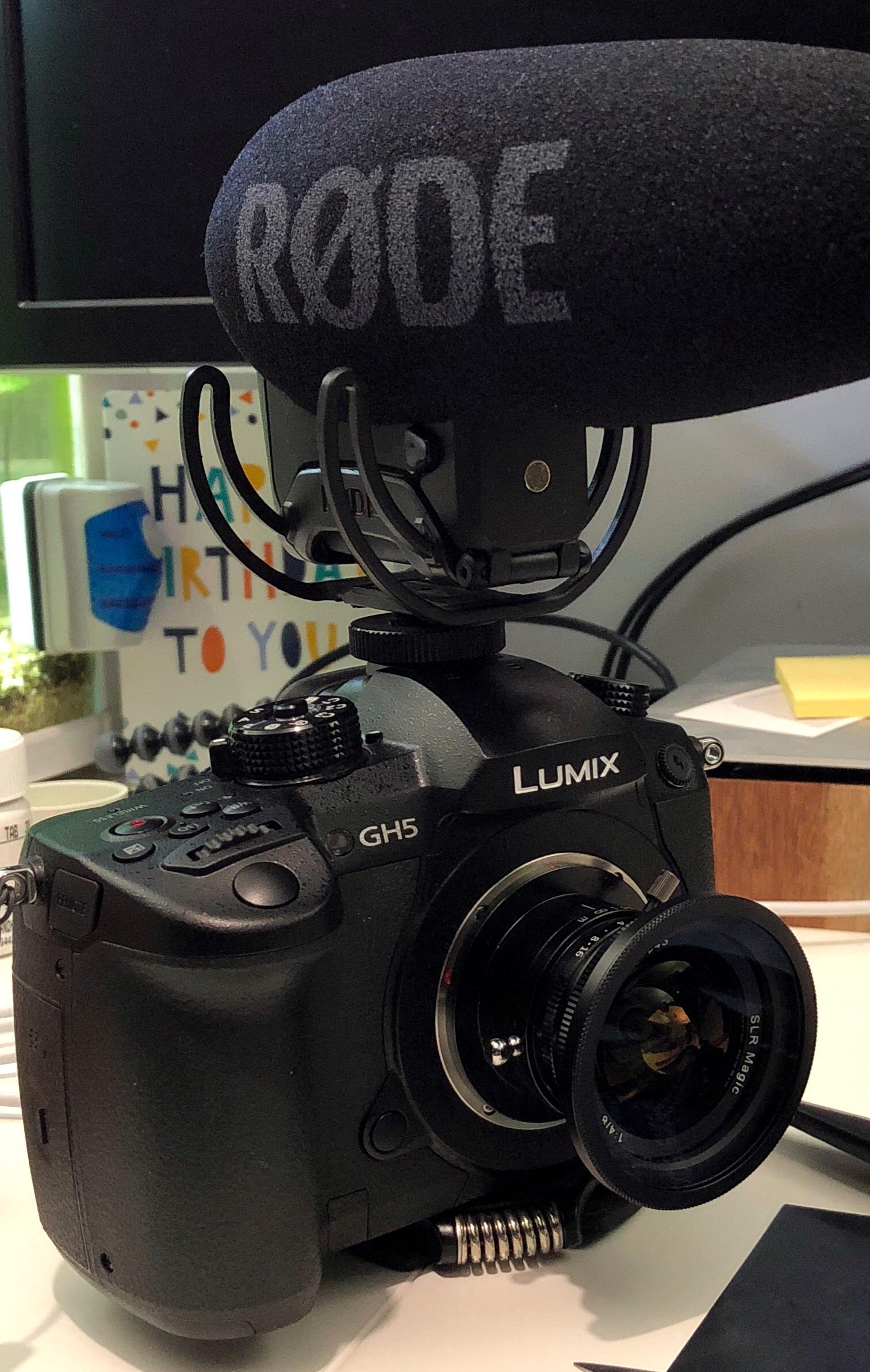

thebrothersthre3 Posted February 24, 2019 Share Posted February 24, 2019 27 minutes ago, kye said: Here's a pic to get you fired up.. SLR Magic 8mm on GH5: and if that tickles you then you'll absolutely love this one.. Lomo 40mm on GH5 via an adapter and mounted in a hole cut in the body cap (it was a fixed lens with proprietary mounting thread so no adapters available): Man that SLR magic is tiny. Mounting the lens via bodycap was a great idea, love the ingenuity. Alt Shoo and kye 1 1 Link to comment Share on other sites More sharing options...

IronFilm Posted February 25, 2019 Share Posted February 25, 2019 On 2/24/2019 at 3:31 PM, kye said: Here's a pic to get you fired up.. SLR Magic 8mm on GH5: That is my normal set up for my YouTube channel. Except with a G6 and not a GH5 ? kye 1 Link to comment Share on other sites More sharing options...
