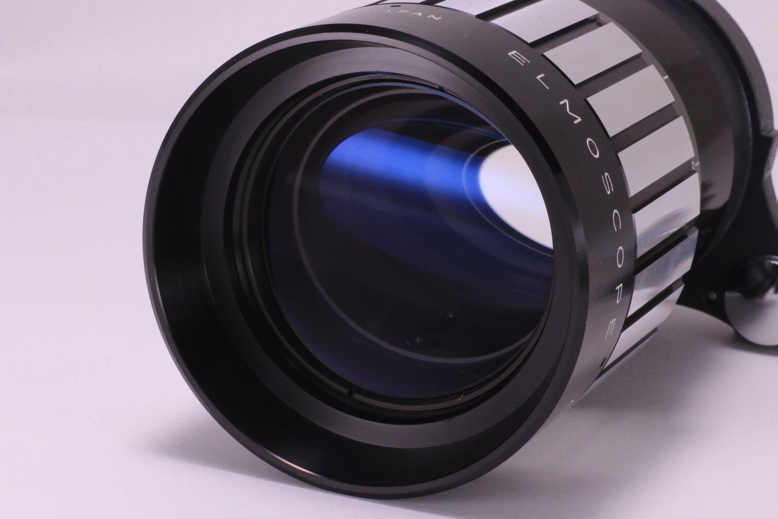

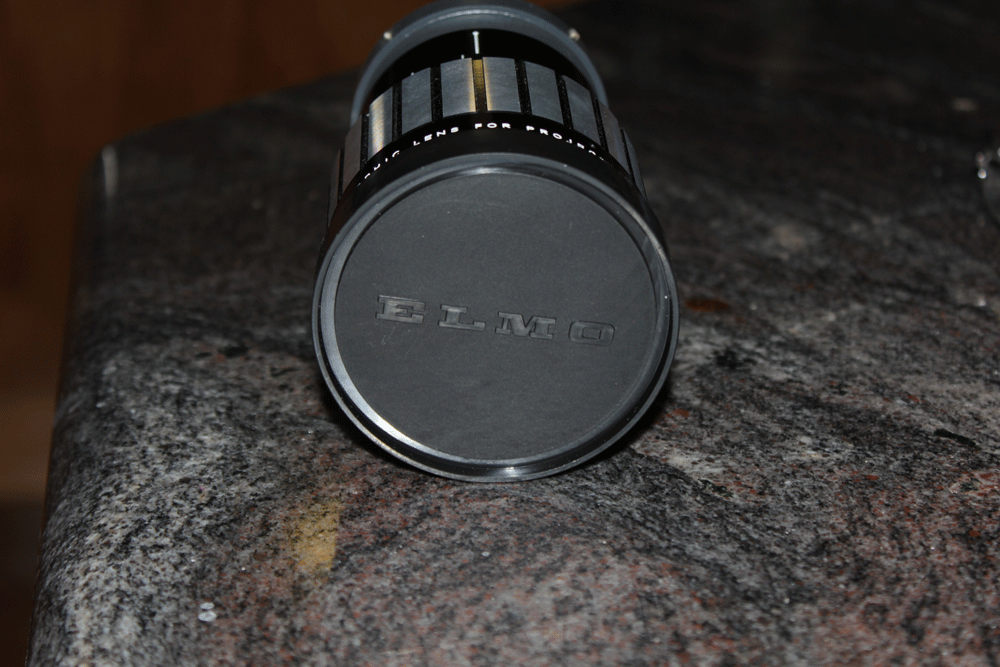

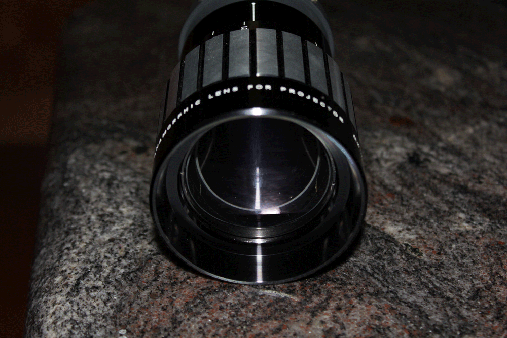

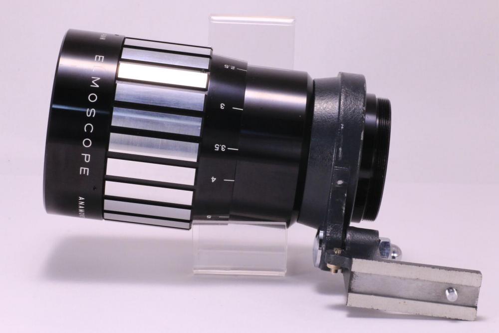

leslie Posted March 1, 2019 Share Posted March 1, 2019 ok i kinda weakened last night... found a type1 elmoscope it had an hour to go glass looks clean here's two pics. there's abit of talk on the forum about the type 2 being better or the one to get. so i'm curious as to why that is ? i couldn't find any real comparisons between the type one or two, lots of reviews comparing the type 2 to other anamorphics but not much talk comparing the two elmoscopes. i couldn't seem to find anything negative about the type 1 only that the type 2 is better liked. the title description lists it as Excellent ELMOSCOPE Anamorphic Projector 16mm 8mm Vintage Camera Projection Lens. so i figure it should be ok on mft when the bmp4k eventually turns up . i did find one review who had it mounted to a 5d so i'm thinking i'm safe in that regard. more pics to come when it arrives. opinions ? Link to comment Share on other sites More sharing options...
tweak Posted March 1, 2019 Share Posted March 1, 2019 The ii can shoot wider. This is closer to a sankor or Kowa 16D. Should still be a nice scope. Link to comment Share on other sites More sharing options...
Tito Ferradans Posted March 1, 2019 Share Posted March 1, 2019 4 hours ago, tweak said: The ii can shoot wider. This is closer to a sankor or Kowa 16D. Should still be a nice scope. what tweak said. More like a Sankor 16-D, since the Kowa 16-D is tiny. tweak 1 Link to comment Share on other sites More sharing options...
Bioskop.Inc Posted March 1, 2019 Share Posted March 1, 2019 Yeah, it's a nice lens & as Tito said is basically identical to the Sankor 16D (some say its a rebranded Sankor), not the Kowa! It is exactly the same width at the back as the Version 2 & has blue flares (I think some don't, but the one I had did). The Elmoscope 2 is basically the same as a Kowa for B&H etc. They're cheap & good - not as small as you might think, but not massive. http://super8wiki.com/index.php/Anamorphic_Lenses#2x_Anamorphic_attachments Link to comment Share on other sites More sharing options...

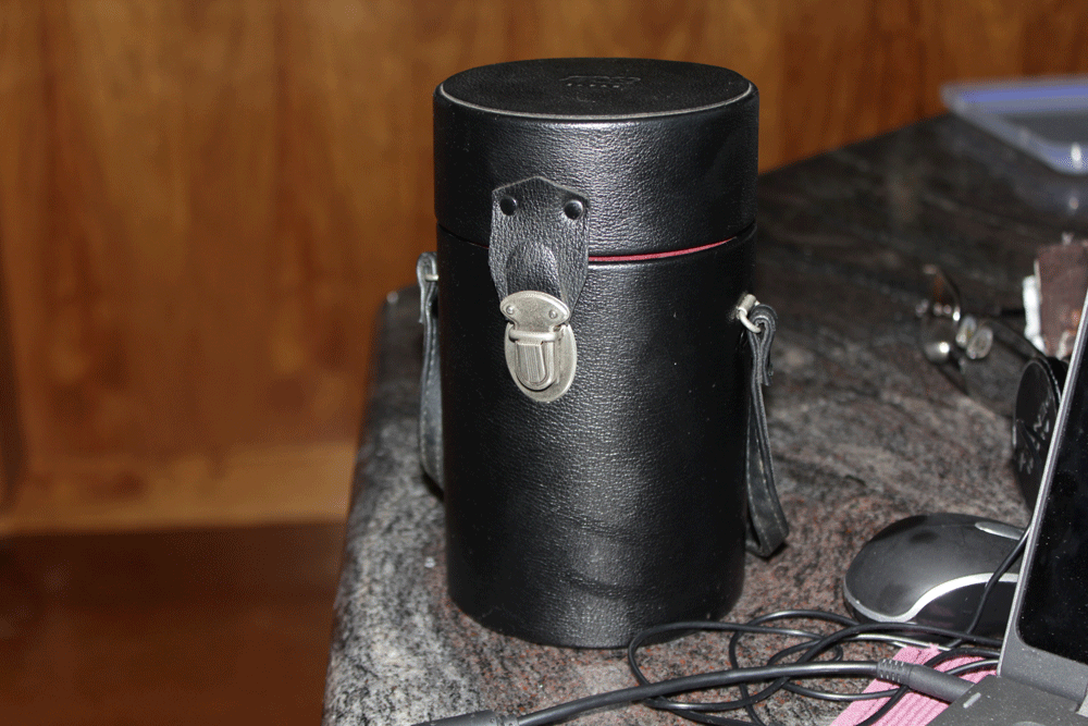

leslie Posted March 12, 2019 Author Share Posted March 12, 2019 ok the lens arrived early, looks immaculate very smooth action, i am very happy. just have to sort a clamp out now. it came with a case that looks brand new apart from the the holder there's barely a mark on it Tito Ferradans, webrunner5 and heart0less 3 Link to comment Share on other sites More sharing options...

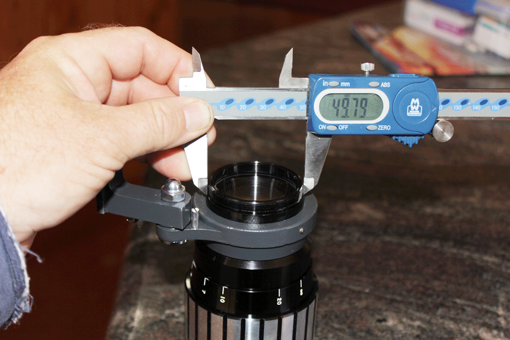

leslie Posted March 13, 2019 Author Share Posted March 13, 2019 hmm it seems the back thread is an unusual size.here is a photo, i think i should be looking for a 50mm thread. ebay lists 49mm or 52 mm but no 50 mm so i'm kinda looking at this clamp which has the convenient 52mm thread size https://www.ebay.com.au/itm/ANAMORPHIC-LENS-CLAMP-KIT-KOWA-SANKOR-SINGER-ISCO/291040851278?hash=item43c362f54e:g:f1sAAOSwXeJYGhpm am i on the right track ? Link to comment Share on other sites More sharing options...
heart0less Posted March 13, 2019 Share Posted March 13, 2019 Many people say that vidatlantic's clamps aren't that good. They can damage your scope pretty easily and leave screw marks on the barrel. To be honest, I'd go with some manufactured clamp, especially since your back thread isn't standard size. You could try asking RafCamera (Russia) or Arkadiusz Kroma (Poland) - both of them offer the best quality/price ratio - or just go all in and contact Redstan (UK), whose clamps are simply a work of art. Link to comment Share on other sites More sharing options...
Bioskop.Inc Posted March 13, 2019 Share Posted March 13, 2019 you'll need a special clamp - Redstan makes the best Link to comment Share on other sites More sharing options...
leslie Posted March 14, 2019 Author Share Posted March 14, 2019 ok contacted redstan waiting to hear back Link to comment Share on other sites More sharing options...

leslie Posted October 18, 2019 Author Share Posted October 18, 2019 10 hours ago, Mizzle said: Hi Leslie. Just wondering what your solution was in the end and what clamp you went with as I am having difficulty finding exactly what I need. Thanks in advance i didn't hear back. not sure whether my email got lost or what, i was kinda impatient after a couple of weeks, i ended up getting a local machinist to turn something up. However it would have been cheaper buying redstan. from what i remember the back thread size is metric 49 mm Some what related... bizarrely i seem to find double focusing easier on the canon 60d than the p4k. i have no logical explanation for why that is either. I do have ml installed on the canon but the 60d doesn't really get me the resolutions or clip length i would like. I'm undecided on getting a fvd or a better model canon to run ml and raw on i do have an active thread called bmp4k adventures there maybe more info or pictures on the anamorphic set up there Link to comment Share on other sites More sharing options...
Justin Bacle Posted October 19, 2019 Share Posted October 19, 2019 I use one myselft, the back thread is exactly similar to Sankor 16D. So any clamp for Sankor 16D is good Burnhard 1 Link to comment Share on other sites More sharing options...
leslie Posted October 21, 2019 Author Share Posted October 21, 2019 er... i was wrong, Its actually 50mm metric, Any lens clamp with a bigger than 50mm hole would fit. Sorry about that was just looking at the elmoscope and thought i should recheck that as 49mm is a standard size. Link to comment Share on other sites More sharing options...
